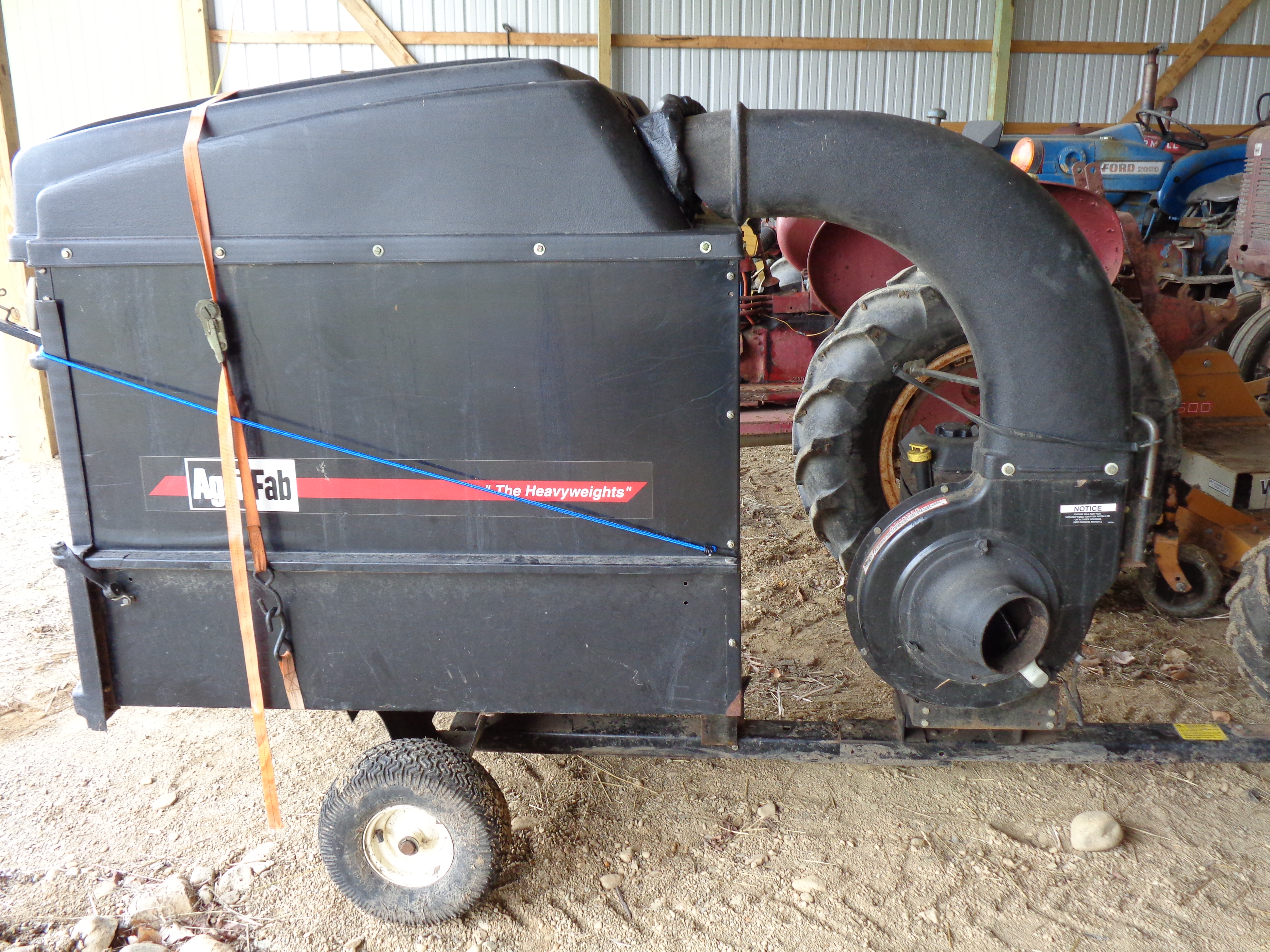

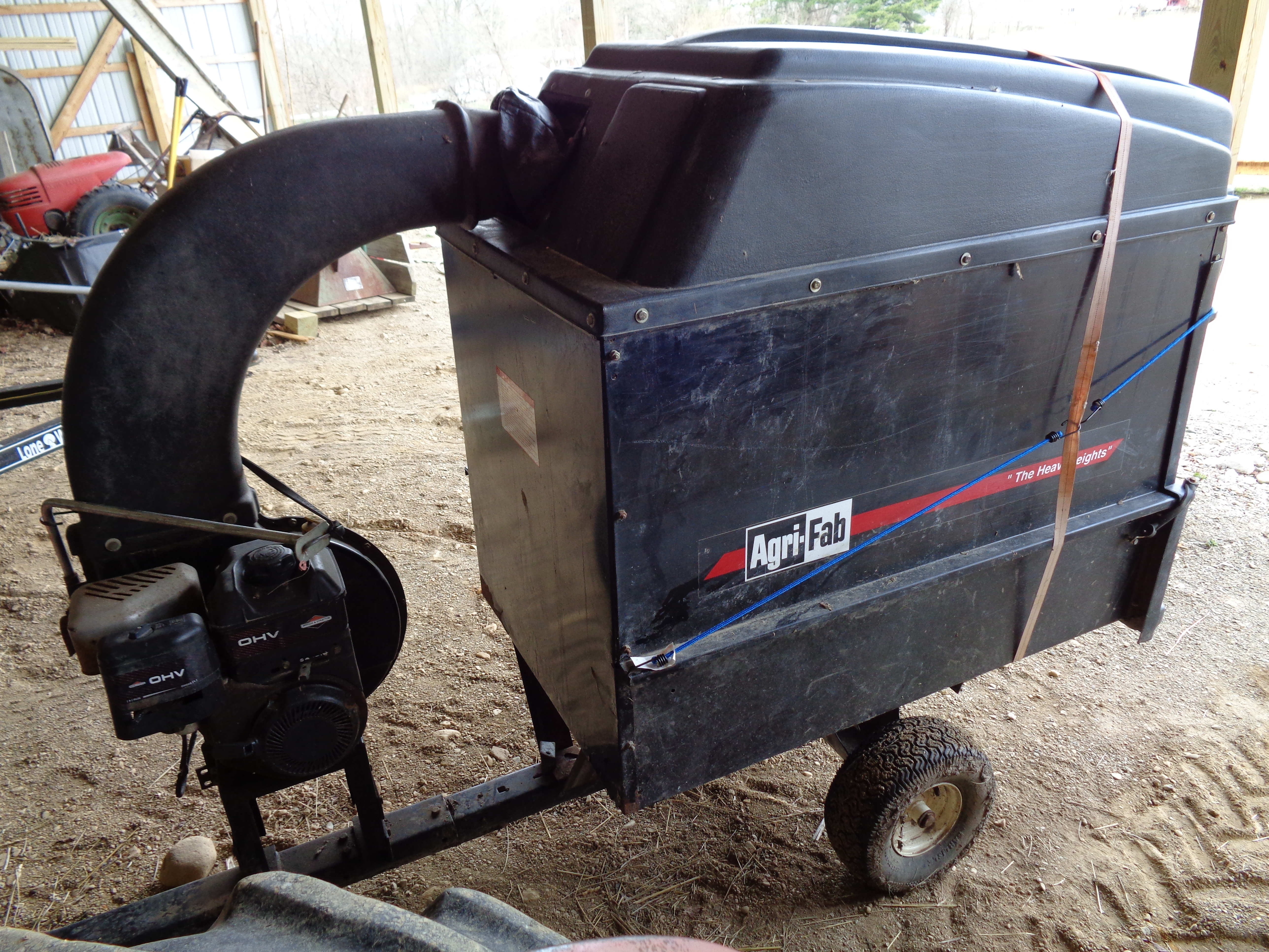

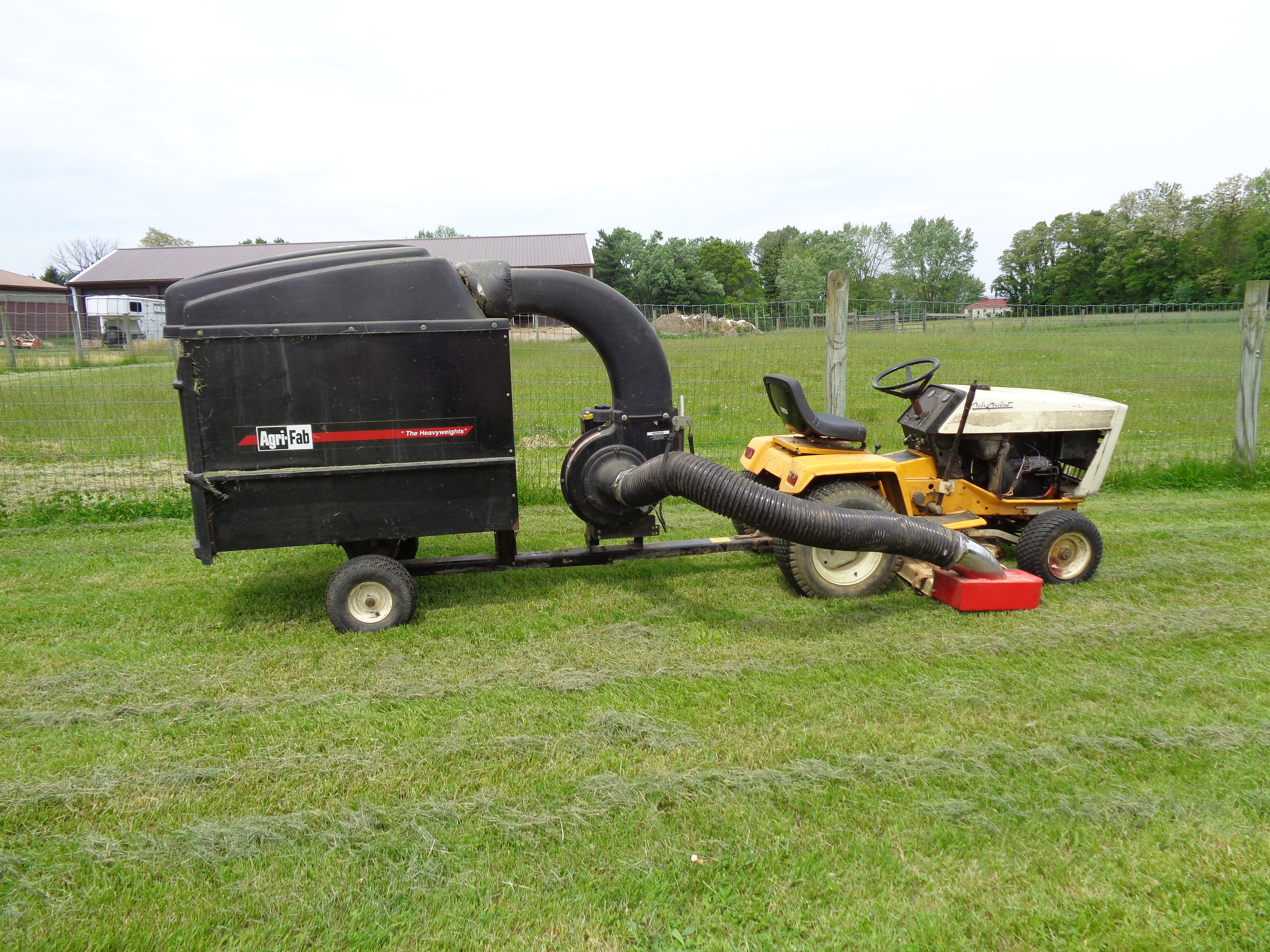

If you have any local Spring consignment auctions around, I'd suggest going and look for one of these. I bought this one, complete with universal boot for the deck for $140. Brought it home, checked the oil, put some gas in it, and it started and ran on the second pull.
With that being said, due to my not removing the engine shroud until after the fact, the Intek Briggs engine only lasted the first round of vacuuming up grass from the lawn, which I use for mulch around plants in the garden. A mouse had built a nest next to the cylinder jug. I'm assuming the heat build up caused a piston ring to break, gouging the cylinder wall, ruining the engine. As luck would have it, a buddy had a chipper/shredder he bought for cheap to use the L-head Briggs re-power a garden tractor. It also had the MTD tapered shaft, like this Mow & Vac. I gave him the $20 he'd paid for the barely used engine, and had it switched out in about an hour. I did pull the shroud on this engine, to make sure there were no debris underneath. Used it all last summer to pickup grass, then my leaves in the Fall, plus 3 of the neighbors yards, to "harvest" the leaves, also for mulch for the garden, and it never missed a beat. I also bought an old Cub Cadet w/deck for $200, that needed some TLC. Ended up with less than $300 in it, to use with the Mow & Vac as a dedicated unit. She's not pretty, but works great..!!
