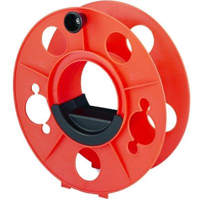

I've gone to these for economy, simplicity, and reliability.

Bruce- Those reels work great on my 16/3 cords.
Kenny- I have 60' of 12/3 cord.
Rick- I do not need a retracting reel. I wish that I had a need for one :(.
My intended use is for better cord management and the ability to take the cord to my tractor for the preheaters.

All of mine (5-6 or so) have 12/3 cords on them. I just added another a few days ago. 50ft 12/3 still a little kinky from the oval packaging. No problem. Some have 80ft 12/3, which fills it to the rim.

Ok, then I agree with the reels Bruce uses for your application.
I’ve got a couple of those too.

I've got a couple of these, but also like the old fashioned elongated H style, and have also a couple of these Buy Cord Reels - Free Shipping over $5� | Zoro.com Z06K0_fo5oy.JPG that I actually like better than the orange one above. It just seems a little sturdier for heavy cords. But, I've got one 14/3 50' that is about 50 years old, still in great shape, but it the size of a garden hose in diameter, so it's not gonna role up on any of those! Heavy as #3!!, but sentimental as it was one my daddy bought for a project we did together when I was a young lad, can't let it go!

I need to go down to the "Big City" later today. I intend to buy the reel model or its equivalent. It use to be on a real like that until I ran over it. I saw a method of "velcroing" the cord ends to the outside of the reel rim which is really a decent, simple solution to flailing ends.
Thanks for the recommendations.
I just use a piece of wire, Cat 5 in this case.
These reels are great, I plug in the cord and pay it out. Many times most of the cord is still on the reel.

I have one of the orange reels but find that the flopping cord end is a PIA. Velcroing it might work. I do find that just wrapping the cord around my hand/elbow works fast and makes a tight bundle. For longer cords, I simply gather up an arm length per wrap and then hang it on a long nail. I have a couple of cord handcuffs that work great to hold everything together but I haven't seen them in many years at any local store. While the reels seem like a good idea, they just aren't too great for my uses. Those H shaped ones would be my least favorite way to wrap up a cord, a real PIA to reel out, much worse than just arm wrapping the cords.

Wakey- That's a good idea for securing the end.
B. John- That's what I have been doing. Doing the "process" in the ice and snow is getting old.
Gary- That is one of my "issues" with these reels- the flopping ends. I saw a picture of one of these reels loaded with 12/3 with a couple of feet of cord from both ends wrapped around the outside of the reel and secured with velco straps. I could not doing that photo this AM, but it seems to be a practical solution to the flailing cord ends.

I don't know why you guys have flailing ends. That's what the holes in the side are for.
Stick one end through a large hole on the side away from the handle, then snap the last inch of the cord into the small hole. Wind up the rest and stick the end through a big hole and snap it into the small hole. Both ends should be on the side opposite the handle. If the reel is completely full, stick the end under a previous wrap or two.
