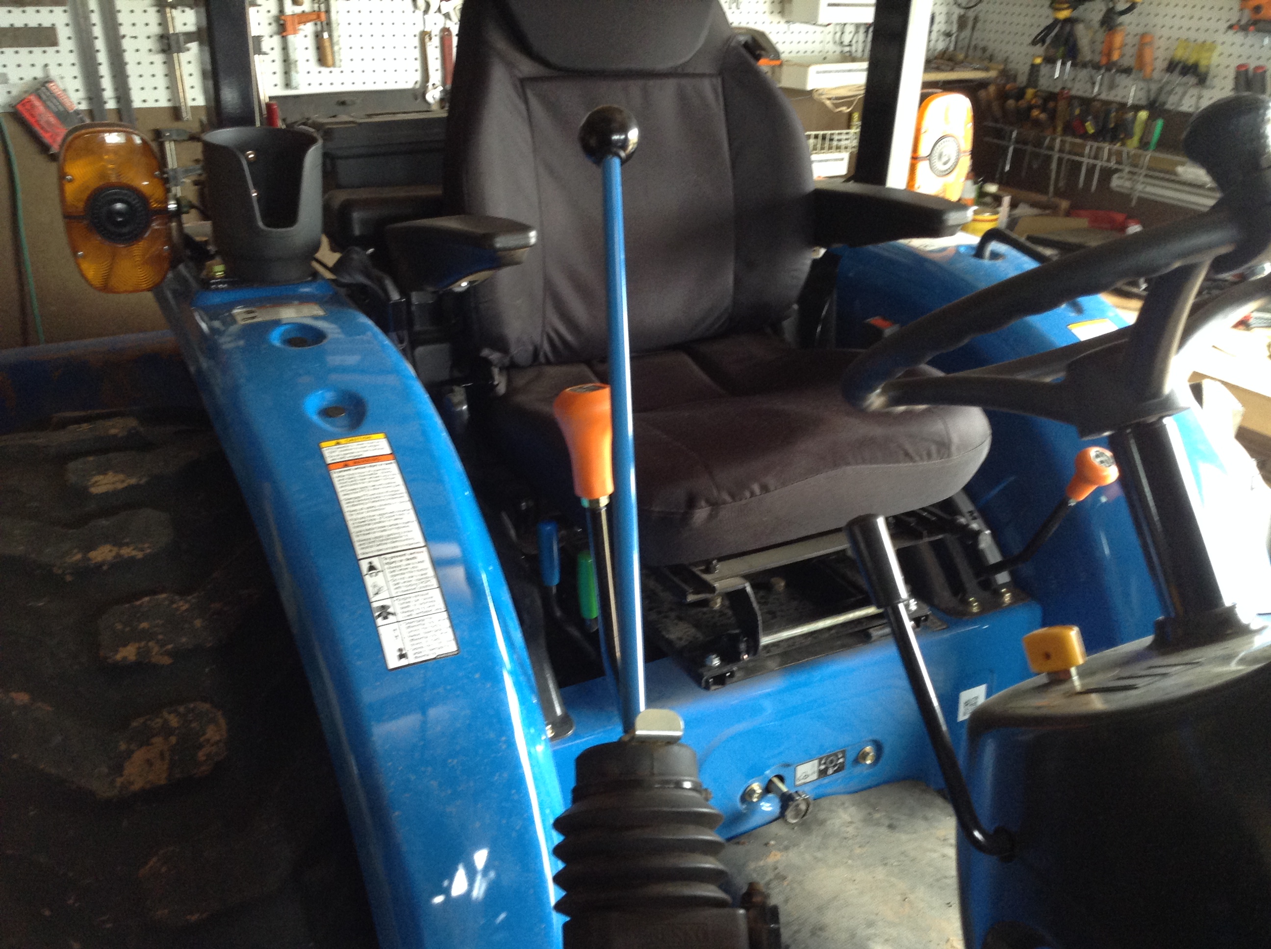

I was wondering if anyone has extended or replaced the loader control arm (rod w/ knob) and how / where you got the parts / replacement from. I have an XG3025 and find I really have to reach forward to operate the loader. Puts me in an uncomfortable position, plus makes those "fine movements" very difficult to make.
The rod just unscrews from the loader valve, and the knob unscrews from the other end....simple, but I can't find a straightforward longer replacement rod. Has anyone used a threaded coupling and "added" to the length? Anyone know the thread size?
I have adjusted the loader valve support arm up as far as it goes, and tilted the valve as far as it will go. Still places the knob about 6" too far away from my reach.
I suspect that I may have to get a steel rod and tap the threads myself, but I really don't have a good tap and die set, nor want to buy one for just this one purpose /job. Any suggestions, suppliers, or other ideas are welcome.
Thanks in advance.

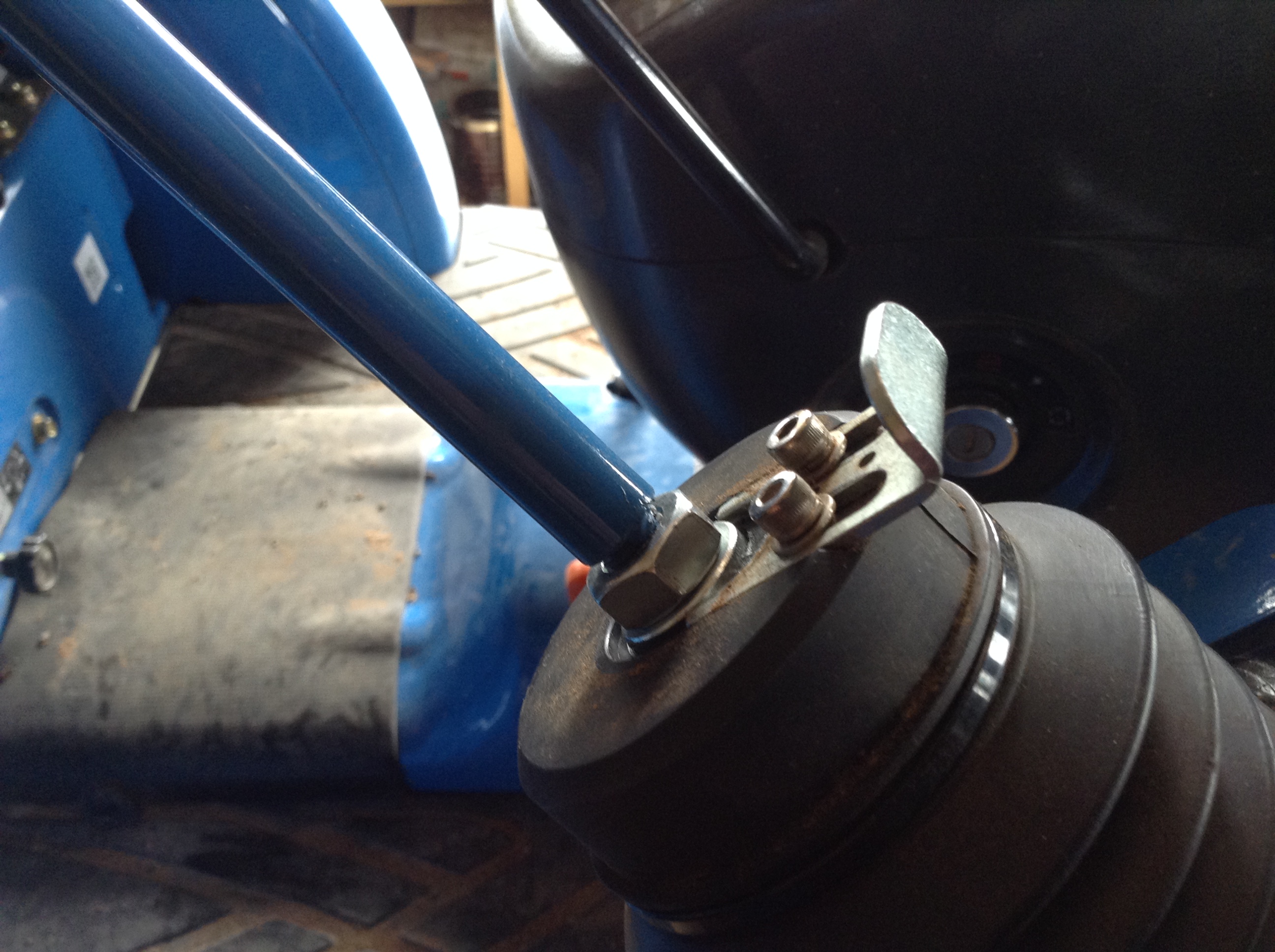

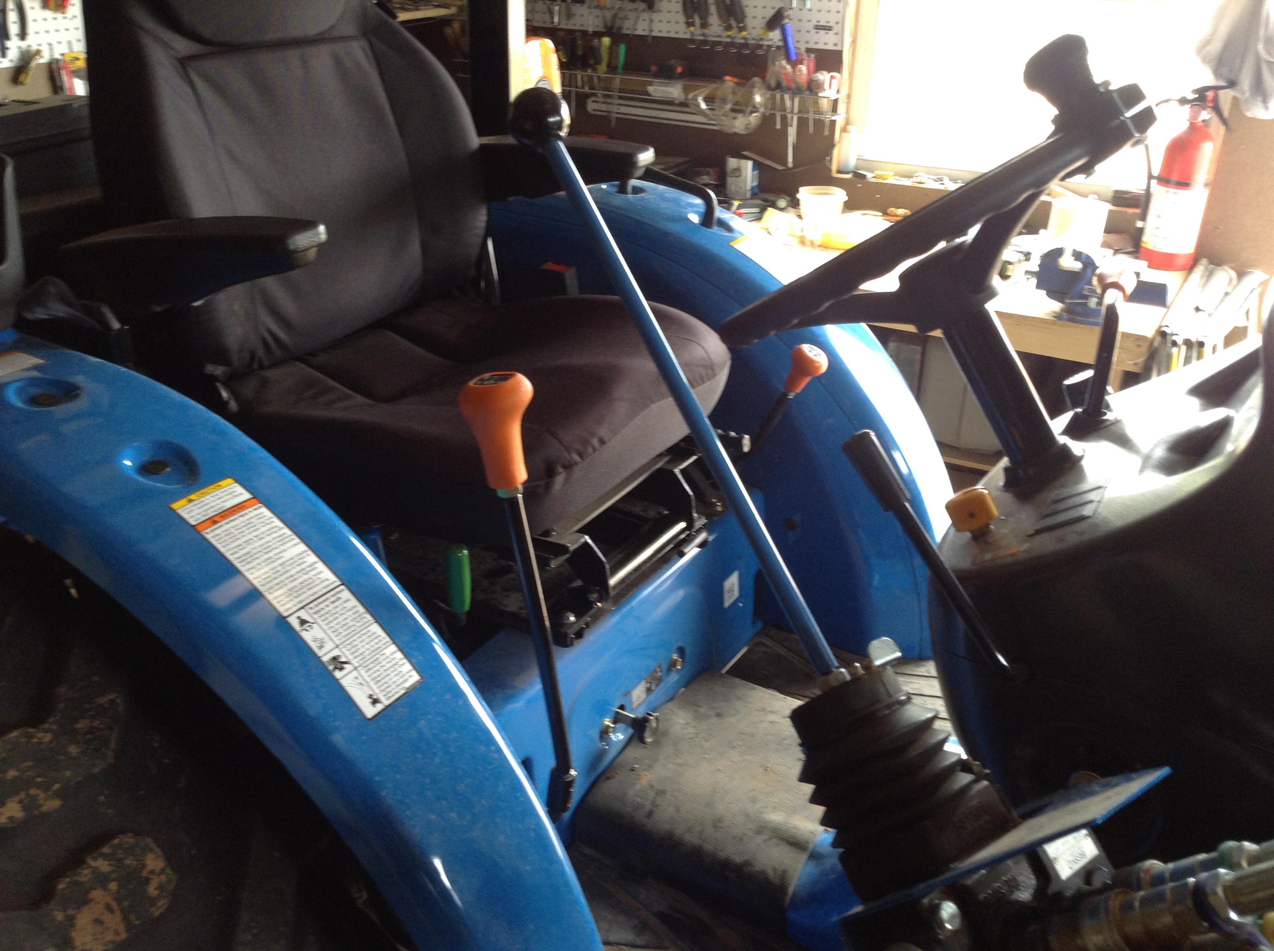

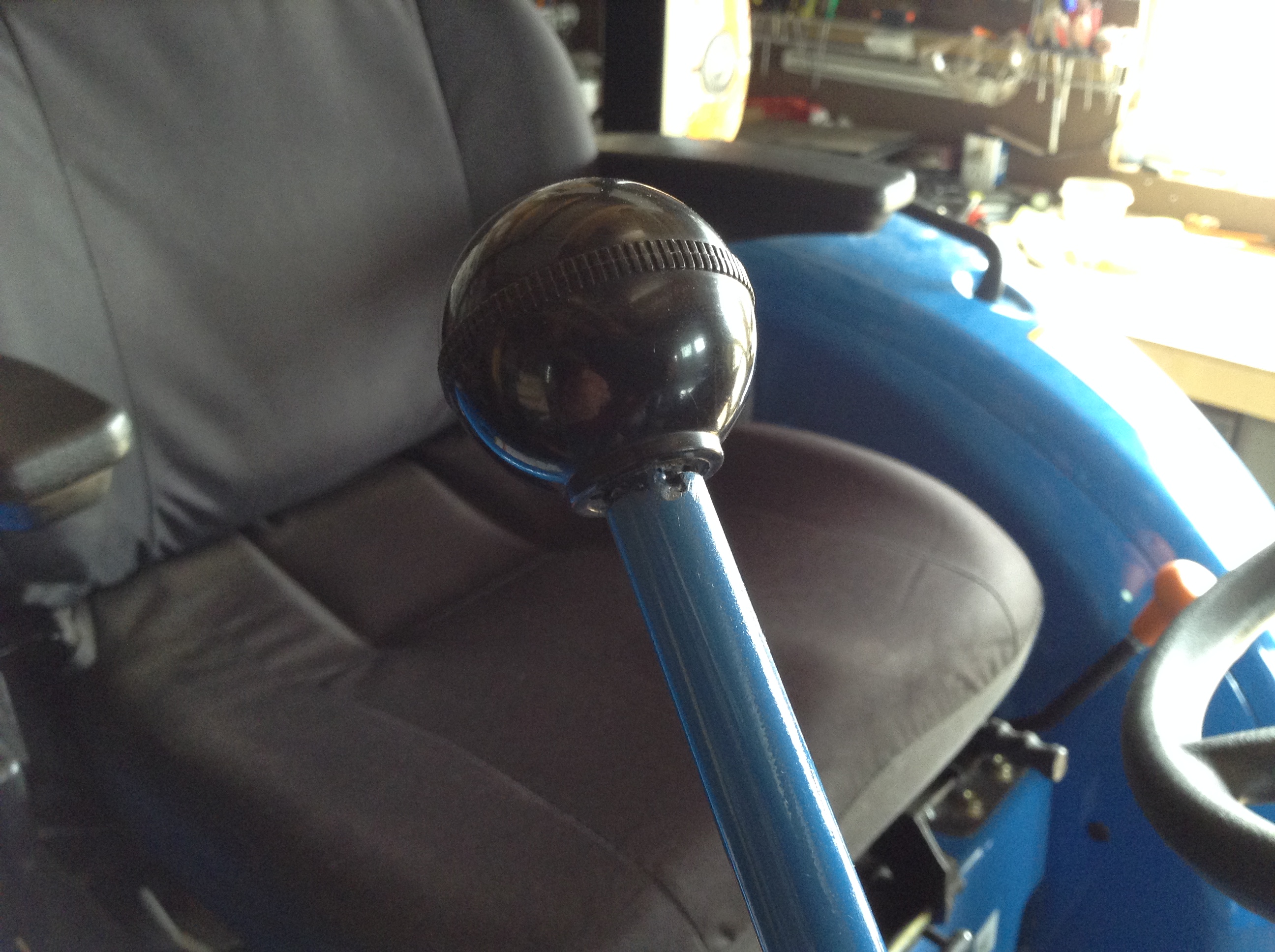

So here's an update... Went to TSC and got 2- 10x1.50 75mm bolts, and a 2' length of 1/2" steel tube. All cost <$10. Cut the heads off the bolts, drilled the tube's 3/8" IS diameter out to 25/32 (which was really easy), slipped the bolts in the ends, a couple of quick tacks with the welder.... Waa-Laaa! Longer control arm. Took me longer to wait for the paint to dry than make the thing!
Went from a 6" arm that I had to lean forward to reach, to a 12" that I can keep my elbow on the armrest of the seat. Much more stable control and my arm doesn't get tired!
