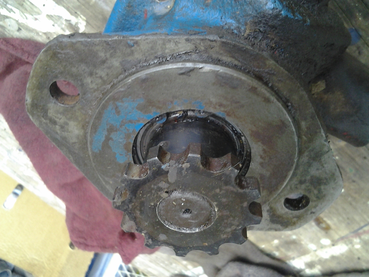

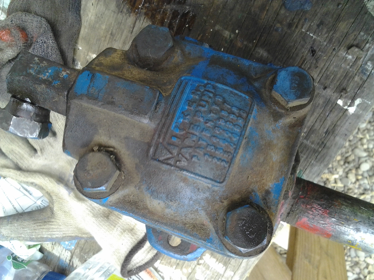

Does anyone know where I can get an exploded diagram for an old vicker hydraulic pump? It is off a shawnee loader that is mounted to my NAA. The pump drools a pretty good stream of fluid from around the shaft when it runs. The shaft appears to have a bearing behind a snap ring but I can't see much of a seal in there. I was just hoping to get picture of what is in there before start tearing into it. 20140708_162821.jpg20140708_162845.jpg

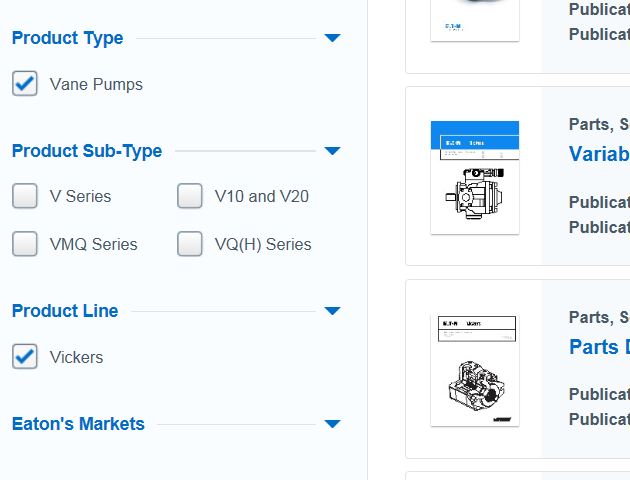

Skylark,
I work at Eaton (Vickers) in the Hydraulics Division. Might be able to help you out if you can find a pump number. Below is an image capture from our parts listing site.
Jeff

Sky, if you look just below the fitting on that flat part of the pump [this is a pump, correct? your not using it as a motor?] you will see the part #. In the picture I can see a 2 but cannot make out any other ###'s. These pumps are very tough and can be resealed or rebuilt cheaply. Lots of aftermarket stuff out there. Heck the last few repair kits I have purchased from Eaton [Vickers] have been from overseas. CJ
/ Exploded diagram for Vicker pump off Ford NAA
Thanks guys. Here is the number. V250-8-6A-12. Followed by S49 LH

Well I got it apart today. Pretty straight forward per CJ's instructions and the exploded diagram. It looks pretty good for an old pump in my opinion. The old seal is kind of hard, not exactly brittle but not that great. A bit of scoring on metal parts but nothing outlandish. There is one spot on the ring that isn't great. The outer sealed bearing needs to be replaced the inner rides in hydro fluid and is in great shape. The shaft looks ok. I got a bearing for $8 at the local bearing house. The seal kit is ordered and will be here tuesday. Total should come in under 40 bucks. Here are some picts. IF anyone sees anything questionable please let me know.
Just FYI a rebuilt for this application would be $480 plus a core charge. Given that is nearly a quarter of what i have into this tractor total...that doesn't really pencil out for me...20140710_125209.jpg20140710_120653.jpg20140710_122154.jpg20140710_122112.jpg20140710_122056.jpg20140710_120819.jpg
/ Exploded diagram for Vicker pump off Ford NAA #16
That ring is shot. It at least needs a ring and vanes. That pump is old enough that you have to replace individual parts. Pump looks as if the body is also the end plates/port plate. CJ
/ Exploded diagram for Vicker pump off Ford NAA #17
I agree with CJone: That cam ring is in bad shape and should be replaced.
