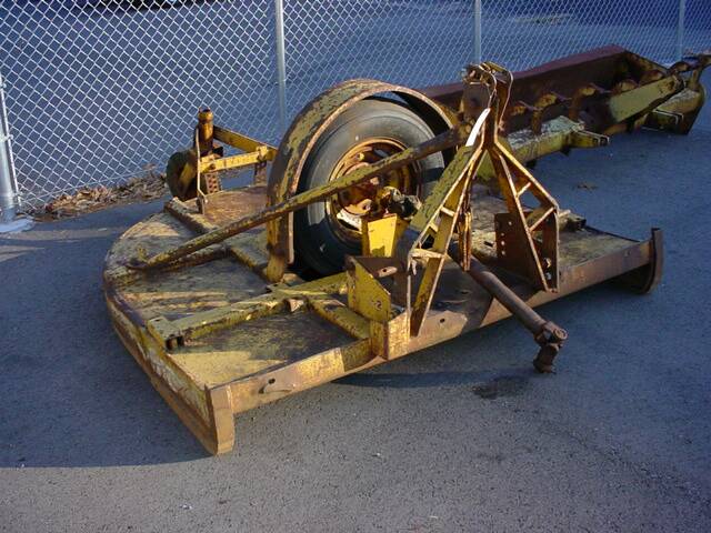

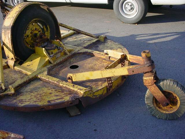

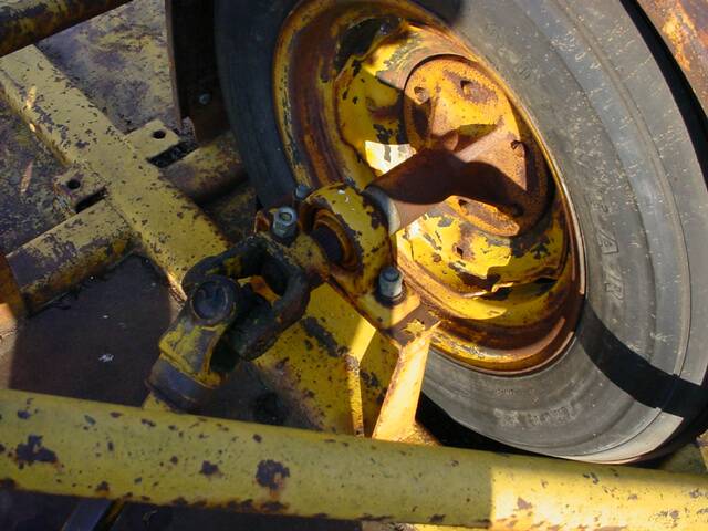

/ Explain this to me.. #7
Are you talking about a Bush Hog as in attached. If so I have seen them before but never inspected closely. I just assumed that there was no gearbox and they were driven by the wheel/tire?? I can't tell from pics of this one?? Found it on a local city Gov't Auction site. You can bet the next one I see will get a close inspection just so I know!!
