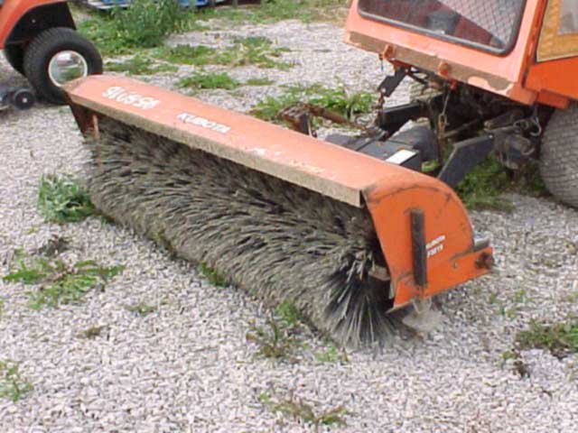

Attached are a couple of photos the dealer sent me of the unit. Does anyone see anything that I should be concerned about?

   / Experience with Rotary Sweepers #8
The broom looks pretty beat up, and appears to have been reversed once.
On top of that, there aren't any dolly wheels to hold height of the broom, so it's always hanging from the hydraulics.
Check on what a replacement set of brushes are going to cost.

I have run power brooms on Kubota tractors and also skid steers.And I have never seen any with dolly wheels.
   / Experience with Rotary Sweepers #10
If you look close in the last picture you will see two brackets hanging down from the tractor frame that are attached to the arms. These set the sweep height, and take part of the load off the cylinder.
The brooms are not the best, but for what a set cost, you run them to nubs ! Mine look a lot worse than these. Again, as I told you above, the pivot is a weak spot with so much weight on it, also, my gearbox loves to work loose due to the shaft angles at full swing. You also need to go see this in person, swing it full left and right, watching for how much it leans (worn pivot again) and listen to both driveshafts, the gearbox, and the brush drive chain
