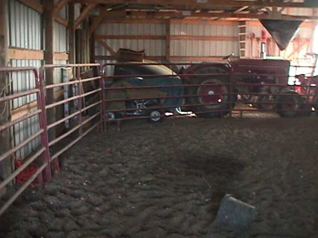

more panel pics

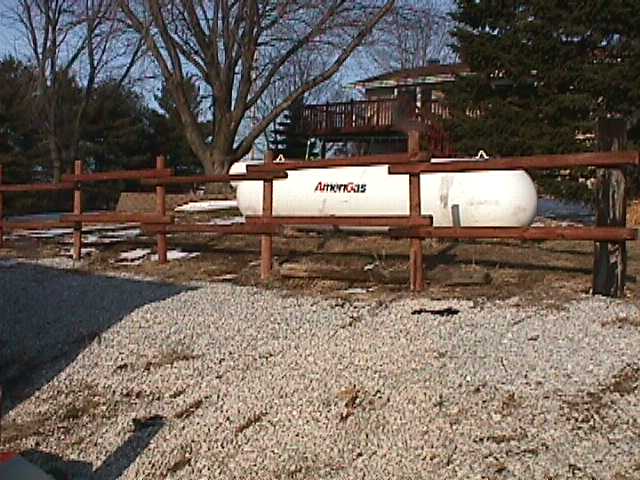

Here's another cheap way to go for either fencing or for an arena. I actually got the idea from friend that did this with four poles for an arena. What it is is landscape timers, the beefy ones. I can pick them up at the end of the season each year for $1 to $1.50 and they are regularly $3 - 4 dollars. The big ones are basically 4 or 5" posts. I soak them in 3 foot of oil for about a month before I put them in the ground. He's had his arena for nine years now and never broken a post. I didn't do my arena that way because I know that cows would probably break it but it makes really nice looking fence. I can do an 8ft. section for about $4-5 getting them on sale.

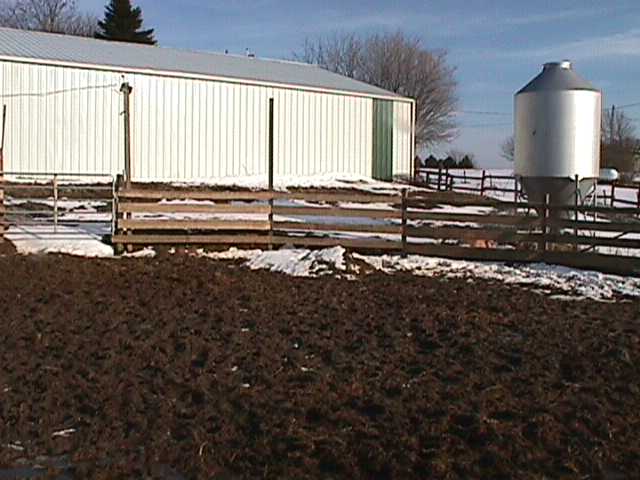

Here's another pic of it.

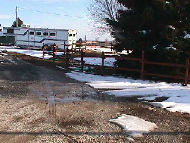

Lastly this is how I built my round pen.

How did you attach the rails on the landscape timber fence? BTW, I was in Home Depot today and they wanted $21 for 100 foot of 4" tile plus $19 for 100 foot of the fabric. I will definitely have to find a contractor's supply.

Attaching the rails.... That was the easiest part Grant. I just lag bolted them in with 6" lag bolts. I had an 18 volt dewalt that did great. I predrilled with another 12 volt I had and then put the bolts in with the 18 volt. It went up really fast.
