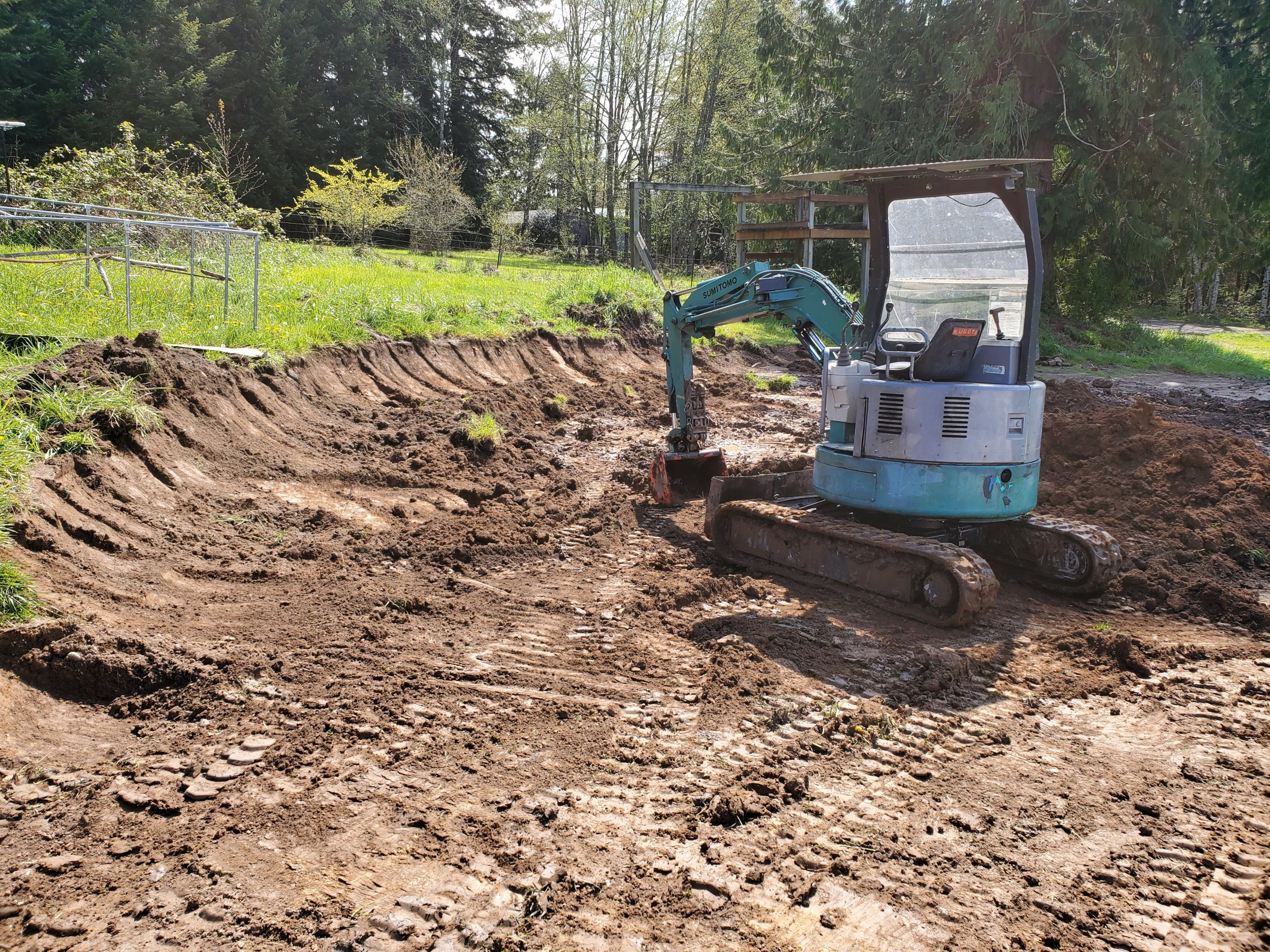

1992 Kubota l2650
Hello everyone, I am new to excavators and just picked up an old sumitomo (IHI) uj18 mini excavator. As the title suggests this machine has widening tracks. they were working for a little while, then i sucked them in, and one of the tracks got stuck in the narrow position. I am really just wondering how this system works. from what I know, it is a single hydraulic cylinder that operates boths sides. and the tracks are on a sort of "rail" system (small tube inside of big tube). I have cleaned it as best i can with no luck. So as it sits now, one track is free moving and the other is stuck all the way in. I have tried to pull it with my tractor while operating the hydraulics with no luck. Should I just pull it harder??
thanks everyone.

if you rotate the bucket to the side and lift the track off the ground does it try to move?
   / Expandable tracks stuck in narrow position #3
You’re probably supposed to lift the tracks off the ground before sliding them. Are you doing that?
it does not move. I always lift the excavator off the ground before trying to retract or expand the tracks.
Yes I always lift the machine up when i try to expand/retract them

I found the problem. The stop on the track was broken causing the track to over extend. So the cylinder was pushing out as far as it could go. I welded the stop back on and all is well.
