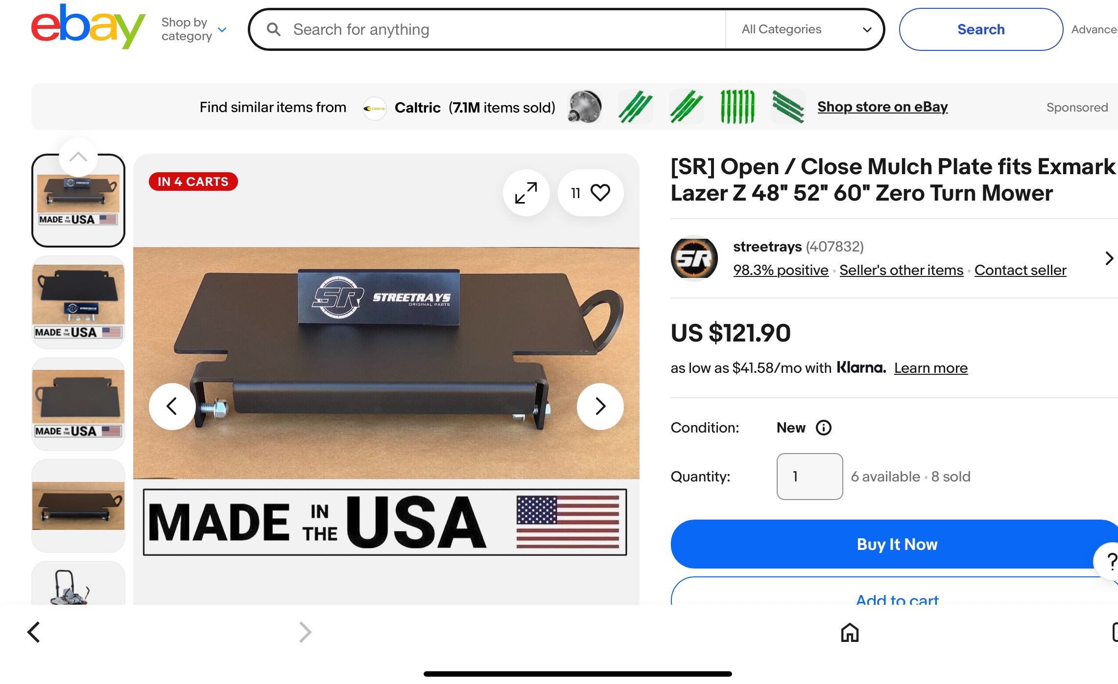

New to me 60” has the stock grass flap and makes windrows to recut. I need to be able to close the chute off around cabin and wife’s flower beds and open it up away from buildings.
Several manual brands are available as well as Amazon generic starting at $150 up to foot controlled for $3-400.
Any TBNers use a manual chute blocker and would you buy another one?

Found a plate on EBay cheap enough

Unless you have the full mulching kit it will leave windrows, its not meant for mulching, its meant to block to the discharged grass from going where you don't want it, that's it. A set of gator blades will help reduce the windrows a bit. I will never own another ZTR without an operator controlled chute blocker, its far from a fad. The exmark chute blocker is really nice and comes off and on very easily compared to others. Switching brands isn't going to fix the windrow issue.
