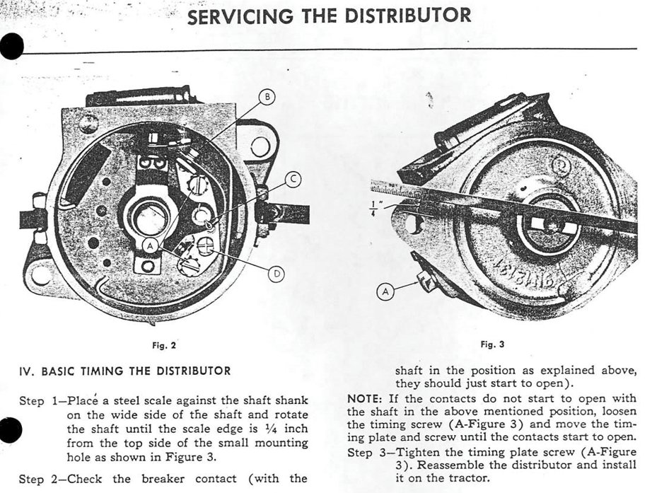

Been trying to revive an old 8N after sitting for 7 years. 6 volt, with front mount distributor. Have replaced a fair bit of parts, new gas tank, fuel line, sediment bowl, and all 3 screens. Passes fuel flow test from carb without problem. New points, condenser, distributor, square coil, and battery. Got it started and running well (new carb) and discovered that the genny was not charging so it would start running rough after about an hour when the coil started not getting enough voltage. Or at least I assumed so. Took the genny to an expert on 6 volt systems (he's worked on a lot of N's and Model T's) and installed new genny with a cut-out instead of the VR. Installed it and wasn't getting power to the coil and discovered the wire from the ammeter to starter relay was bad! Replaced that. Started it yesterday and noticed the exhaust slightly popping after it warmed up. Ran it for an hour and could still hear the popping. Valve maybe? Added some SeaFoam to the fuel and ran it for an hour this morning (ambient heat about 100') and then heard it really popping and occasionally backfiring. It was stalling on the drive to the barn (adding choke made it worse) but got it parked and noticed the ammeter fluctuating at idle from 0 to -5. I assume thats the points opening and closing? Let it cool for 2 hours and started it, no popping or back fire! Haven't ran to full warm up yet but am inclined to think the coil is overheating? Any way to check other than buying a new coil? The one on it is new from Tractor Supply but I haven't heard good things about their parts. I'll also check spark in a few minutes when I take it out and get it warm again.

Just started it again. Ran fine till I put a load on it and then started stalling. Immediately, within seconds checked fuel. Good flow from carb. Checked spark next, orange spark on spark checker for all 4 cylinders. Battery is full charge. Don't think its points, I've checked them so many times my hands are hamburger! I'll swap the coil out for the original next and see what happens.

Swapped coil back to the old one. Much better. Ran up and down a steep hill in my back pasture and it reacted well to the governor kicking in when it got steep. Would have died before. Still not as bright a spark as I would like but I might just get my last field mowed before the Fire Dept. starts writing me tickets. I will run it again this afternoon as soon as the temp drops below 95 and see what happens
