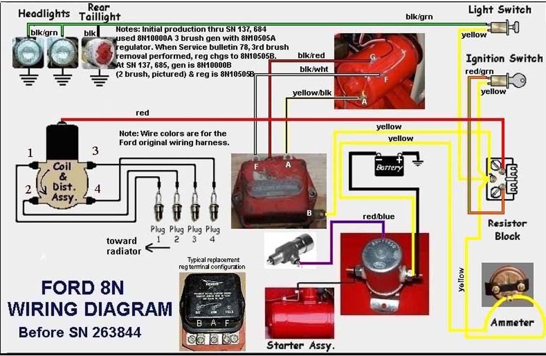

I've narrowed it down to a specific at least. I am getting a weak spark when it starts and then as it runs the spark gets weaker as the battery dies. I replaced the generator and VR already with a new generator and cutout but it doesn't appear that I am getting any output to the battery/coil. So, when I increase the RPM's or put it under load the cylinders start missing and it eventually dies. If I remove and charge the battery seperately it will run off the battery at full power for about 30 minutes and then slowly start missing again. I have 6V at the battery (not running) and the same voltage when it is running so I am assuming that the new generator/cutout isn't working and the coil, slowly, doesn't get enough voltage to keep it running. At best I get an orange spark on the spark checker that fades when applying more throttle. it also runs longer and better if I jumper the ballast resistor so I'll have the shop check the new generator/cutout. This has really gotten to be a long process...
When the 8N came out, Ford replaced the cutout relay with a voltage regulator. You may want to consider taking it back to factory spec.

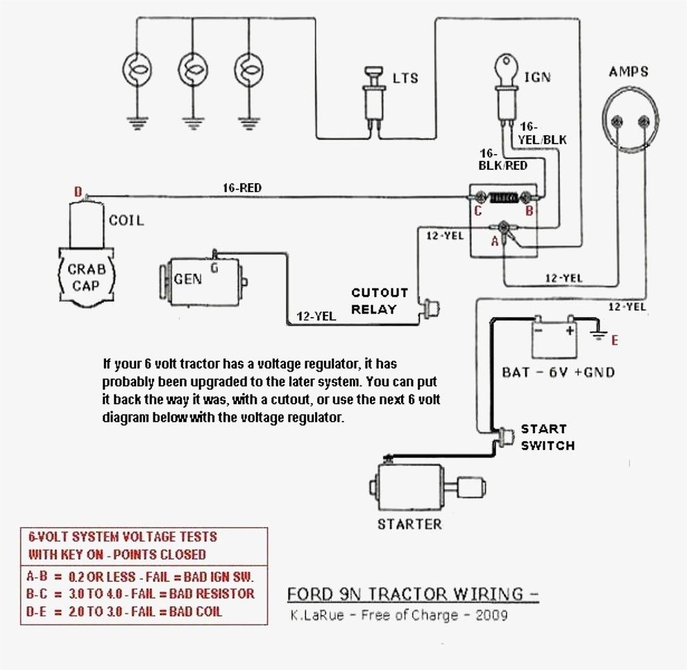

If I am looking at these diagrams correctly, the only difference in the physical wiring between it having a cutout and it having a VR, is that 1 wire comes off the generator to the cutout and 1 wire to the mounting block vice 3 wires from the generator to the VR and 1 wire to the mounting block. So, when the tractor is running, there should be 7+ volts across that single wire regardless VR or cutout? Because I currently have no voltage there.
