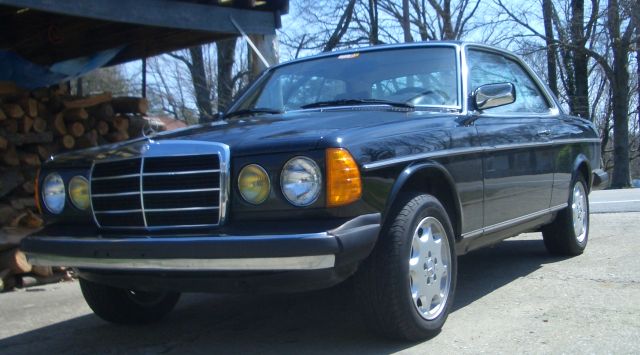

   / Excessive Blow-by on Kama 554 #57
greg_g said:
Actually - neither do I. Have a "clapped out old Mercedes " that is. //greg//
Ha ha Ha! What the heck do you call that?????
   / Excessive Blow-by on Kama 554 #58
Well sir - if you have to ask that, I'm sorry to say that you know less about Mercedes than you do about Chinese tractors - and that your sole motivation for posting is apparently one of instigation.
The car you're yukkin' it up about is a comparatively rare 300CDT; a turbocharged five cylinder 3.0 liter W123 coupe (forerunner of today's E-class). Perhaps you forgot to count the doors. I venture to say it will continue to increase in collector value long after you trade that Kompressor model in for your next toy.
Due to the vintage of its engine design, I found it a reasonably appropriate reference to use - relative to Rob's interest in adding a PCV valve to his KAMA
//greg//

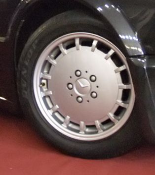

   / Excessive Blow-by on Kama 554 #60
Flyhiflylo said:
Should I bid 5K on this
Since you insist on completely hijacking Rob's thread - yes. At that bid, it's a good investment. The current NADA collectible guide reflects top book for that particular car is $12,150. About 5-6 years ago it bottomed out around $6400, been climbing ever since.
And yes, the 92 style 15" wheel and tire upgrade increases the value to select buyers. Plus I have had the original 14" alloys professionally refinished. Should a purist make me an offer I can't refuse, they go with the car.
Note I said 92 style wheels. Your '89 190E would have been sold with what they then called the "new look" alloy
//greg//
