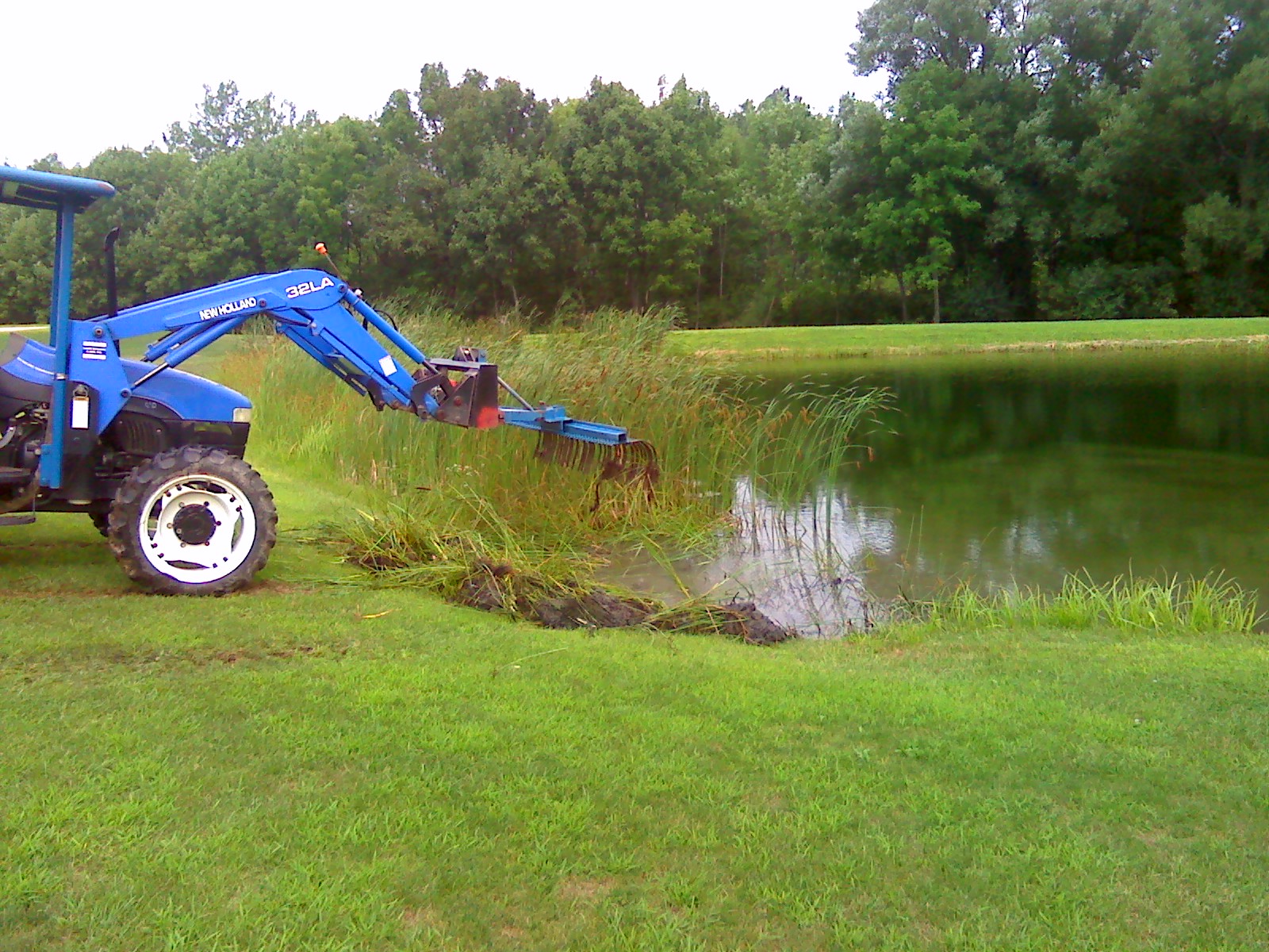

I cleaned up my cattails last summer with a york rake on the tractor loader. I used a skidsteer plate to 3 point adapter. Overall, it worked well when the banks had a slight slope. Backing up with the hydraulics in the 'float' position to rip the cattails out by their roots, then curl the rake to pick up the mess. I had traction problems on steep slopes when trying to pull material and back up the incline. An excavator would work better, but this was a no-cost quick solution for me. This setup also worked well for scraping brush out of a ditch without removing any dirt.

Hook a his your rake on the end of your rental excavator

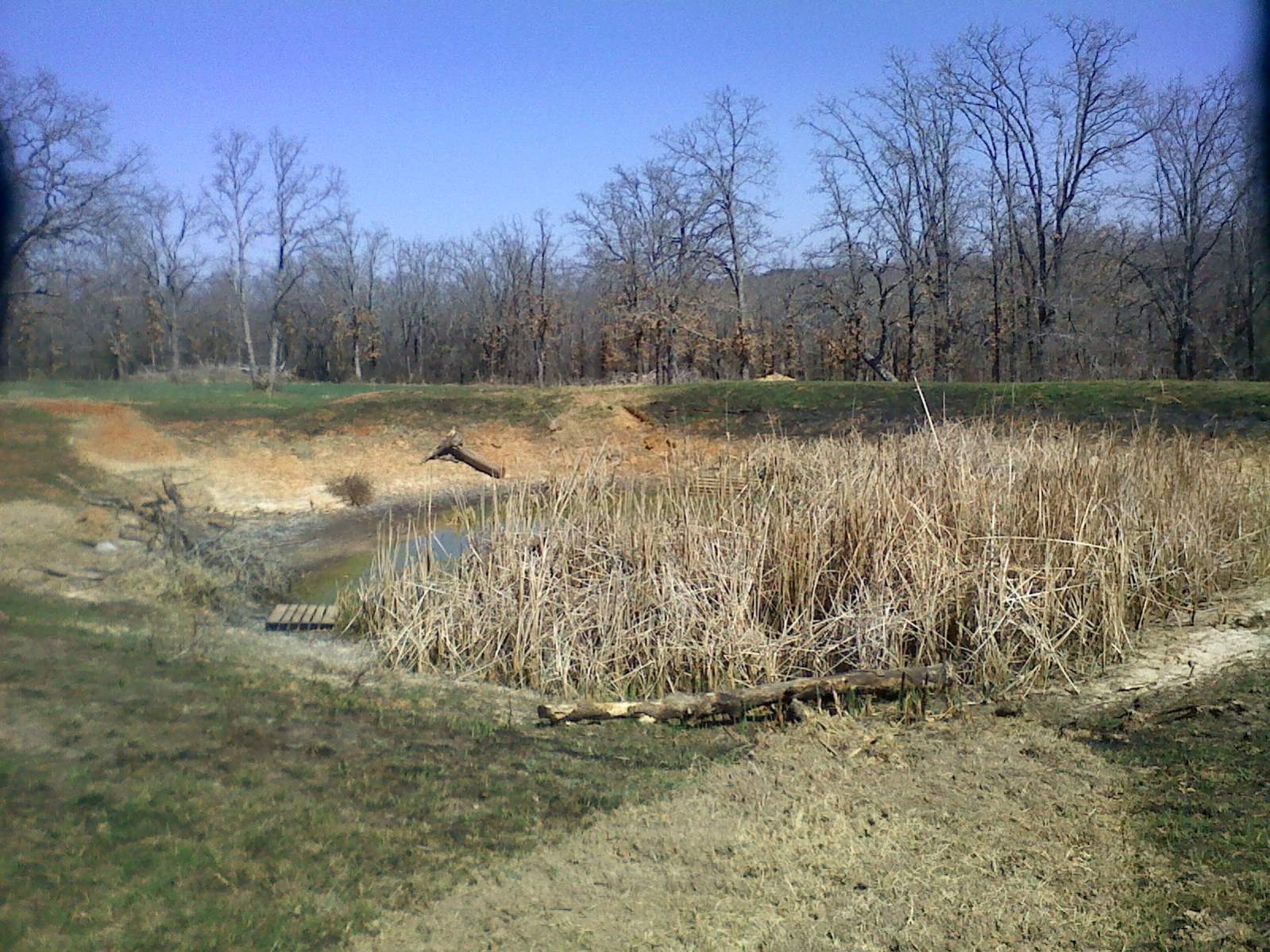

Here is a photo.
2 more month's without rain and I'll be able to jump in with my tractor!

I think your right, if I do go that route, the bigger one would allow me to work from the upper side and avoid being on the dam.
I will have the guy that dug the "hole" out soon for a half day's pushing stumps, he may have some valuable input.

I would be quessing that your pond drops 1' for every 3.5' to 4.3' you go out depnding on where the 8' depth occures? Just quessing do you have any pictures? If this is the case that's not that steep, normal drop is 1' for every 3' out. A mini can handle that angle with out an issue. I have taken my 4000lb mini on much steeper angles.

I would not have any problems clearing that pond with my mini, nor getting the weed on the bank for later removal. Your experience will give you the answer on what you can handle as far as this job would go. You could also cut a small road/ramp into the pond so the drive down would not be so steep. Eddie is correct digging is the easy part getting rid of the spoils is the pain. I have a ditch bucket on my mini {30" wide with water drain holes} it can move one heck of a pile of cattails in no time. Digging weed is a lot different then digging dirt and IMO easy to get rid of.
