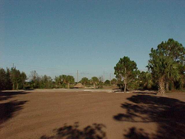

I just heard of post-tension slabs for the first time a few days ago. I did a fair amount of research and understand how they work. Sounds interesting. It must have something to do with soil conditions, however. 99% of houses built in my area of Florida are built on monolithic slabs, and none are post-tension. In our city, over 6,000 homes were built last year, from $150K to $3 million, almost all on slabs. In my research, I saw mention of clay conditions. Our soil is 100% sand.
The ironic thing is, because our new house has to be elevated so high over the surrounding land in order to meet code of 18" above the crown of the nearest road, we're going with a crawl space and perimeter walls with columns supporting the joists. I've built the area around the house up 30" with fill from my pond, but the house floor has to be a minimum of 26" above that. The house being constructed next door is on a slab, and they built the pad up about 60", first. Now, they have a huge mound that has to be sloped to the surrounding land. We'd rather have raised porches and a few steps.
Attached is a picture of the area we built up for the house - approximately 200' x 200', so there will be a nice, gentle slope to the yard, and slope right down to the pond.
