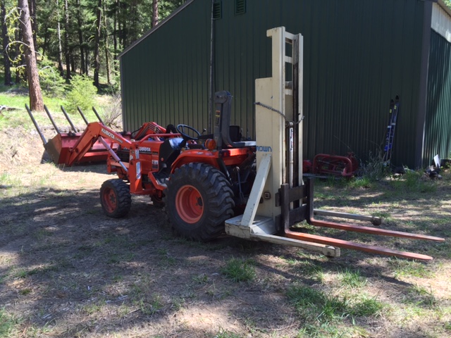

After a lengthy discussion with knowledgable TBN members (Bukitcase, RSwyan, J_J & others) I finally understand this "problem". Many thanks for their persistence.
A tractor can work for years with no "Power Beyond" circuit (PB) on a remote, but understand that the valve seals are at risk whenever the 3-point is loaded (or topped out, anything causing upstream pressure). Keep in mind that the 3-pt hitch lift is almost always the last device in the circuit & doesn't have PB because it's the last device. But every valve upstream of the 3-pt requires a PB port, and a direct, low-pressure return to the tank.
It does not risk the internal spools, or crack the valve casting - the problem is that without a dedicated return to tank, it over-pressures the external seals.
Here is a pic of a tractor with a heavy 3-point attachment (the 3-pt forklift). You can't see it :D , but this tractor (currently) has no PB circuit on the remote valve - thus is "at-risk". The forklift's weight on the 3-point causes high pressure on the external seals of the (upstream) "remote hydraulic" valve. Which "may or may not" cause a problem, as long as the levers on the valve upstream are never "moved" while this weight is on the 3-point. While the 3-point load is pressuring the external seals, moving any lever (sliding a spool) could blow the external seals right then and there.

What do you know about this tractor setup with forklift?
Is he using the 3pt to raise and set the forklift?
Is he using another set of valves maybe loader valve or remote to operate the forklift cyl?
Could he be using a splitter at the back feeding some to the 3pt and the remainder of the flow to the lift?
Do you think he has it plumbed correctly?

Harry, It's confusing because the problem culminates when two events overlap (happen at same time).
1) there is a heavy weight on the 3-pt, over-pressurizing the valve seals
----- AND -----
2) the operator moves a valve lever (sliding a valve while its seals are over-pressurized)
If the valve lever is not moved at this time, its possible that the valve can handle the over-pressure, maybe forever. So lots of tractors survive it. If all your 3-pt ever lifts is a 400 lb bush hog, maybe you will never have a problem.
I can see how lots of valves survive. My valve is (currently) fine, but it's not proper hydraulic design. Until I locate a PB adapter & re-plumb you can bet I'll be cautious moving my remote valves when there's weight on the 3-pt.
Understanding the "Power Beyond" problem was a goal, and for that I'm happy!
J_J we're posting at the same time. :) It's my tractor and its NOT plumbed correctly. Its plumbed like the princehyd diagram above. Now that I "understand", :D the only time I'd use the rear remotes is when the forklift is sitting on its own wheels, on the ground (no weight on the 3-pt). Incidentally the forklift attachment is not yet functional.
