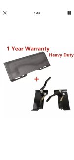

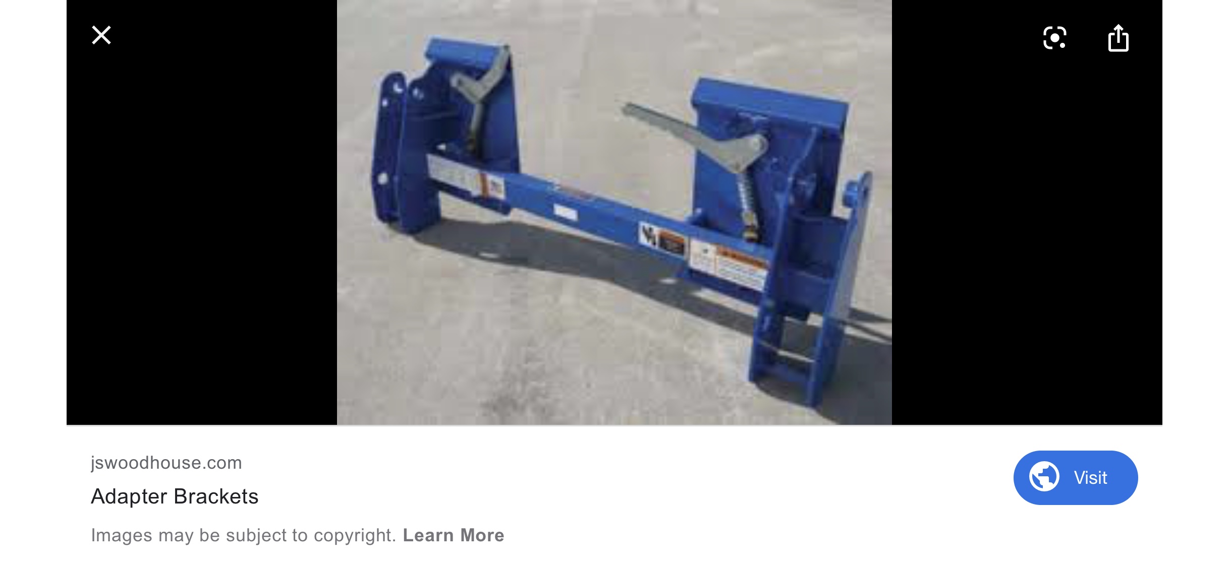

Has anyone converted their conventional pin on bucket to a skid steer quick attach. Looking for some pictures or ideas took some measurement and the cl300 loader is a actually wider that a skid steer plate not by much just enough to make my life difficult I purchased so plates and SSQA adapters attaches is what I bought as well as what I’m thinking I might have to fabricate. Any advice or help would be appreciated

Currently have a pin on style bucket but the width of the actual loader is almost exactly the width of a skid steer plate. Not much I can do for mounting brackets to ssqa pre made plates
OK....I take it you do NOT have an SSQA male part on your tractor now, since you're using a pin on bucket.
If you'll notice the adapter that goes, and stays, on the loader, the 'male' part, with the 2 throw handles, that connects with the plate on the bucket/forks/etc is narrower than the pin position on the loader.
See the photo you put in the first post:
620888d1568253681-ex3200-cl300-loader-converting-ssqa-img_1520-jpg
The adapter will connect up just fine with the SSQA plate on the bucket. You will have to cut off the pin mounts on the bucket and weld the 'female' SSQA plate on it.
