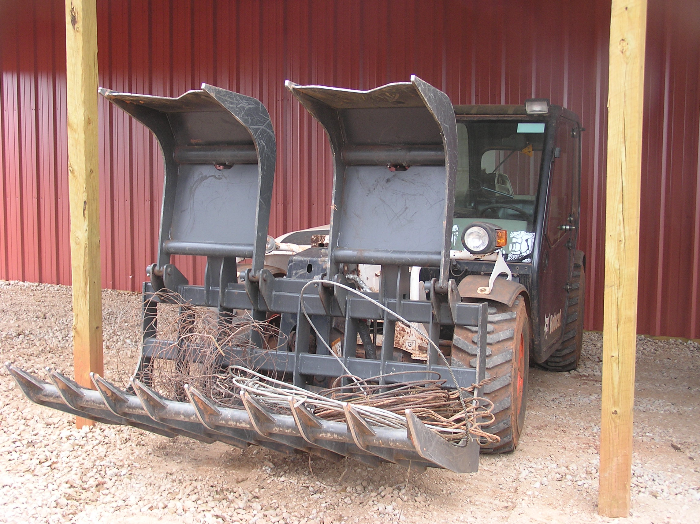

I had the lids and the grapple under a 1000 watt work light to help cure the paint. It certainly was not easy to paint.

So what exactly is the spacing between the tines ? I count 9, but how wide ?

While I understand the reason for all the lightening cut out holes, I wonder how much a PIA they will be with twigs being caught in them. Just a thought and maybe not the problem I envision.

I wonder the same thing about the expanded metal? :confused3:
I have twigs and small branches catch in mine when opened and dumped. :(
Look at all the wire and cable caught in it now! :laughing:

They are a little over 8 1/2" apart.

Thanks. I doubt that they holes will catch much stuff. A stick would have to get wedged almost perfectly to get caught.

I guess some stuff will get caught in the expanded metal but I would rather have a stuck twig than something fall back on the tractor.

I see - your design is a bit different than mine so the mesh would interfere with the QA, perhaps (might depend on how tight it is to start with). On mine the QA attaches on the outer edge as it is 48" so mesh in the middle interferes with nothing. I wouldn't worry about catching twigs in the mesh too much. I find it rarely happens. The larger holes in the tines may be more susceptible to that. You'll find out. When dealing with brush, crap get everywhere...

Here is a crappy picture. I have more but the photobucket app is not cooperating. I will take some better pics later.
