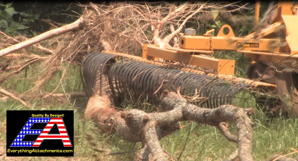

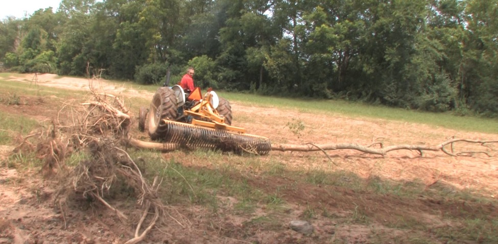

Our EA Landscape Rakes use the highest quality Italian tines on the market. Everyone looking for a rake should check out the video where Ted & Peanut find several ways to abuse one.
Travis
/ Everything Attachments Landscape Rake #17
This root ball rolled and tumbled. We did spring a tine, but much worse could happen from this sort of abuse.
