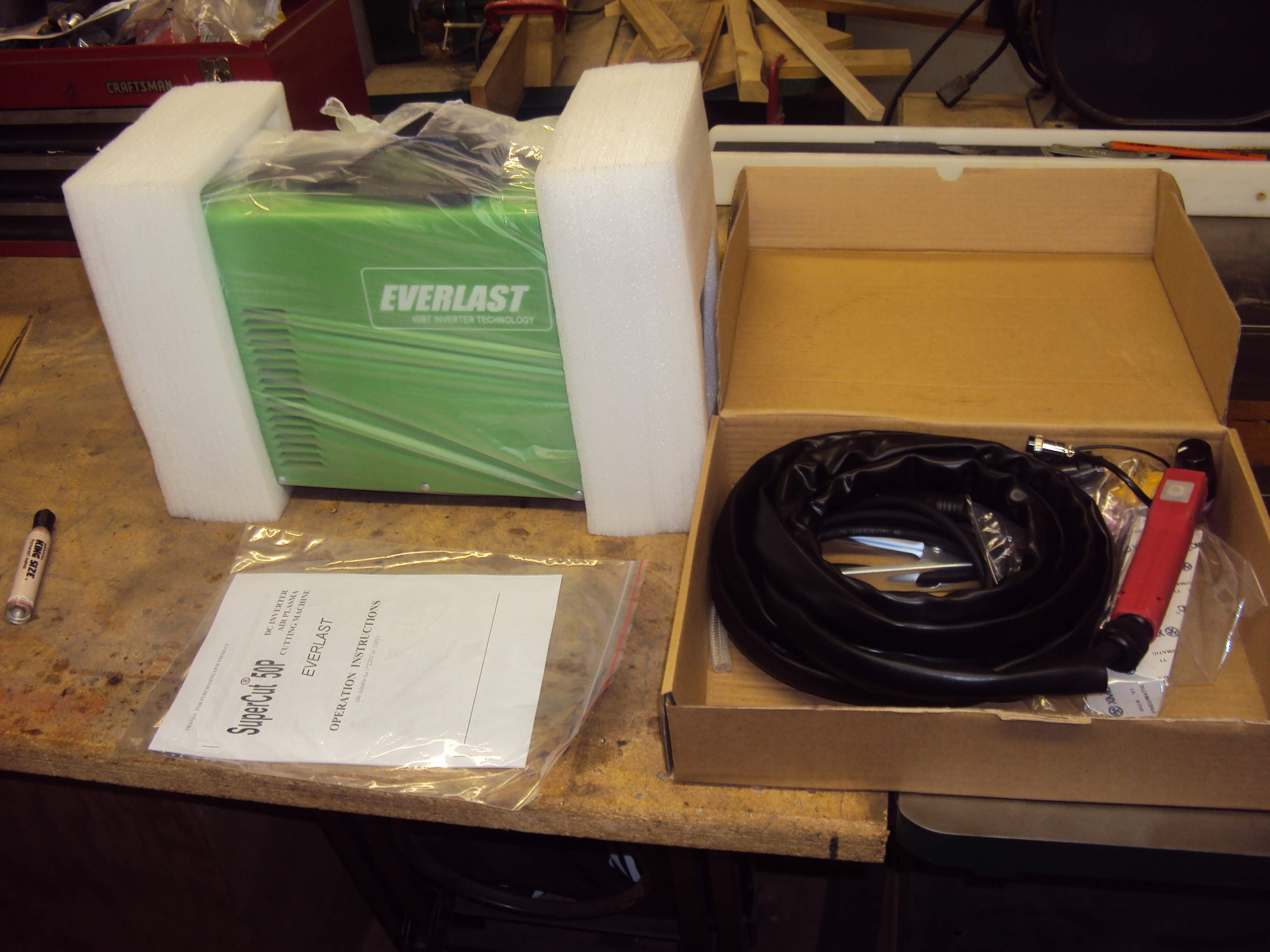

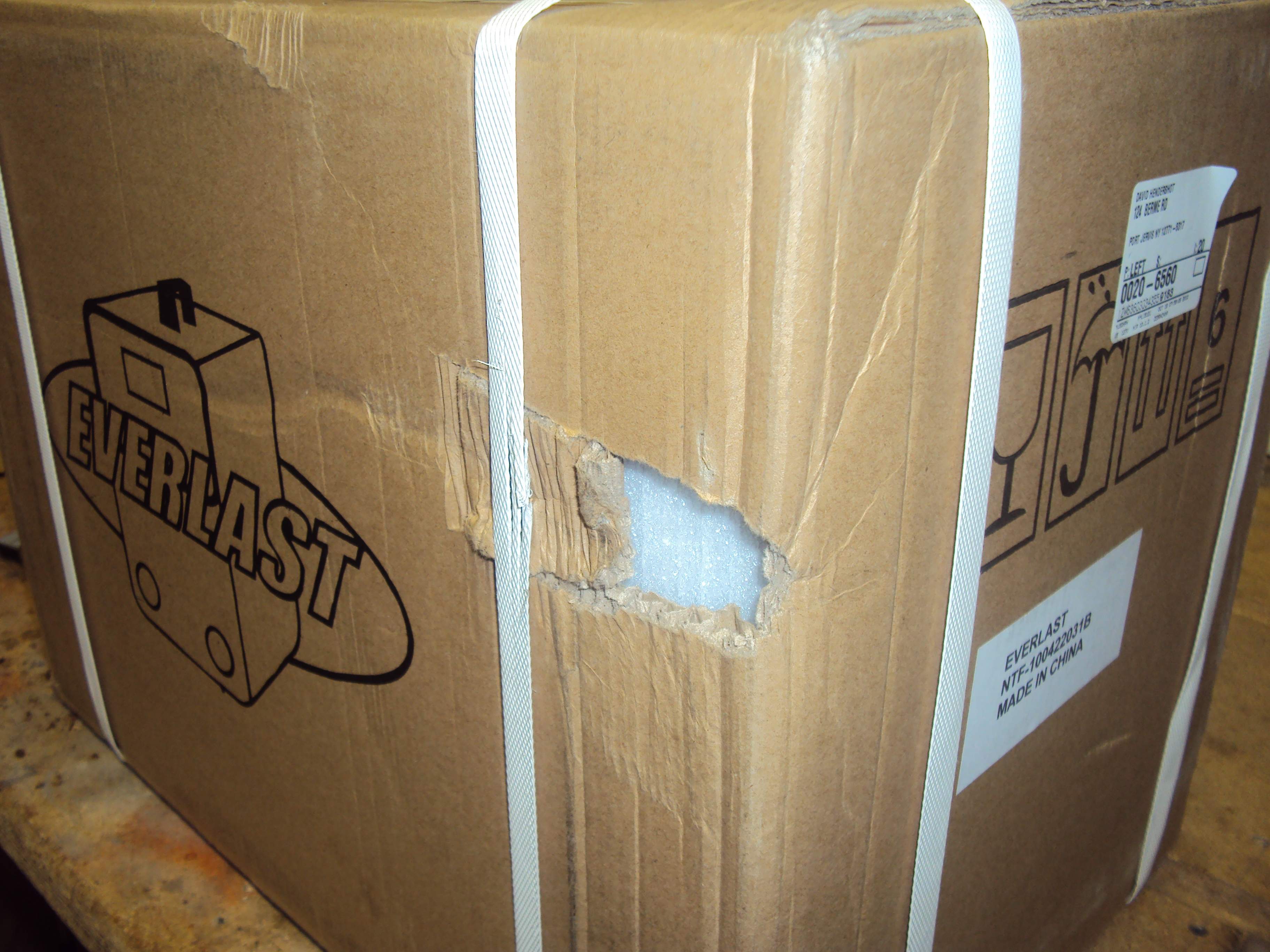

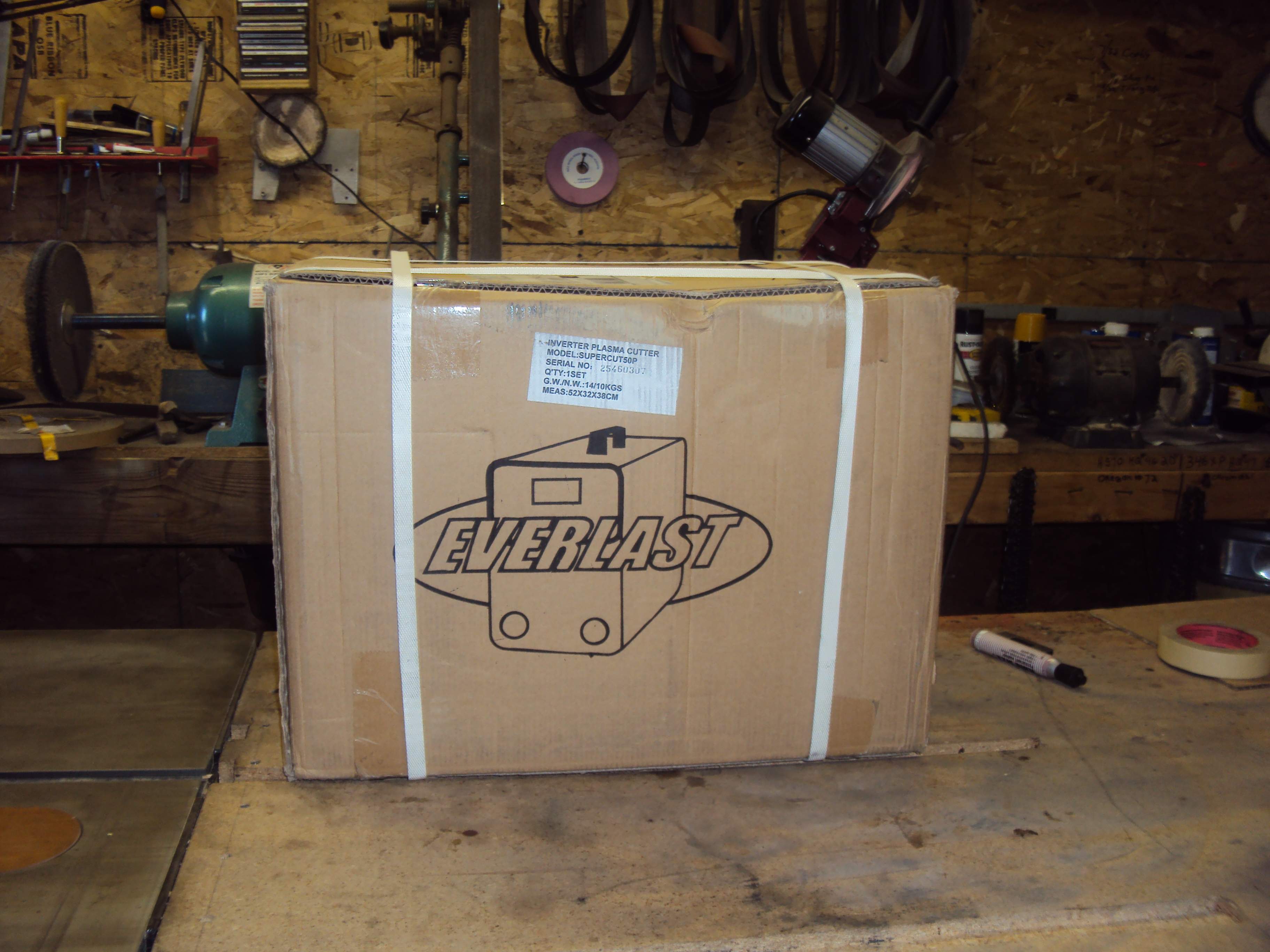

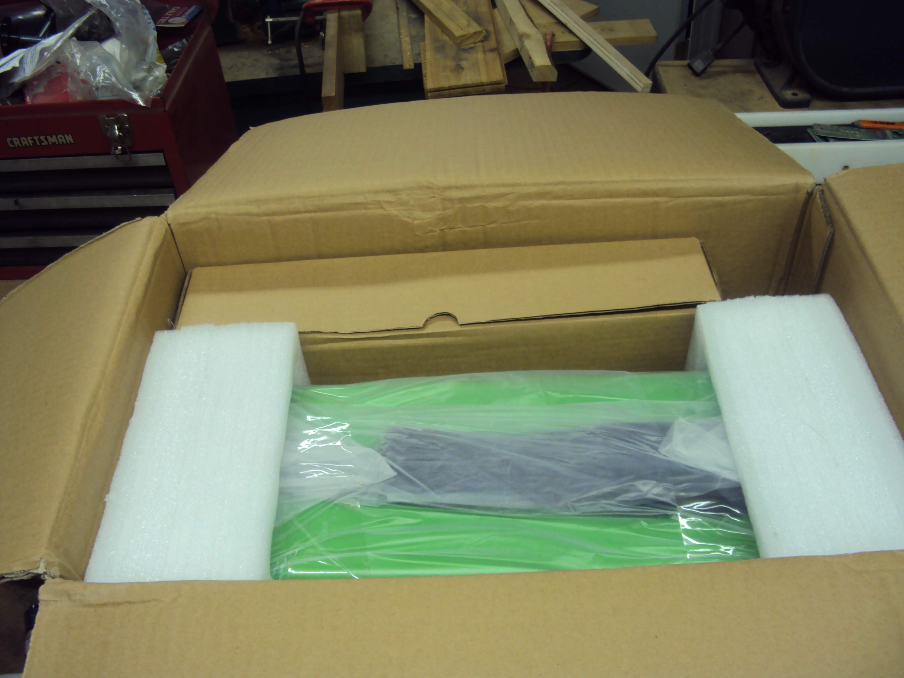

A quick post before I go to work. I received my Supercut 50p on Monday October 18. That was 11 days after I ordered it, not bad considering it was coast to coast, and this is the peak season for shipping. The unit came well packaged, and a good thing too, because there was a tear in the box, (see pic.) I wanted to get right to it, but I found the enclosed instructions were very poor, (,I was aware of this from other posts.). I went to the Everlast site, and downloaded that manual. Even with those instructions, there was not much information on how to hook up your cables, and air filter/regulator. It was pretty easy in any case. If you have any mechanical ability, you will figure it out. "Square peg, in square hole, round peg, in round hole etc...
I did not like the plug that came with the cutter, so I will put a dryer plug on it, and make an extension cord for it. I did notice that the machine was tested, and certified. You could see the burn marks on the tip. I will post more, when I finish the wiring. Just a reminder, that I have never used a plasma cutter before, and I figured I would post about how easy, or difficult the machine is to set up, and use.
