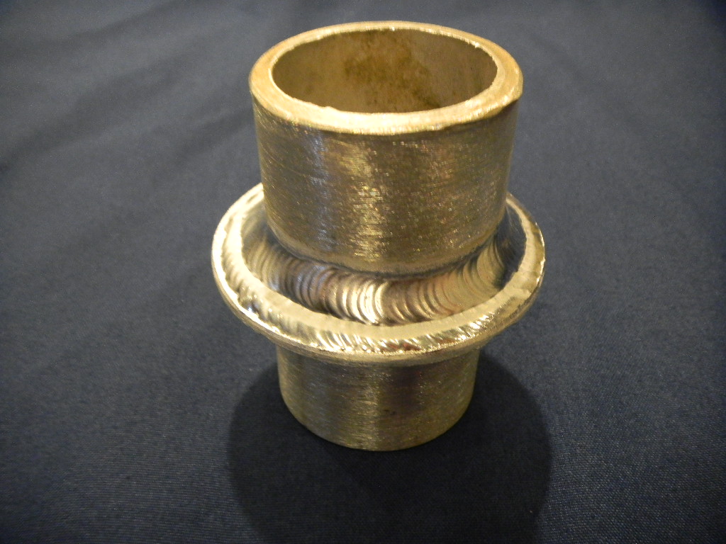

It is true aluminum sucks up the amps like a kid eating candy. But you can always go old school and us DC and helium. I found I can just about cut my amps in half when using helium. :thumbsup:
Do you use straight helium on DC? I've never heard of welding aluminum with this method. I've heard of using Helium/Argon/Co2? mix on AC for more penetration, but never on DC.
   / Everlast powertig 250EX Welder / Anyone bought one / It's on my list #14
   / Everlast powertig 250EX Welder / Anyone bought one / It's on my list #16
If you do try it remember, there is a really, really small window where the arc will light off. So move the tungsten very slow up and down! And you have to make an extra effort to clean the aluminum. Notice the black around the weld with helium? Then notice the white around the pipe weld that was done with 100% argon on AC? AC will clean the aluminum more so than DC!
