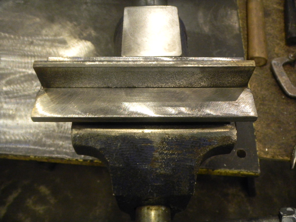

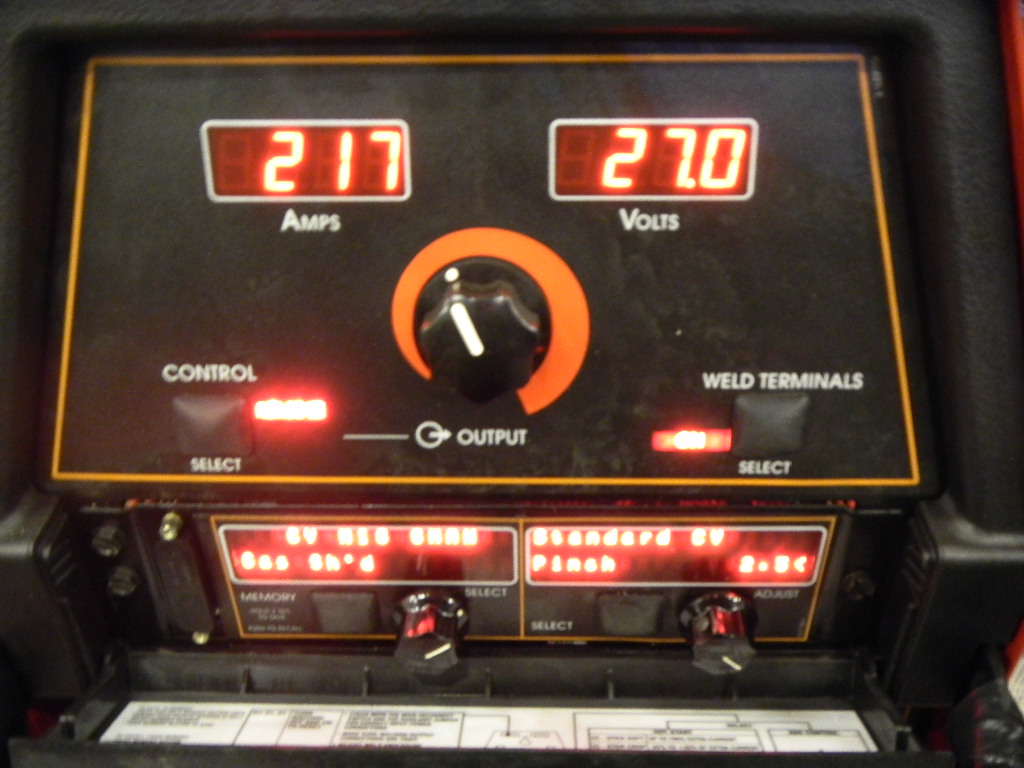

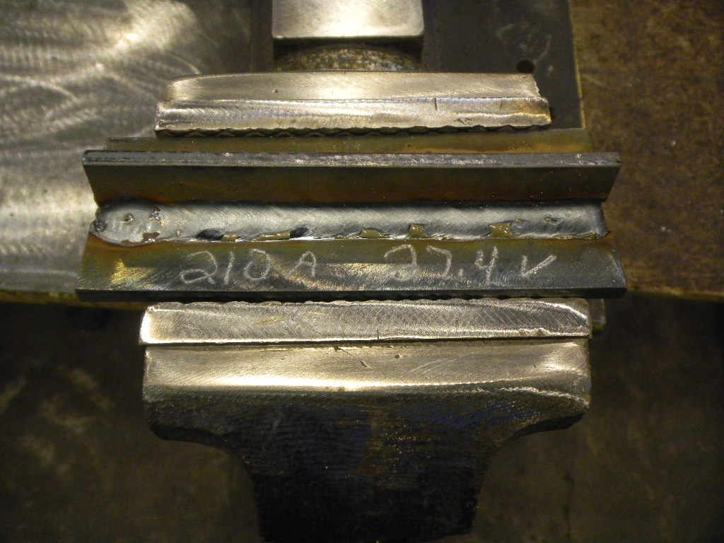

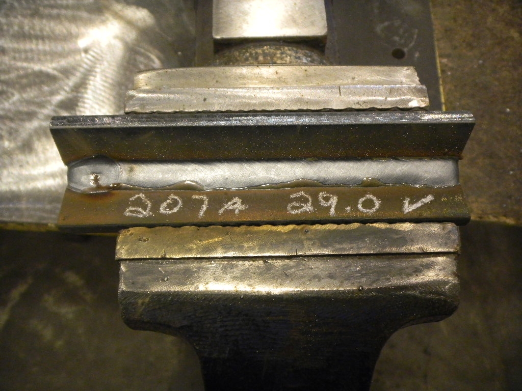

Hi stuckmotor! Last year a member over on Welding Web who works for Hobart, shipped me a roll of wire used for spray arc. I rented a bottle of C-10. 75% Argon / 10% CO2. Yes it is very fast, and hot, and makes very nice looking welds. But the base metal has to be spotlessly clean!:thumbdown:
"Would you recommend it for farm repair and fabricatio"? No! To me its not worth the hassle. I'll stay with Lincoln's L-56 Mig wire, and C-25 gas.
Here are a few pictures of spray arc I did.
