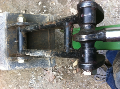

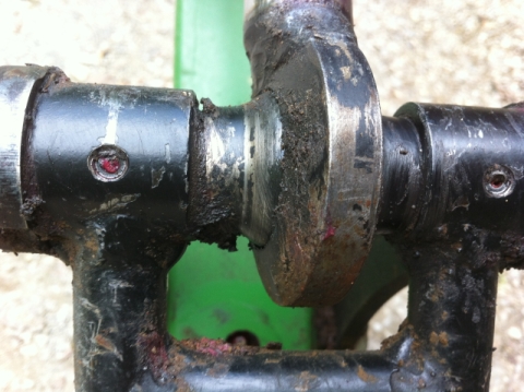

So I'm doing my 8 hour grease.........on my pt I have 22 grease points.........except when I'm done I've only counted 20 and I've run out of tractor......so I go back to see where I missed two and come across this........sheared two of the zerks right off.......I can't even explain how I could have done it as the location isn't at a place that would be contacted normally when digging but obviously I hit something........so now I've got to get the remnants out so I can install new zerks.......extractor tool just arrived from amazon today......any tips before I have a go at it?......Jack

I'd be very tempted to start with a left-hand drill, maybe 3/16 or so. There is a very good chance that the bit will catch instead of cut and walk the whole rest of the zerk right on out for you. Based on 1. the threads are already full of grease, so lubricated and protected from rust, and 2. it was busted off by a side impact, not by trying to turn it while rusted in, so the odds of the threads actually being free to turn once you can get it to spin are pretty good. I'd also try spinning it with a punch or small chisel. Maybe even see if you can get it to spin by lightly jamming a small screwdriver in it.
I prefer left hand drills over most ez-out type things, since they do not wedge inside the hole and jam the fastener tighter, and if it doesn't walk the fastener out, it still drills a hole (though you do have to tighten your chuck more often).
My brother had some extractors that were not tapered, they had very small hardened fins on the sides to just catch the sides of a drilled hole when you drove them into place with a hammer, but I don't know where he got them. This design also let him rock the fasteners, and did not require him to turn them all one way for that wedging action to get them free. Rocking back and forth (like when cutting threads) rather than just keep applying more and more pressure in one direction seems to be one of those things that really helps for rusty stuff.

well that didn't work........tried the extractor first and it wouldn't budge......in fact it stripped the tip off on the extractor......then went to the punch and no go and then tried screw drivers hex wrenchs and anything else I could get in for a tight fit........but at the moment I still have two sheared zerks firmly wedged inside......guess I will go searching for the left handed drill bits next........there's also a rubber tipped adapter for grease guns I saw to use for when there isn't a zerk that could always be a fall back option.......Jack

they are all wrench hexes.......I took one out from another part of the machine to make sure and it's threaded.........I'm wondering because of how they sheared off below the hex that I must have hit them pretty good and maybe it distorted whats left inside which is why they are so stubborn to get out........Jack

I checked the diameter of the fitting by removing one from a different location and the drill bit set I ordered will have three bit sizes that will fit....9/64 5/32 11/64.......so I figured I'd use the smallest size first and if that doesn't do it then I'll try a little heat like you suggest and move up to the next bit size....there isn't a lot of the zerk left inside.....maybe 1/4" in length so if I could just get it to move a little it should come right out........or maybe thats just wishful thinking......haha........Jack

left handed drill bit set came and went to work on it this afternoon......started with the 9/64 size which is bigger than the 1/8 hole in the zerk........drilled right thru with no movement of the zerk.....stepped up in bit size and same result.......hole is bigger but zerk still firmly there.......at this point I realized that the amount of zerk that was sheared off in the hole just isn't long enough for the drill bits to catch anything before drilling out the other side.......so I resign myself that I am going to have to drill the zerk out and then re-tap the hole.......keep stepping up in bit size to do it gradually.......the hole size is 7/32.......when I finish with the 3/16 bit I look in the hole and see the threads poking thru and looking in good shape.....so I run a q-tip in it to clean it out and then try to install a new zerk in it to see if it will catch.......bingo....success.....just to make sure I attach the grease gun to it and the grease flows thru.......so now I tackle the second sheared zerk the same way.......only when I get up to the 3/16 bit the tip breaks off in the hole and I can't get the piece out.......errrggg.......since the bits are strengthened steel I don't really fancy trying to drill it out so instead I remove the bolt holding the cylinder in place so I can punch it put......then back to drilling the zerk out until the threads are visible and checking to see if a new zerk will install.......it does.......so on monday I will head down to the local equipment rental shop to see if they have 2 zerks to match the ones on the pt.......long and drawn out but finally success........still don't know how I sheared them off in the first place.......thanks to all who gave suggestions and advice...really appreciate it......Jack
