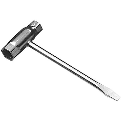

I'll bet you started carrying a scrench after that.

/ Ever had this happen? #14
Socket plug screwdriver

/ Ever had this happen? #15
Wow, have plenty of those, just never new they had a name.

/ Ever had this happen? #17
Nothing worse than walking in to your wood lot and throw a chain, or need to snug up that chain, or (in this case) put your spark plug back. Then ya have to walk that 1/2 mile back to the tractor to get that scrench ya left behind.
I never bought that holder for the scrench but I do carry a small tool pouch on my chaps with scrench and files.:thumbsup:

/ Ever had this happen? #18
When we go cutting, we always take the toolbox. Just a little rubbermaid thing. But has some files, sharpener jig, t-27 torx, pack of allens, small carb tuning screwdrivers, and a couple of screnches. Usually dont have to use any of them, but the first time we forget it, we need it.
