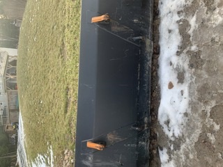

I have a quickie brand 710 loader. It's on a 55 hp Kubota.
From my understanding, there's a few different sizes of the euro global attachment system; my manuel shows a few different mounting styles. The tool carrier for the bucket I have is very clearly what the manual calls "Euro (8)" . I cannot find much about the "Euro (8)" online
I'm wanting to a blank plate sytem like one of the ones in the links below. These look to be right, with the offset upper and lower attacent points, and the measurements seem correct, but I don't want to order something that won't fit.
Anyone have more experiences with these? Will one of these for my Euro 8 carrier?
846 Global 1/4" Thick Mount Plate Fits John Deere
Global Quicke Euro Tractor Loader Blank Mount Plate – Free Ship – Skid Steer Attachment Depot

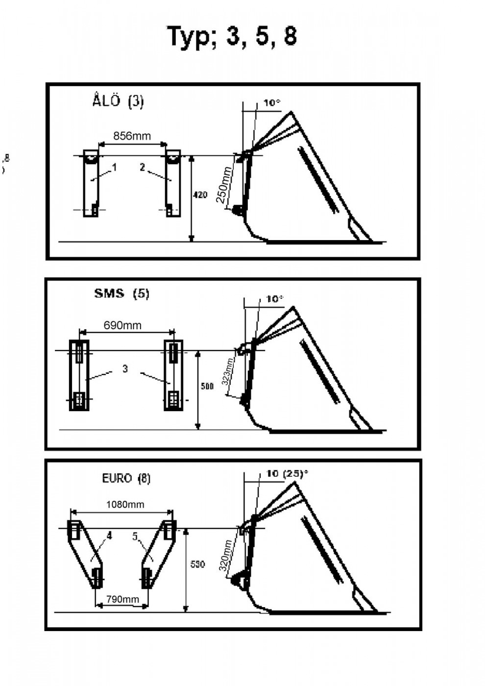

   / Euro/global/quickie tool carrier for loader #2
Here is some info I have from when I build my loader. I used the Euro style coupler, although, I had to change some dimensions to fit my needs.
   / Euro/global/quickie tool carrier for loader #3
The bottom one in the picture that ptsg posted is what I have always seen called a Euro mount.
The first one you have linked to that is called a Global for a deere looks almost right,
except for the diameter of the lower hole they look small, it may be an optical illusion.
The link to the second one looks correct to me, that is what would fit are tractors with the Global hitch.

So looking at those lower holes, my pins are probably only 5/8" and looks like the first one from titan would be a more snug/ proper fit
   / Euro/global/quickie tool carrier for loader #6
From what I've heard and read that would be correct, but I have heard that Deere has one they call Global which doesn't fit.
It could very well be correct I will have to try and remember the next time I get over to the farm to look at the lower pin size.
I went and tried to find out the proper diameter,
it seems to be 23 or 25 mm ,
23 mm = 0.9055 inch
25 mm = 0.9843 inch
good luck
   / Euro/global/quickie tool carrier for loader #7
I also have a Quicke brand loader (x2) on my m7060. I was lead to believe the attachment was called a Euro/global or ALO style. Mine resembles the bottom pic as shown above. The holes in the lower mount on mine are about 1” holes, and the pins on the tool carrier are something near 3/4. There is a bit of slop. This was the bucket that came with it new. The forks I have are the same way.
The bottom mounting hole brackets are 31” outside to outside, the top hooks are 42 1/2” outside to outside

Mine looks just like that too. Measurements sound right. But I'm still not positive those ones in my link are that size.
