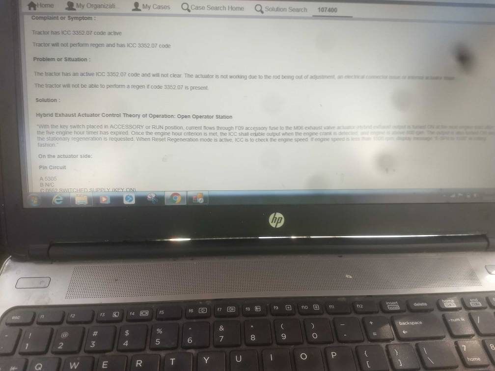

I have an error code on my tractor that "doesn't exist" for this make and model.
the code is
ICC A 3352.07
I went up to the dealer and they could not find that code for this make and model machine (2016 3039R with 105 hrs).
Has anyone else seen this?
Thanks

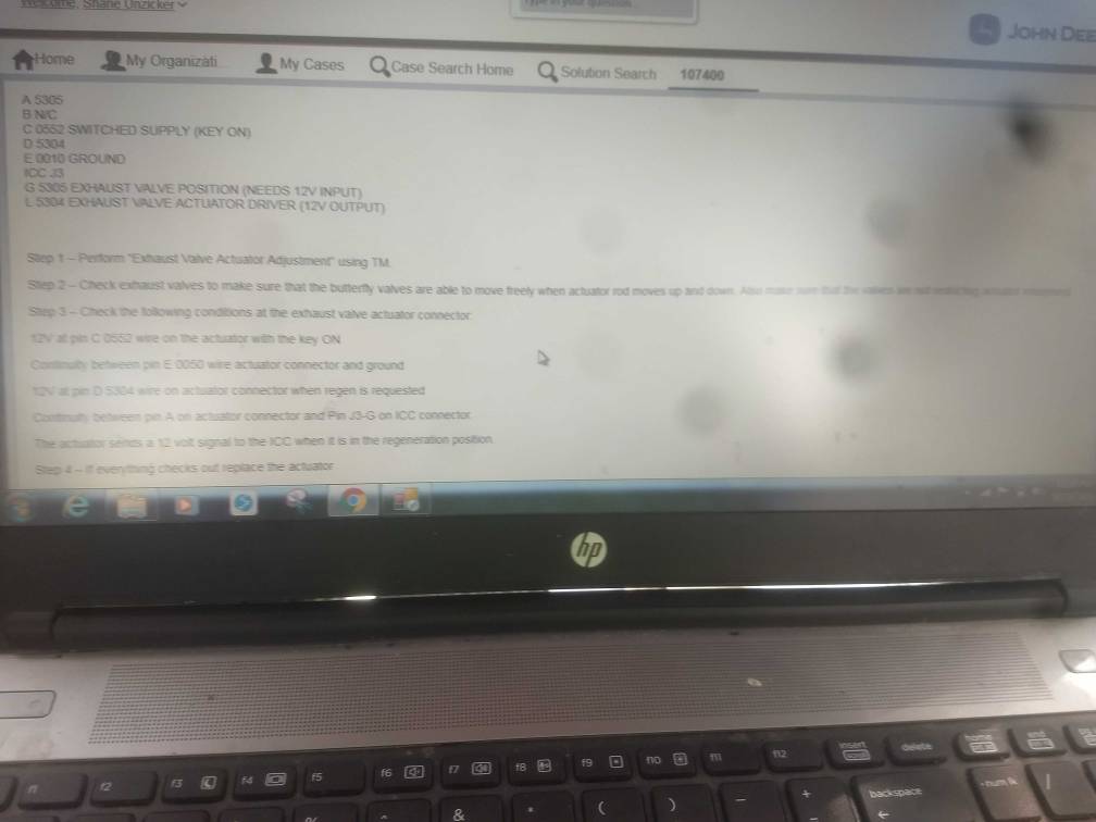

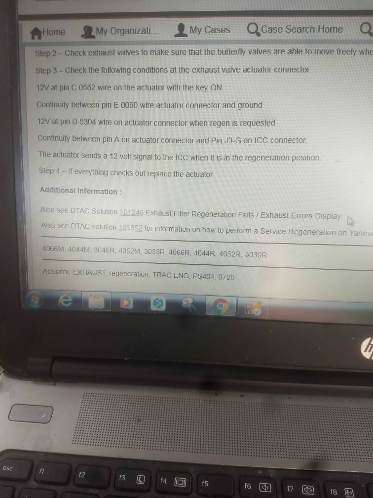

XXXXXX.07 in the Deere world is a reference to a circuit/function mismatch. Desired and actual are not the same
   / Error Code ? #8
FMI numbers are the number AFTER the decimal point. SPN numbers are the first numbers.
   / Error Code ? #10
This is a DTAC case describing it 1540316000087.jpeg1540315973674.jpeg1540315950482.jpeg
