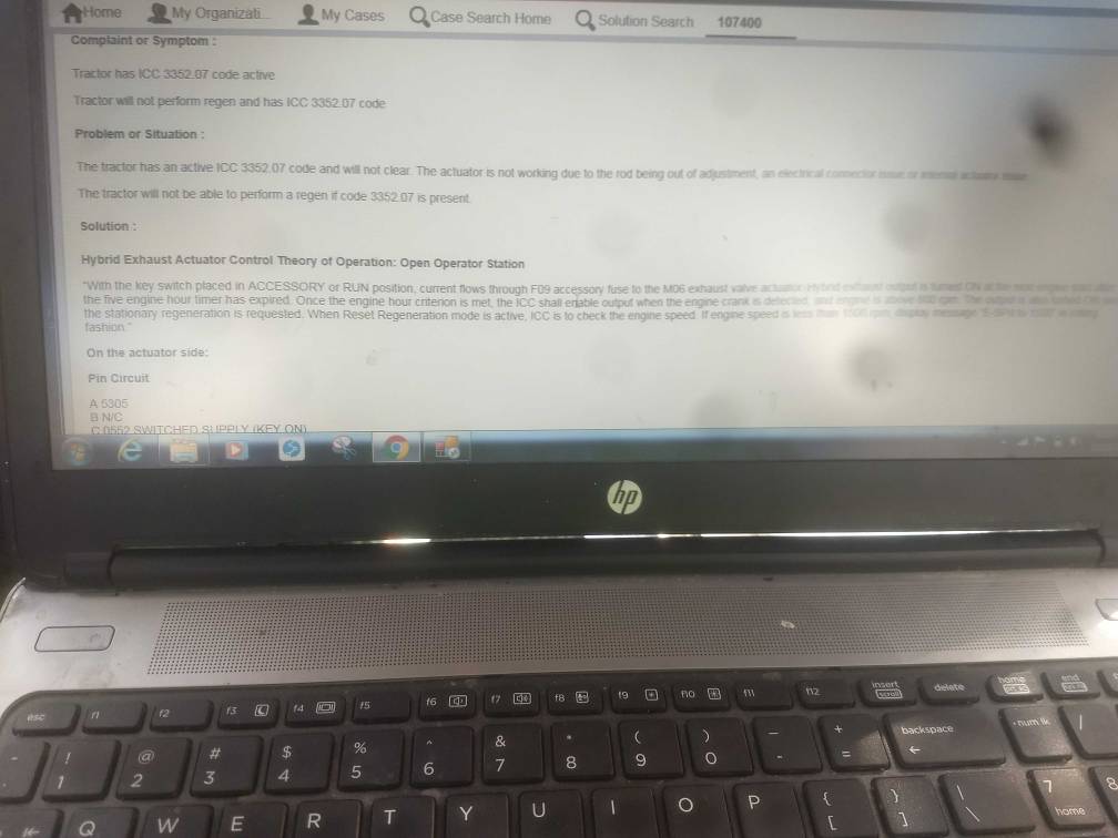

XXXXXX.07 in the Deere world is a reference to a circuit/function mismatch. Desired and actual are not the same
/ Error Code ? #8
FMI numbers are the number AFTER the decimal point. SPN numbers are the first numbers.
/ Error Code ? #10
This is a DTAC case describing it 1540316000087.jpeg1540315973674.jpeg1540315950482.jpeg
/ Error Code ? #11
It's referring to the exhaust throttle valve. It is either not working or is out of adjustment. I'm betting it is a bad actuator. But I'd verify power and such before replacing it
