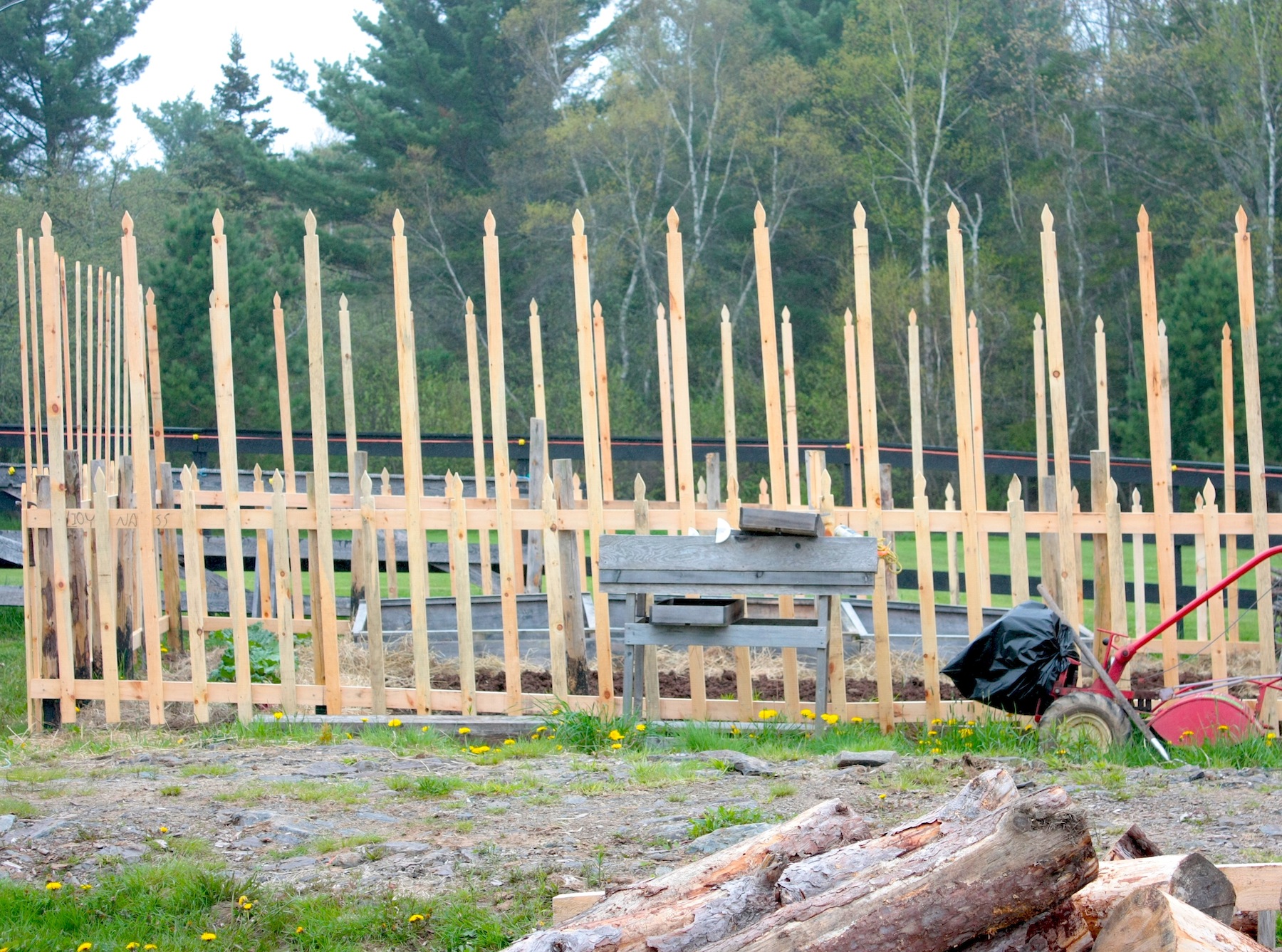

I have tried a number of things over the years. Electric fence, 8' page wire etc. Both failed.
We can have up to 22 deer(highest count) at a time on our property so it is always a challenge. Because we live in a 200 year old house and I am interested in period design, I started this project two years ago after returning from Williamsburg. The section in the photo is 30'x20' approximately. I am finishing the main section now - it is 80'x35'.
We had no issues for the last two years. It's a lot of work but it works. And I guess history confirms that.

Awesome fence, what type of wood is that lloyd?
It's a mixture of spruce and pine. Essentially they are battens 3/4"x2.5" 8' and 4' alternating with about 6" for spacing. My daughter is helping me. She traces the finial pattern I cut with a jigsaw and she gives it a quick sand. The rails are spruce and pine and the posts are round spruce. The small garden section(in pic) is for herbs/lettuce etc and has a gate between the two sections plus a gate to get in. The larger section has a gate 8'+ wide that I can get the tractor through to till, add manure etc. It is in a corner but I think I will move it centrally along the long length of fence - easier to turn in and out with the loader.
It's a lot of fun to do and really adds a nice look to the property.

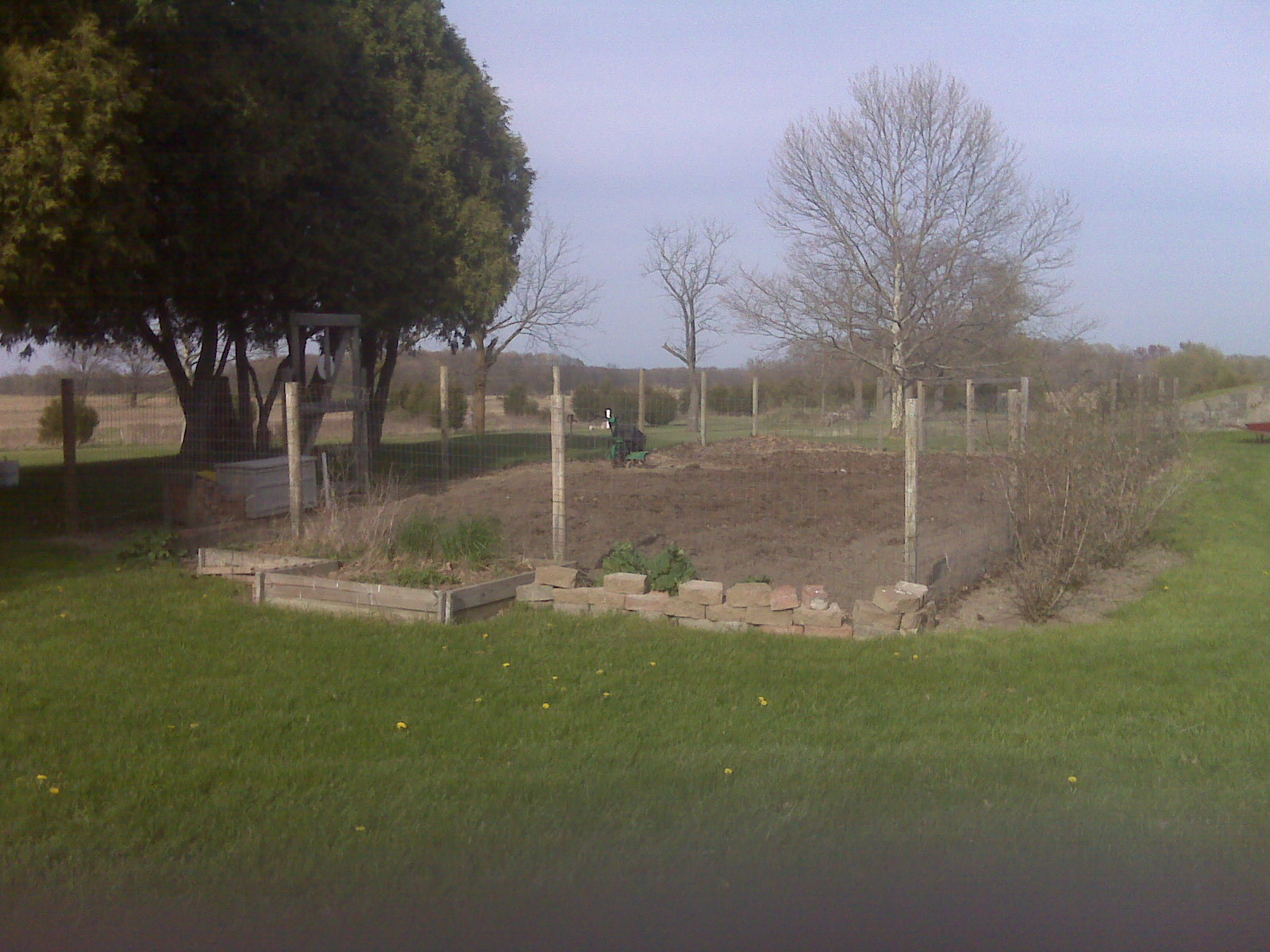

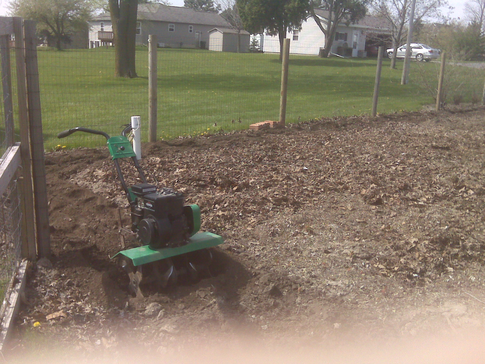

I currently have a 28X60 garden plot, It uses (for the fence) treated 3X5 landscape timbers that are 8 feet long and are buried 3 feet deep, set in a bag of redi mix for each post. The 5 foot high fence is simply 2X4 mesh with a second 2 foot high rabbit mesh at the bottom. We have deer everyplace but they never seem to care about what I have planted in the garden. Sometimes I wish I had used T-posts instead of landscape timbers as I could have just driven them into the ground vs. digging a posthole.
