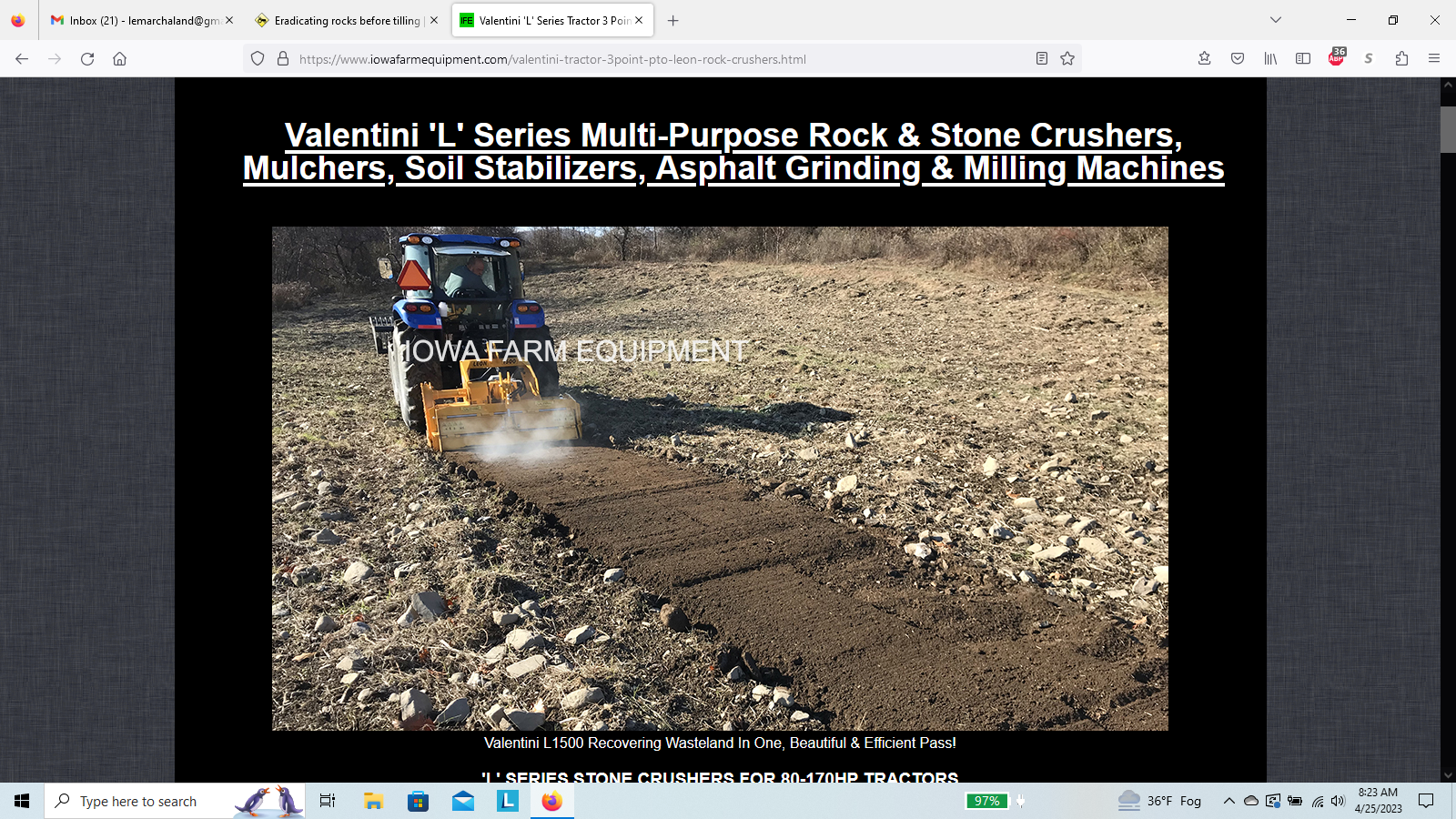

Here you go,
just get a bit more hp and have fun;
Valentini 'L' Series Tractor 3 Point Rock/Stone Crushers -- Iowa Farm Equipment
interesting videos, nice looking equipment but I'd sure hate to see the maintenance cost and time.
