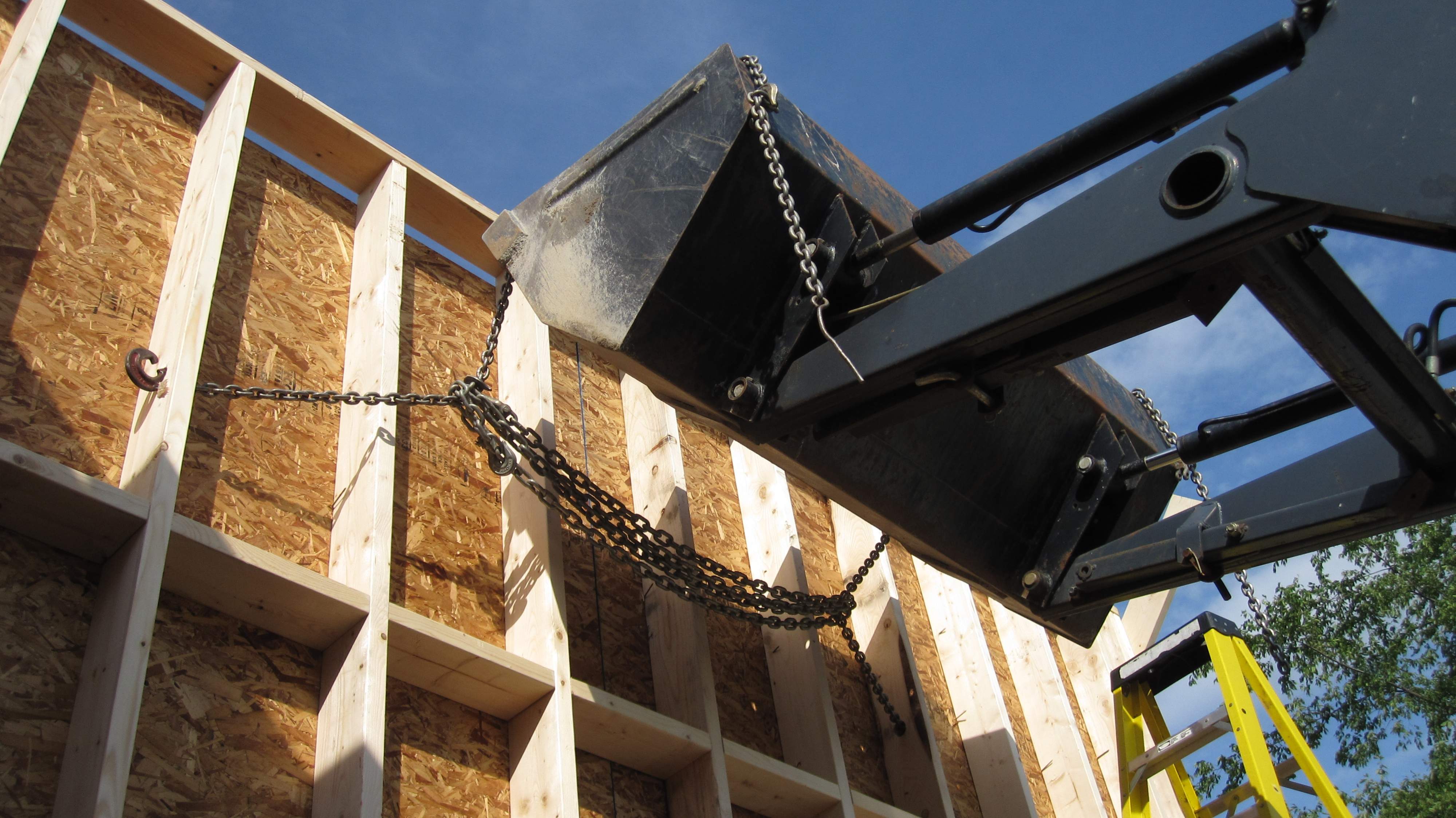

Glad it is done. And good job.
You were fortunate that the chain hooks didn't split the wood of the 2x6 studs at the holes.
But fortunate is better than the alternative. :)

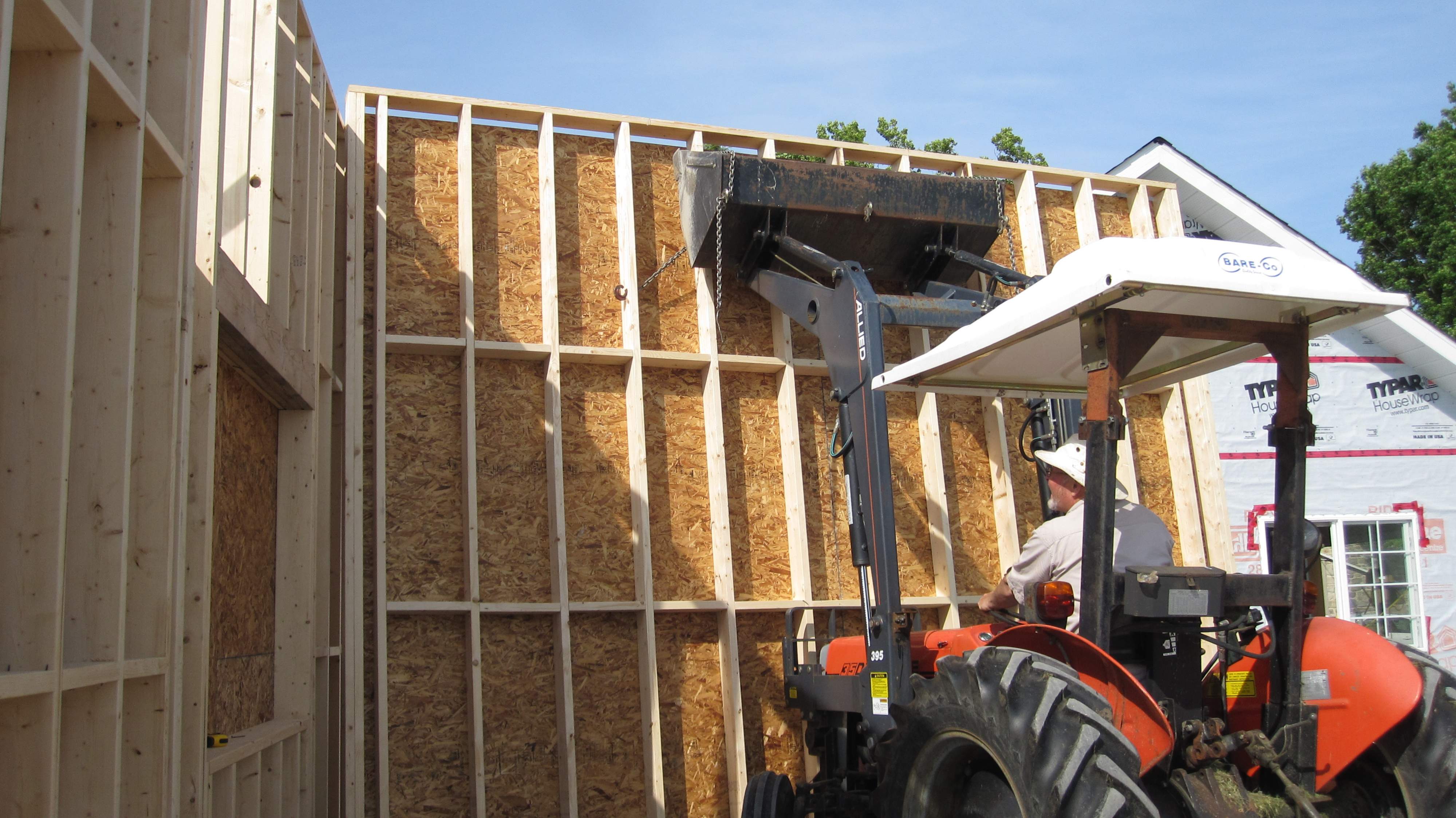

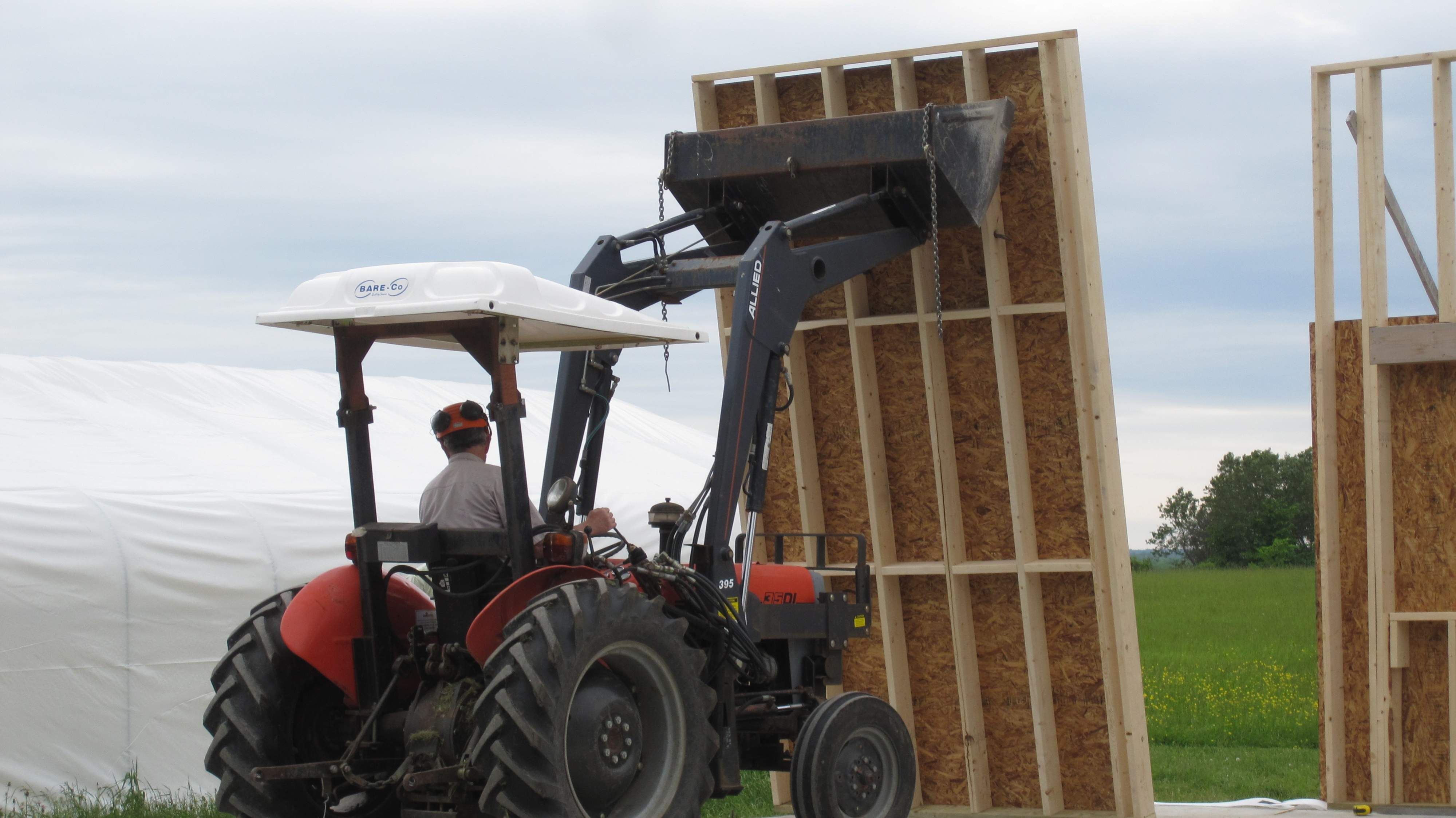

Three panels have gone up so far. Turned out not to be hard to lift them with the loader. I just drilled holes in the 2X6 studs 9' from the floor, and hooked the chains up from that point. The lifting was surprisingly easy.

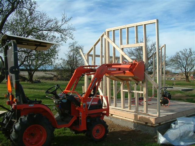

Neat. I did something similar for a small 10x12 ft shed a few years ago using my 2005 Kubota B7510 HST. Built the frames on my shop floor, chained sections to the FEL bucket and moved them to the jobsite.

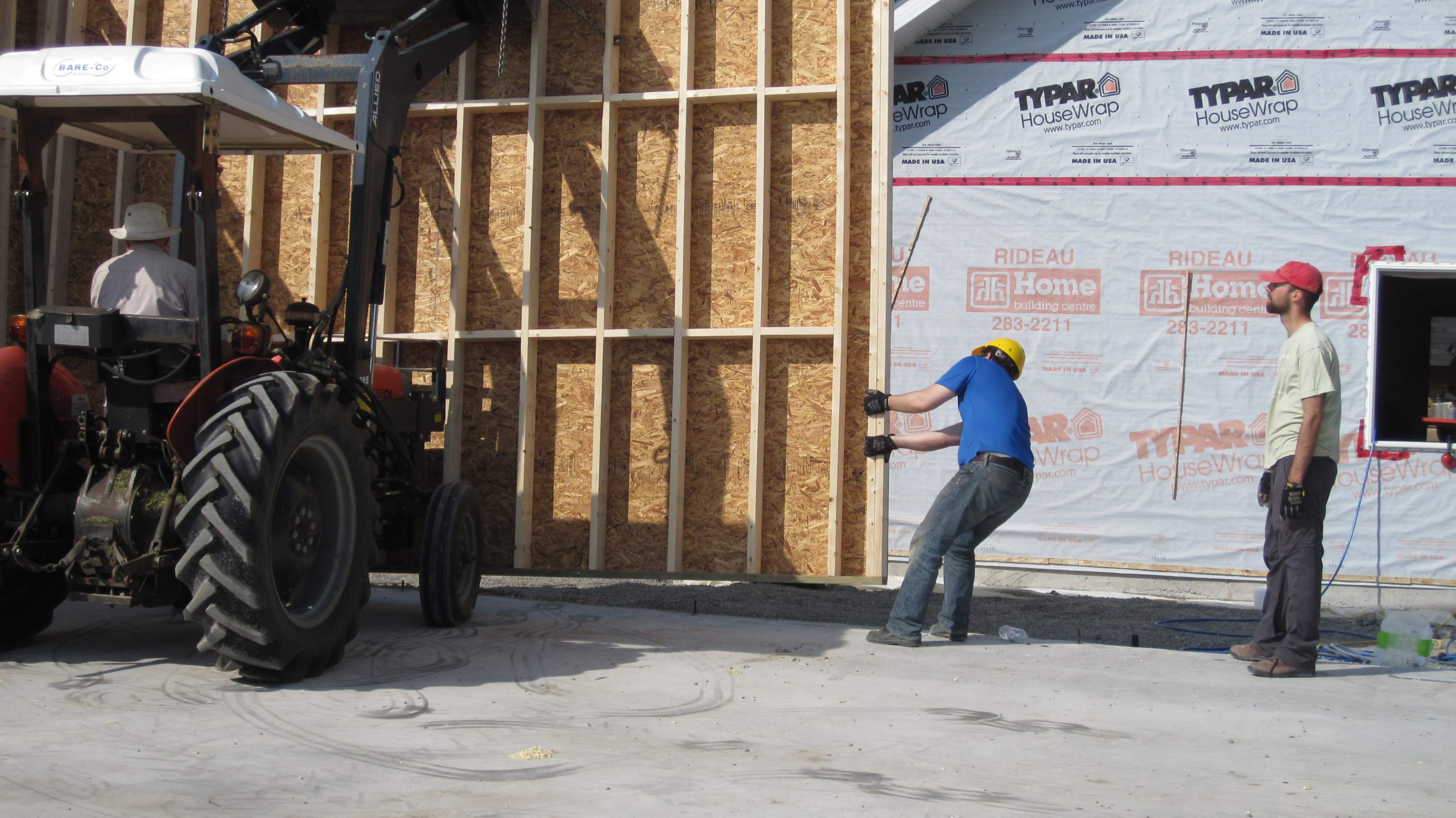

Two more panels went up this afternoon.
