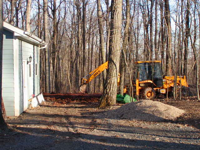

Nothing fancy but know folks like to follow projects and look at pictures so will try to show the progress. This isn't the number one project for the builder so will take some time, we're in no hurry. Besides milling lumber, on Friday, he leveled the area next to my shop where the barn will go, I helped by driving the BX22 over it to help pack down the fill before it rains again- the BX looks like a toy next to his JCB 212 loader.
This shot is looking at where the front of the barn will be, door will be where the bucket of the backhoe is located. Building on the left is my shop.

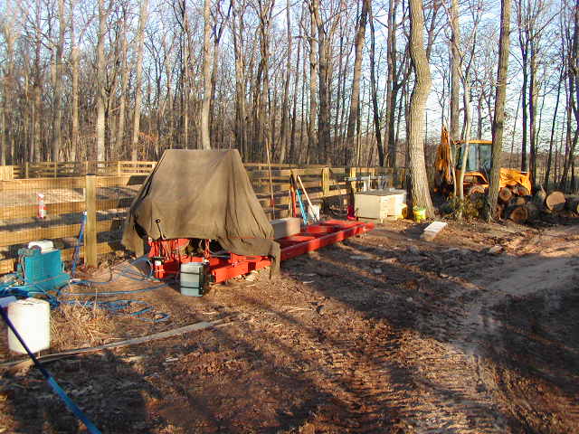

This is the sawing area- thought I had a shot with the mill uncovered but you get the idea! The mill is a Woodmizer LT15, manual band mill, no hydraulics. Have a Bobcat with a log grapple for moving logs that works pretty well. This is the first project with the mill, only 25 hours on it so far and we're learning a lot about it's use. Bill (the builder) has used chainsaw mills before so has helped me learn a lot about opening up logs, etc. We've already had a couple of folks who heard about the mill ask us about sawing up some logs for them- may think about that in the spring to recover part of the cost of the mill?

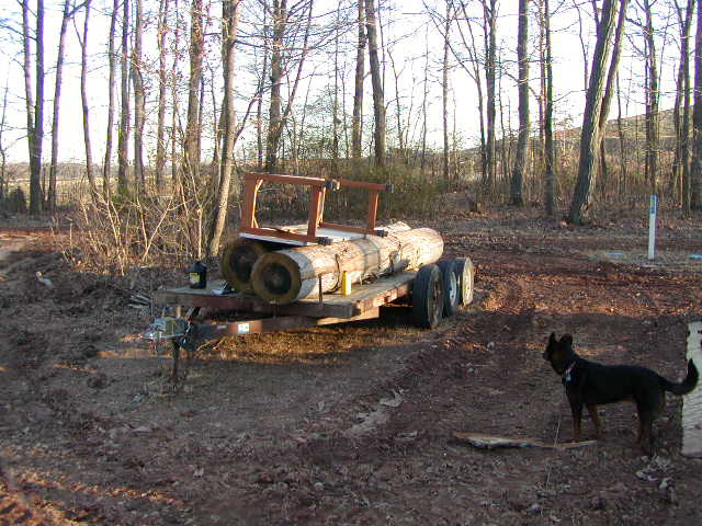

Here's a couple of Cypress logs that Bill has that we plan to cut for lumber- not for use in the barn but we'll use my mill and I'll end up with a fair amount of lumber plus the fun of the cutting! These are about 22" d. and 14' long.

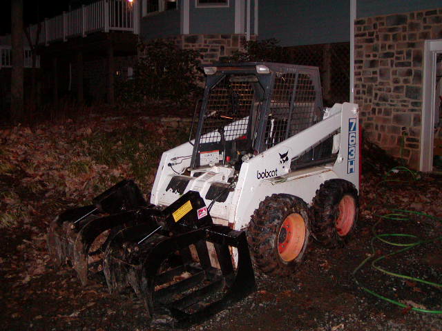

Last picture to get started, this is the Bobcat with the log grapple, a little dark but best I had. This is a 763H, about 1225 hours and has a rated operating capacity of 1500 lbs. but lifts quite a bit more if you're not going very high!

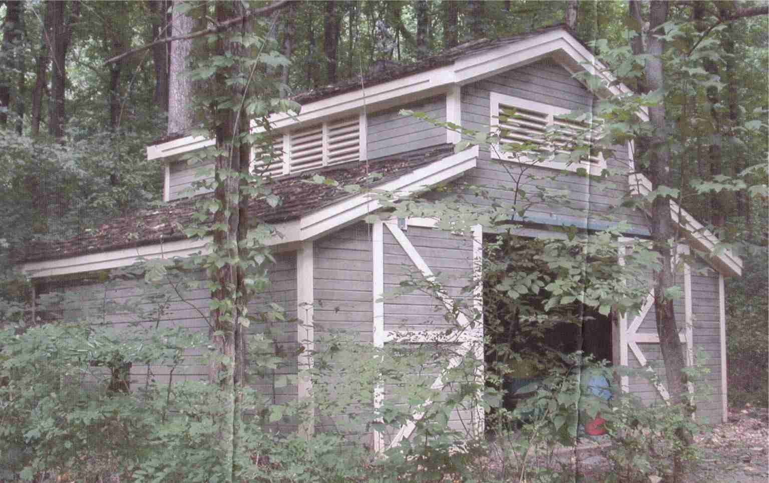

I scanned a picture of another building that Bill had done for someone else, this is what we're going for. /forums/images/graemlins/ooo.gif I think this one is a little bigger than the one we're building which is 20'X24' with a door high enough to get the BX22 in without folding the ROPS.
