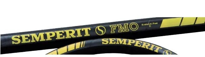

I found a semperit fmo hose (seems to have right spec) and i wil change tomorrow.In the future i have to change 2 very pieces of hose but didn't find the correct diameter.Until then i use a piece of sicilone and one piece is for radiator.This 2 pieces is only for conecting the filter and the hydraulic pump.
