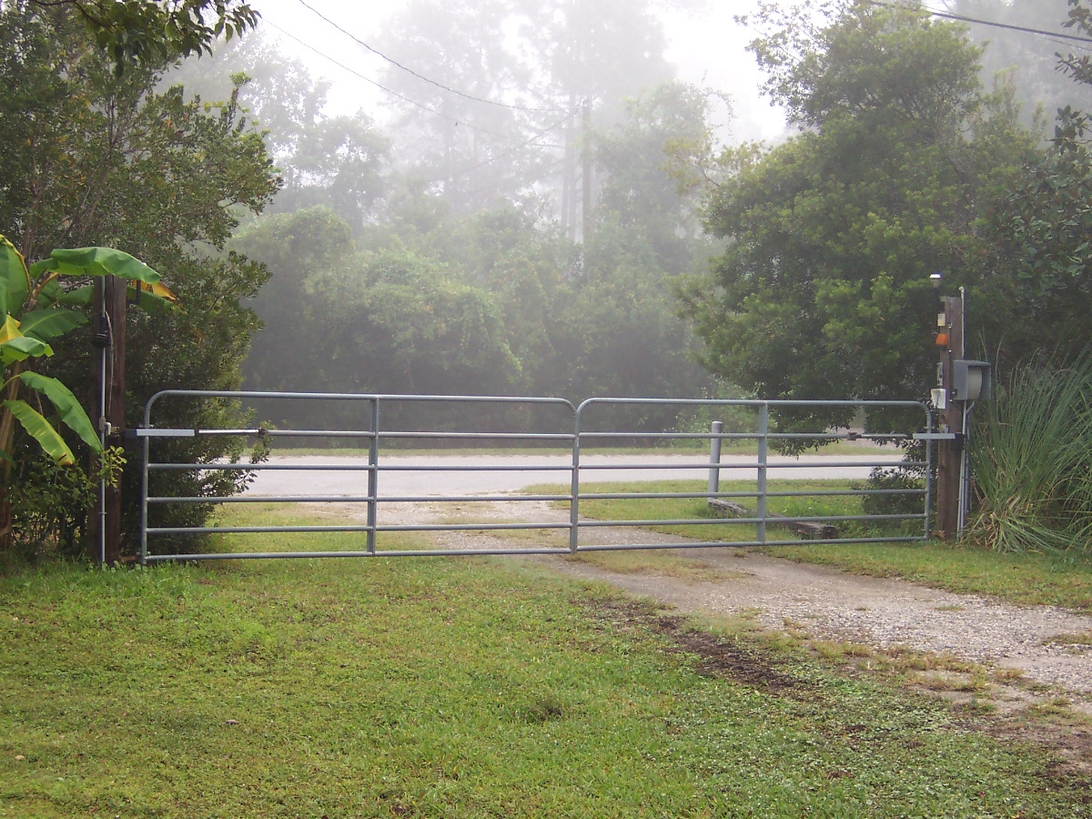

As for sagging, put an 6inch I-beam in a couple yards of concrete, then put few tons of rock around it and you won't have a post moving problem. :D
Mine: 2 ten foot gates.
ry%3D400
   / Entry Gate advice appreciated. #8
I prefer swing gates and the wider the better.
This pic was the gate at my last home. 2 12' gates for 24' opening. The posts are old utility poles set 5' in the ground.
I made the hinge mounts adjustable to keep it even but never had to adjust because the poles were so ridged.
Spend your money on the opener, I had HF that worked great until it lost the codes and I couldn't get them back.
Then went to a Might Mule and it kept messing up so I ended up just opening the gate manually.
Nothing like two trips in and out of your vehicle to come or go!

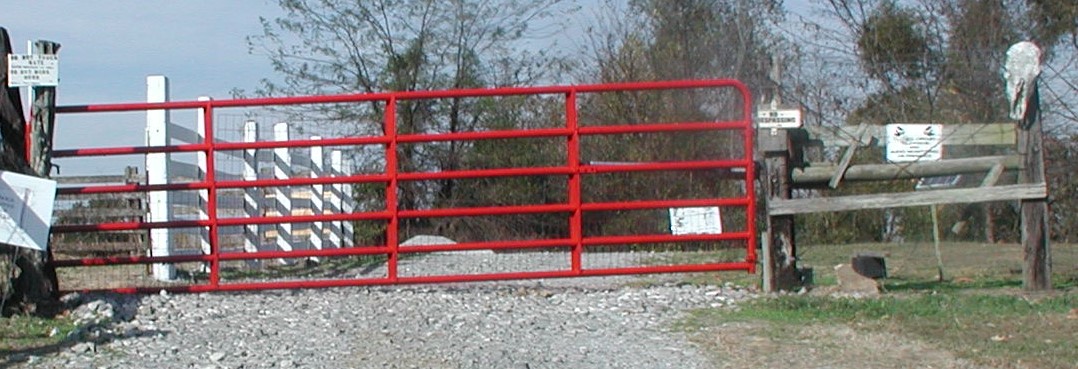

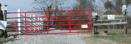

Eddie: I have been using a swing gate for eight years, old RR ties hold it up. Only caution I can tell you is in that time it has been hit twice by guys pulling trailers, requiring adjustments.
