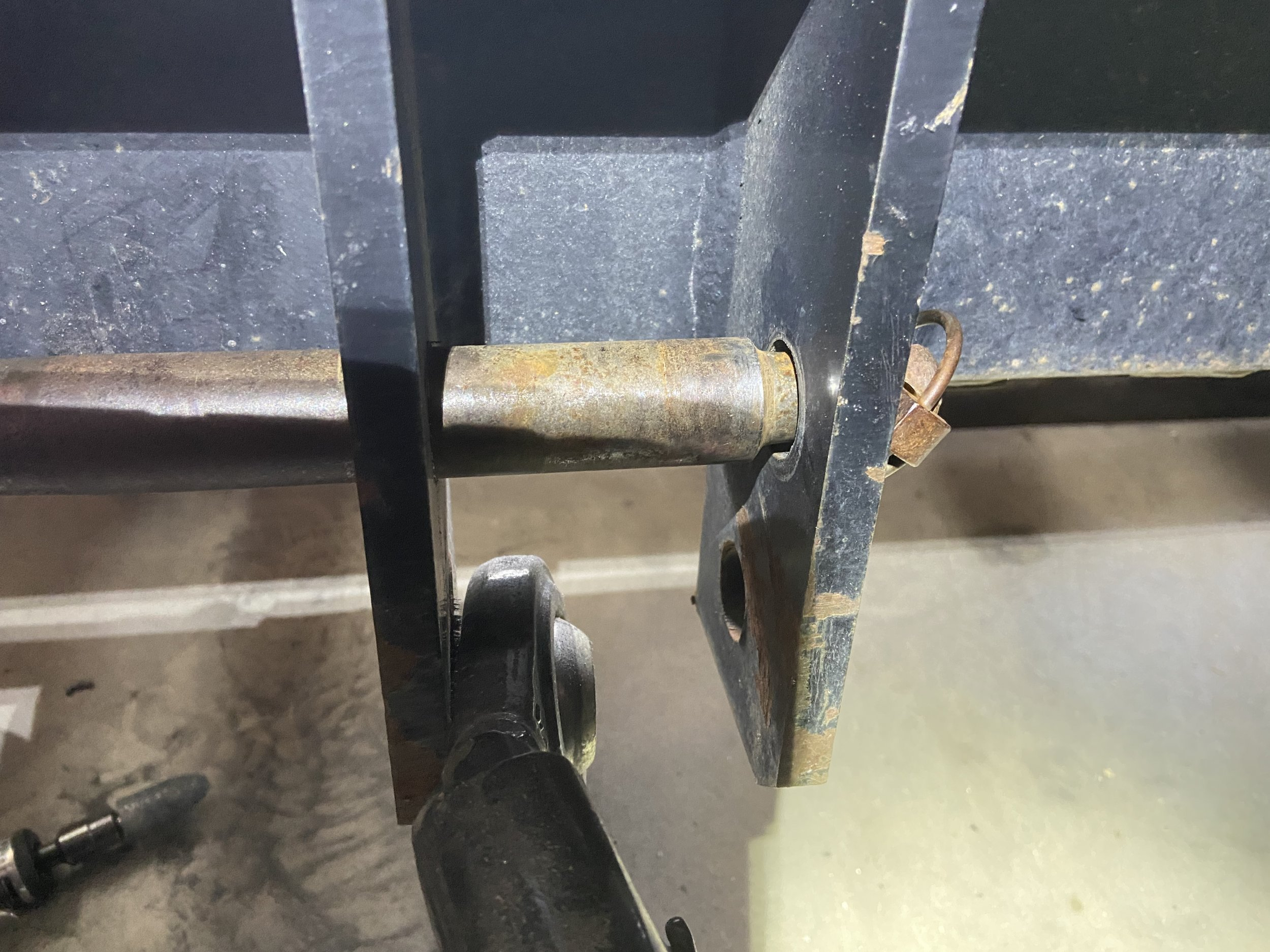

Enlarge category 1 sized holes to accommodate category 2 pins.
   / Enlarge category 1 sized holes to accommodate category 2 pins. #12
Bore the holes out, one of the stepped bits that max's out at 1 1/8" will do a nice job.
I used a stepped bit to start the hole enlargement then used a hole saw to finish on some thick pieces. Worked well.

   / Enlarge category 1 sized holes to accommodate category 2 pins. #14
Or weld on cat 2 ends on the tractor side of things. I'm about to weld a set on a 510 LONG in a few days. Already bought the new ends. Then I'll be cooking with grease.

What if you have a used cat 2 machine that someone already replaced the lift arm ends with cat 1 replacements? Is it okay to put it back to the original cat 2 that it was intended to be? I mean, it already has some junky dirt dobber welds on it as things are now.
   / Enlarge category 1 sized holes to accommodate category 2 pins. #16
Fair Point - but I think that that is the equivalent to restoring to original, rather than modifying / adapting to a new level. Either way, I don't weld etc, so it won't be me. I don't think that would void a warranty though, or push it beyond intended limits. If you have the skill, go for it :)

Warranty? I keep forgetting that some people have new stuff unlike the old stuff I have.
I worked in health and safety before retiring. I understand all too well the mindset you develop in that field. But thankfully I started out being a hardheaded weldor.

So I just enlarged 1 side and used a stepped pin. All about compromises these days :).
