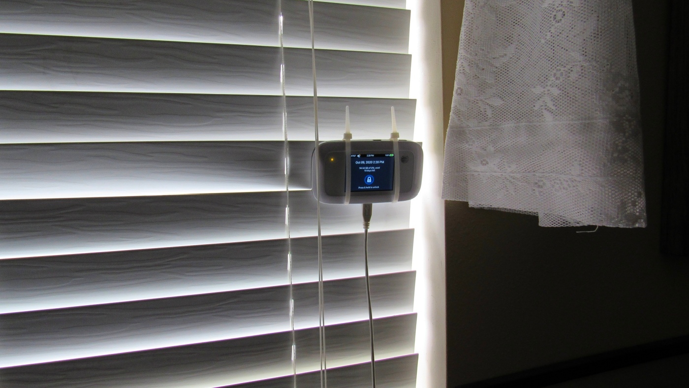

I'll throw my little setup out here again.
ZTE Velocity cellular wifi hotspot. Basically just a cell phone for data only.
GL-AR300EXT travel router.
Router connects wireless to the hotspot. Could connect by cable but I don't see the need. My PC uses the one RJ45 jack and everything else on my home network connects wireless to the router.
Not related to this discussion other than the distance relevance but I have 3 Reolink wifi cameras and a Wyzcam on the network. One of the Reolink cameras is 400 ft out in front and the Wyzcam is on the opposite side of the house about 200 ft away in the barn. All connect through the network on my phone apps.
I have tested the router out to 500 ft and had a signal. I added 9 DBI antennas to the router and one camera that is 400 ft from the house. It worked before with the short antennas they both came with but seems to access a little faster with the longer antennas. Standing at the camera the signal has to go from the camera to the router and back to my phone and movement is almost real time. Very little delay.
I have the Velocity hanging on the window blinds in my computer room.
