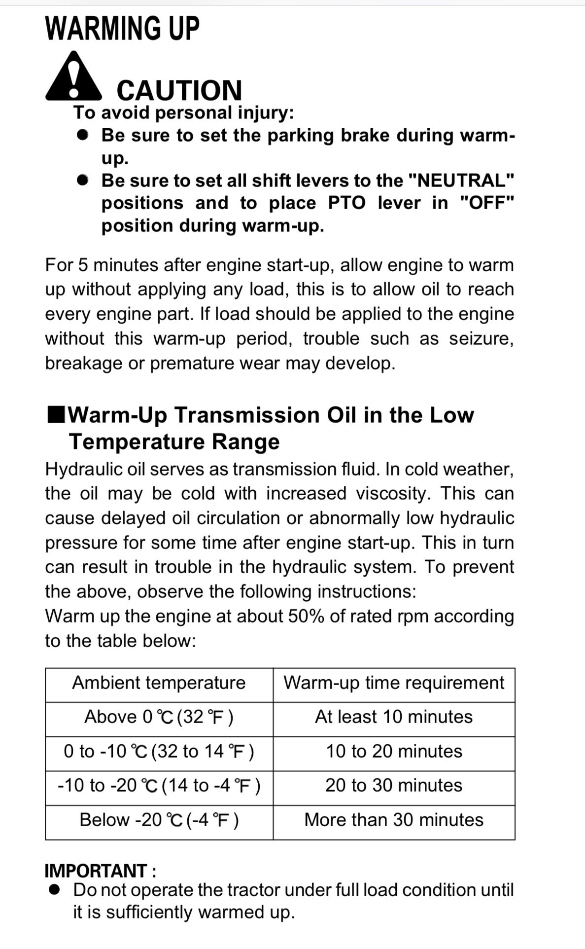

I don't strictly follow the manual's recommendations, but here they are for an L3301 (same as my L4060 and previous L3410) .
HST warmup is likely much more important in even moderate cold temps.

'Above 32F' includes a pretty wide range of temps! Does Kubota seriously feel that tractors should be warmed up for 10 minutes in the summer time?
I usually go with a flexible 'few minutes', as suggested above, but then I'm fairly new to tractor ownership, so have no experience with failures yet. I want to take care of my tractor, but I don't want to rack up unnecessary hours. Taken literally and prescriptively, it could add a couple hours per week.
I hear you... I believe the intent of the HST warmup chart is AT 32 deg f the machine should warmup for 10 minutes. I know it says something different. I generally idle for maybe 30 seconds, move the machine outside, then run it at 50% (1500rpm) for another few minutes in anything above freezing.
