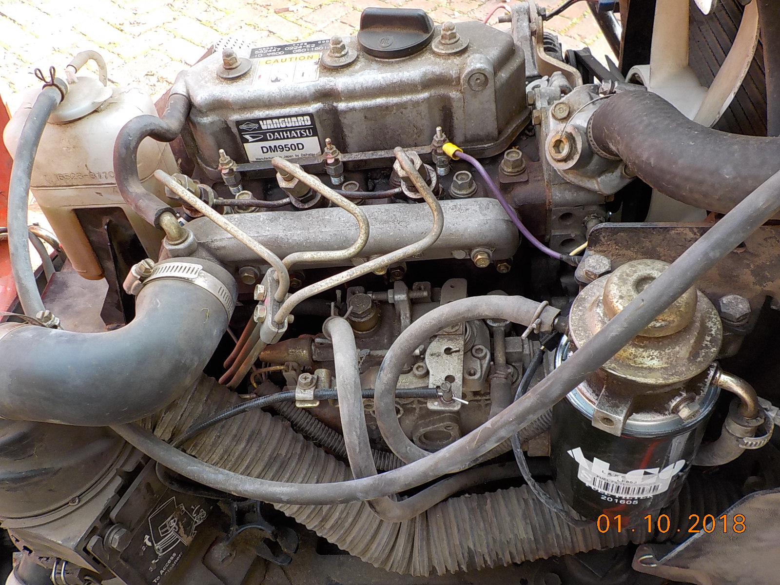

It's a diesle and injectors. It doesn't appear to be isolated to 1 cylinder. I cracked open each fuel line to the individual cylinders and it had the same loss each time. So I assume that's a fair way of proving that it's not a single cylinder?
/ Engine runs great when cold, but really rough when hot

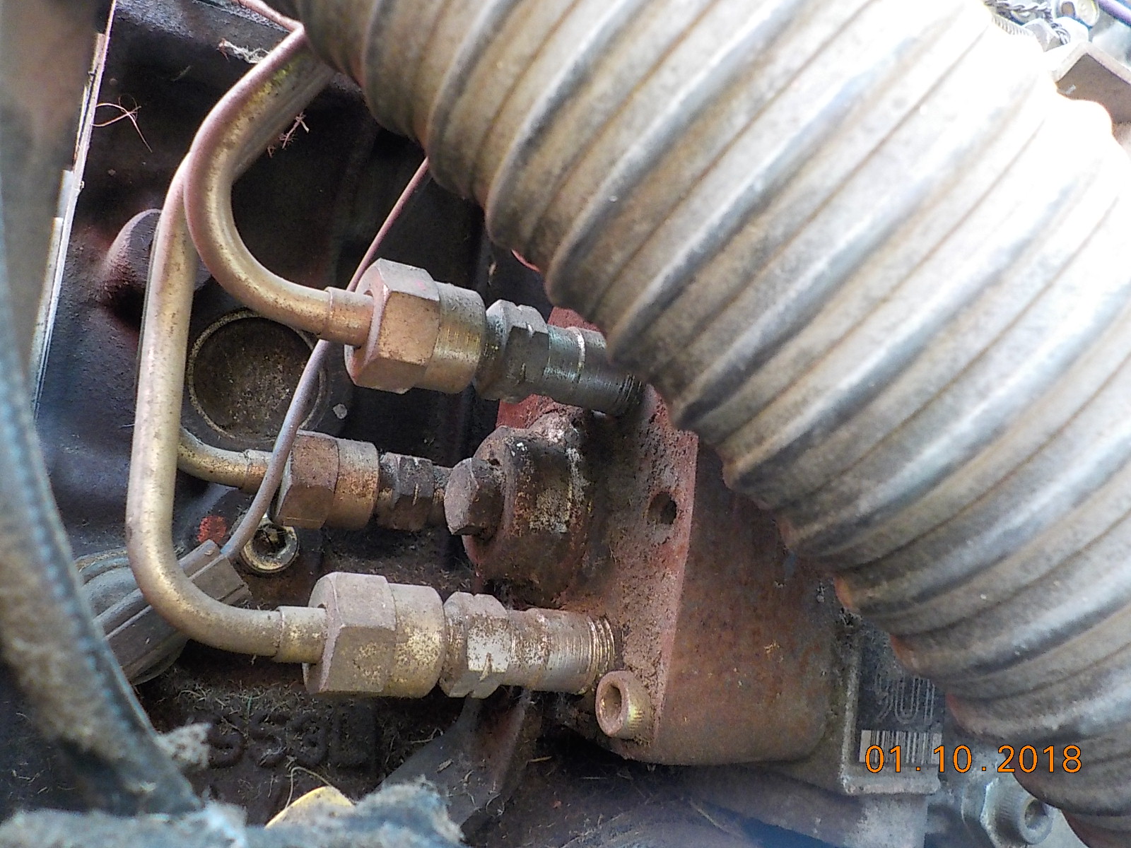

Here's a couple of images: DSCN5231.JPGDSCN5232.JPG
The image on the left where you can see the three connections comming out of the housing. I presume that's the fuel pump? Is the bolt in the middle a bleed bolt?
The image on the right from above shows the three pipes going into the injectors.
Should/can I undo/loosen the centre bolt to bleed the whole system?

Would the fuel bleeding bolt be one of the banjo bolts on top of the pump? (fuel inlet or the one to the left?)
