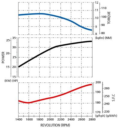

Not entirely true. Here is the power and torque graph for the Kukje/Cummins A1700 on my tractor. The 540 RPM on the PTO is around 2500 engine RPM when the HP maxes out. While the 540E is around 1900 engine RPM, right at the torque peak.

Tractor designers often aim for "torque rise" (sometimes called torque backup). That's where as the RPMS drop from the operating RPMS, torque rises. That makes the tractor hold RPMS better under load and be less likely to stall. Obviously torque can't rise too much or over to far an RPM drop. But since it's often the case that tuning for good torque at low RPMS will naturally result in torque peaking at lower RPM than the mechanical redline or the HP peak, it's common to have torque rise.

The governor on the fuel system, either electronic or old style mechanical systems pulls back fuel delivery above rated speed of the engine. High idle, ie max unloaded engine rpm, unloaded is anywhere from 3% to 10% above the speed that the engine produces max power. The governor / power curve above rated is called the overrun curve.
Stationary engines, for example genset engines have a very steep overrun curve, sometimes using an isochronous governor strategy.
Road vehicles usually have broader regulation curves for driveability reasons, ie hitting the governor at shift points is like hitting a wall, as power drops off seemingly instantaneously with a “tight” governor.
Torque rise is defined as the increase in torque output as the engine is lugged down from rated speed/ max power. 15% is a descent torque rise target. You sometimes hear reference to “constant power” lug curves. Extremely high torque rise settings effectively result in constant power as the engine speed decreases.
It’s all math.
