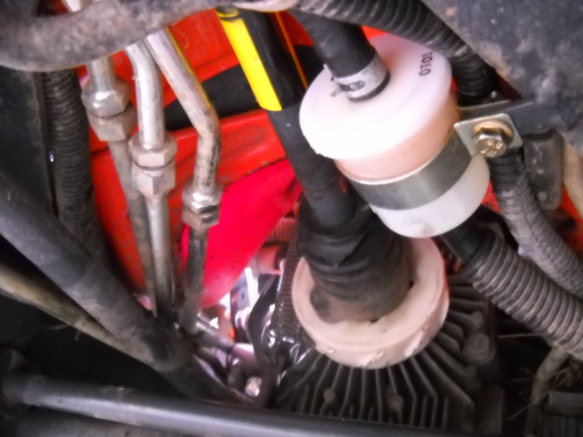

The BX tractors have 2 fuel filters, 1 underneath the operator platform and one under the hood. My neighbor's BX had the same problem, I replaced the fuel filter under the operators platform and it has run great ever since. :thumbsup: I have attached a picture of the filter, you also may notice the transmission cooling fan is missing it's fins. :ashamed:

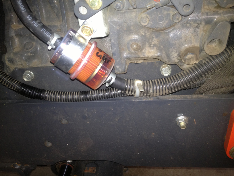

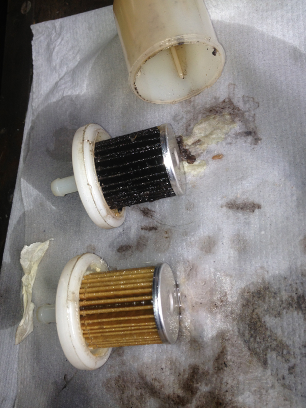

I changed the filters, the one bellow the middle is really dirty!, other next to the engine seems ok. I installed a clearer type, so it's easier to see the contamination.
Engine is running fine again!
