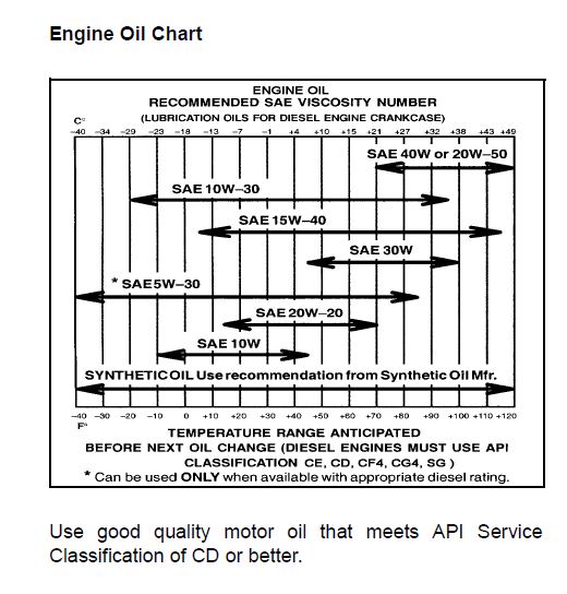

Here is the Bobcat engine oil chart from the Operator manual.
   / Engine Oil Viscosity CT225/230/235
SSdoxie
Thanks for the oil chart. Seems like the Bobcat oil recommendation chart is more realistic then the written information in the Kioti CK Manual. One dealer I talked with said he felt the Kioti Manual was either a bad translation or a mistake.
