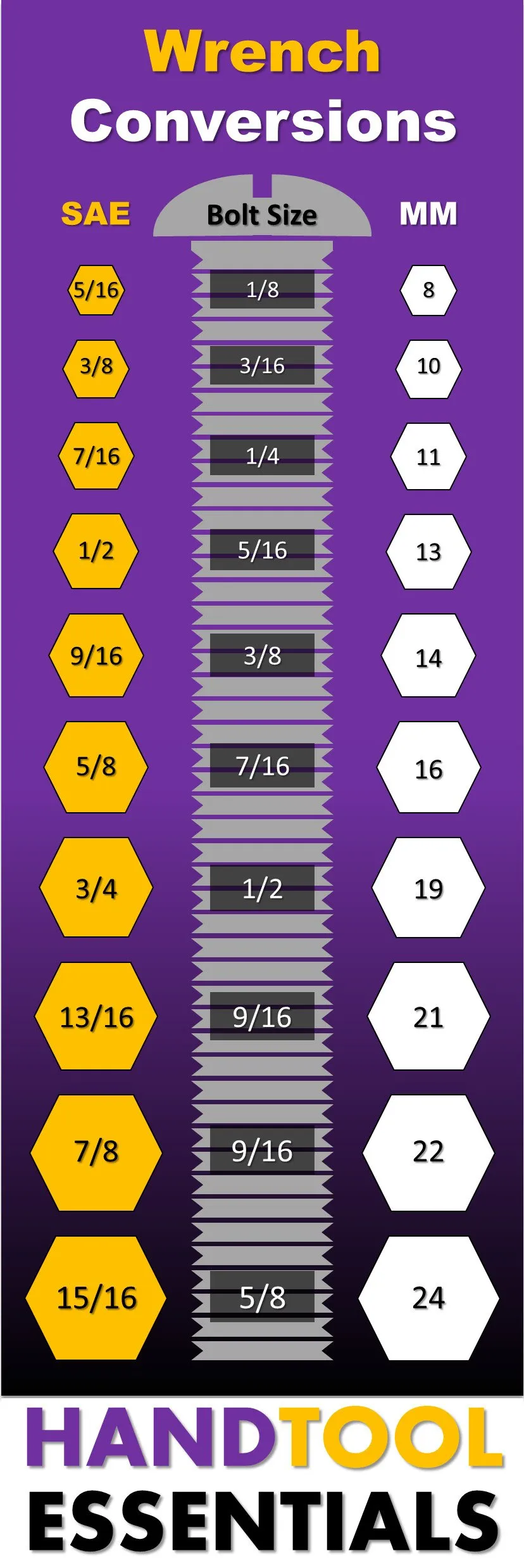

Might come to that. Didn't want to drive 140 miles to my land and find my limited stock of metric wrenches don't fit.
Many metric wrenches have a corresponding SAE size.
Not sure I'd use vise grips or channel locks unless I absolutely had to. I'd probably put it off until I had the right wrench/socket.
YMMV
