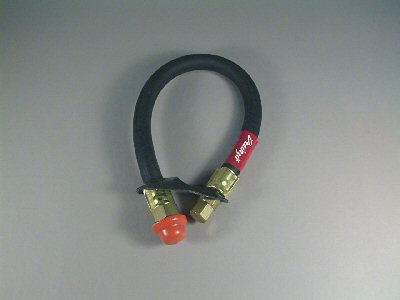

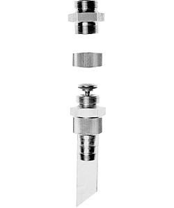

Someone makes an adapter that screws in the oil drain hole. It looks like a small hose assembly that screws in the oil drain hole, and has an oil drain release at the other end. The Kohler on my Dixie Chopper has one on it, and lets you drain the old oil very easy. I would think any small engine shop would have this unit. You can also make one with a rubber hose and a bolt in the end with a clamp around it .
/ engine oil change #10
And here it is.

I have one of the vacuum bottle and when i tried it on my hand push mower it took more time and effort than it was worth. JJ's picture looks like something that i get or make and will try next time i have to change the engine oil. thanks everyone.
