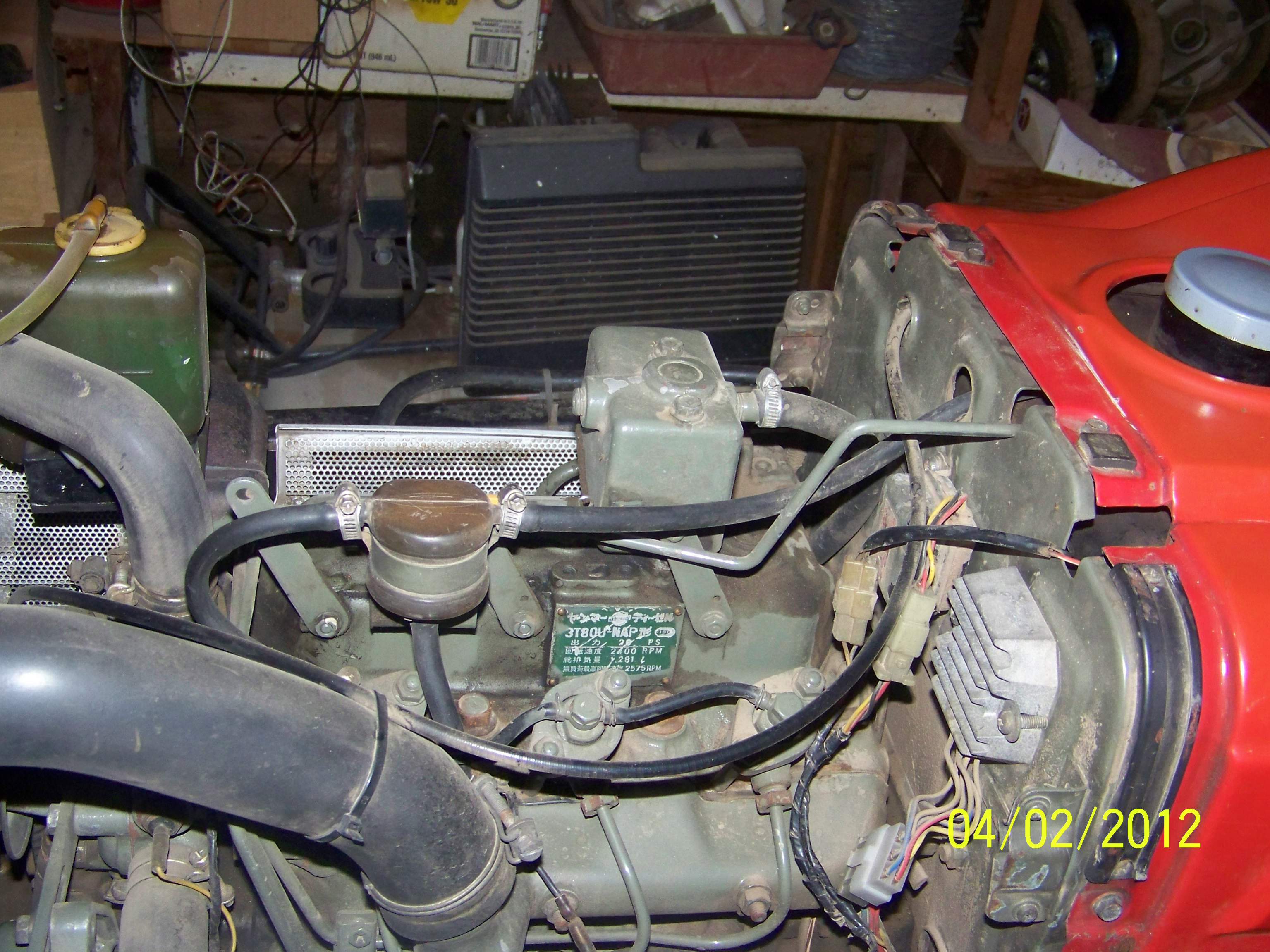

Yanmar Tractor Parts BODY BREATHER 00
I have never seen a YM1802, but does the valve cover vent look like this? If so I would assume it works just like a pcv valve on your car. A check valve allows air out but not in. I would check/clean as necessary. If check valve rattles it should be good. Older Yanmars do not have this.
/ Engine oil blow by #20
This is what the breather on an 1802 looks like. Note the rectangular box with the hose coming off. Word play on rocker arm cover or crankcase vent, one and the same.
After going back and looking at the 1802/2002 parts list it does show one like you posted Normde.
