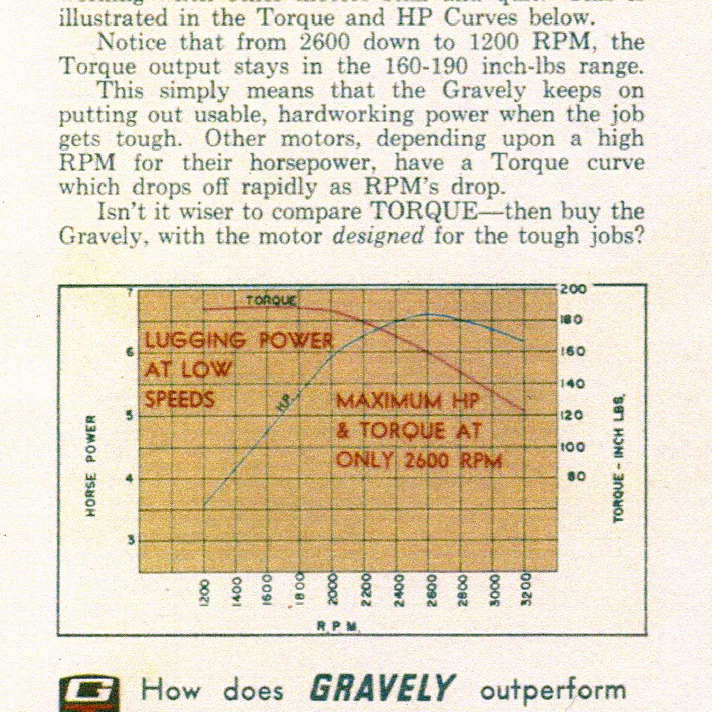

Hi Bruce! I look info. for the Gx 390 Honda. This Gas engine is the best you can find. VERY POWERFUL and Very good fuel Economy as 230 Grams per H.P. hour . Or 3.7 L at Max HP hour. For torque the best is 2500 RPM . You cannot use a Honda engine below 2000 rpm. Torque drop a lot at 3600 rpm. I join a Curve Chart. Note It is a NET Torque and NET Hp Not the Max (not true) as usual. Me I like the new L100v Yanmar Diesel (I dont Have now). Fuel economy is VERY LOW as 165 Grams per HP hour . Thanks for the website. Good luck ! Oldmech
  • gx390honda.pdf
/ Engine ideas #78
Sorry I get a bad file. Now The good one. Thank ! Oldmech
