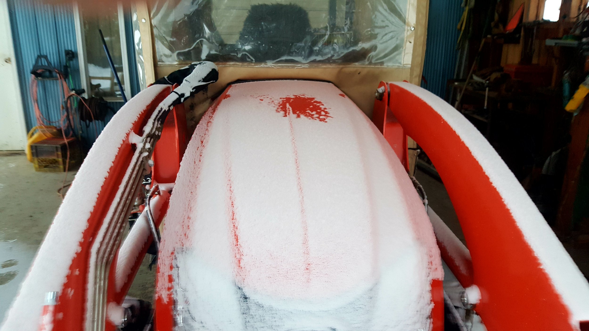

   / Engine Block Heaters #26
-18 wind blowing snow right at my tractor under cover. Couldn't believe my eyes this morning when the snow was melted on the hood from my circulating heater.

i built my lean to onto my shop so my tractor didnt have to sit out in the weather. actually, the sun beating down on it might be worse than the snow and cold. i still use a block heatrer, but i use 3 silicon pads. 2 on engine oil housing ( driveshaft splits housing) and one on hydraulic storage tank carried on 3 point hitch for snowblower. these pads are set on wall timer, which i engage on days when snow is expected. it runs for a few hours in the morning so its nice and warm prior to use.
