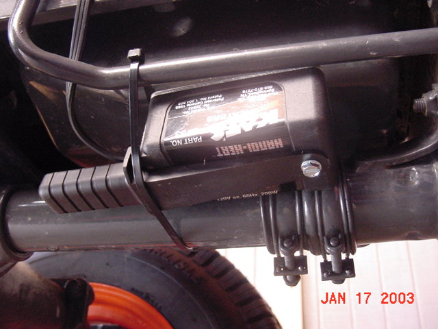

There has been alot of discussion on this subject here, with many different opionons. I installed a magnetic heater on the oil pan of my 7500. I got it at TSC for around $21. It's worked well so far and can be removed anytime. Check it out.
