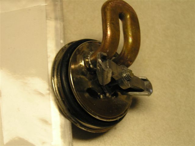

Outlander, I think that is the right number for the plug. I just called Wilson's and it was shipped on Thursday so I should have it Monday. Thanks for the link, I didn't realize the diagrams were on line. Wallace I'll definitely dope up the sides of the freeze plug. I think I have the copper impregnated type gasket shellac and I think that should work ok.

Go to your tractor dealer or TSC and see if they have a thicker o-ring. There are several different thicknesses available.

JerryG. Wrong part of the country for TSC stores. There may be some in southern New England but not up here that I know of. As far as a thicker o-ring that would probably work but I ran into so much trouble just trying to find a freeze plug I don't think I will start another scavenger hunt right now. I'm going to try and attach a photo of the heater and o-ring but not sure if will show up very well. The oring is as far as I can tell is 44.5MM the hole is 45 I think.
