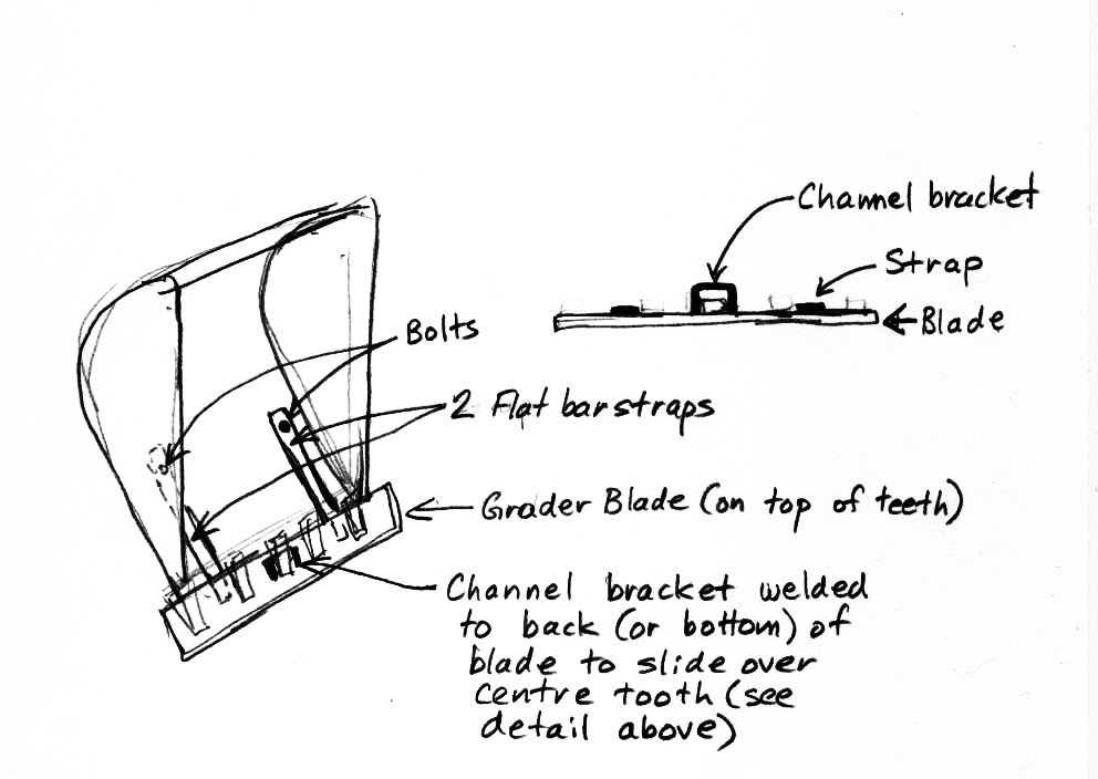

When I had my Ford 4500 backhoe/loader, I rigged up a similar blade that was easily removable. I used a piece of discarded grader blade that was the same width as the bucket (24") and welded a channel to the back of it that slipped over the centre tooth. I also had 2 flat bar straps welded to the blade that lay inside the bucket on either side of the centre tooth. I drilled holes in these straps and in the bucket bottom to match, so that two 1/2" x 1-1/2" bolts kept the blade attached to the bucket, but could be easily removed. I used this for many years. It was real handy for levelling backfills and for snow removal from walkways and other hard-to-get-at places. I was always going to rig up something wider (maybe 48") but I never got a round tuit.:rolleyes:
Do you have any pictures of this or a sketch?

BobRip...The tractor and the grader blade are long gone from these parts and I don't have a picture. Here is feeble attempt at a sketch of how I did it. The straps look straight in the sketch, but they actually had a "Z" kink in them to fit from the bottom (or back) of the grader blade to the inside of the bucket. Hope this helps.
Thanks for the sketch. It is very helpful. Sorry to cause you so much effort.
Did you actually drill holes in the bucket? Did this cause any dirt leakage or digging problems.
Yes, I drilled two 1/2" holes in the bucket. There were no problems with leakage or digging.
Harry c and crazyal have a good idea if you have bolt-on teeth (I didn't). Just weld the blade to a tooth or teeth and bolt onto the bucket as required. If I were doing that, I think I would weld to just the centre tooth to avoid alignment difficulties when installing.
