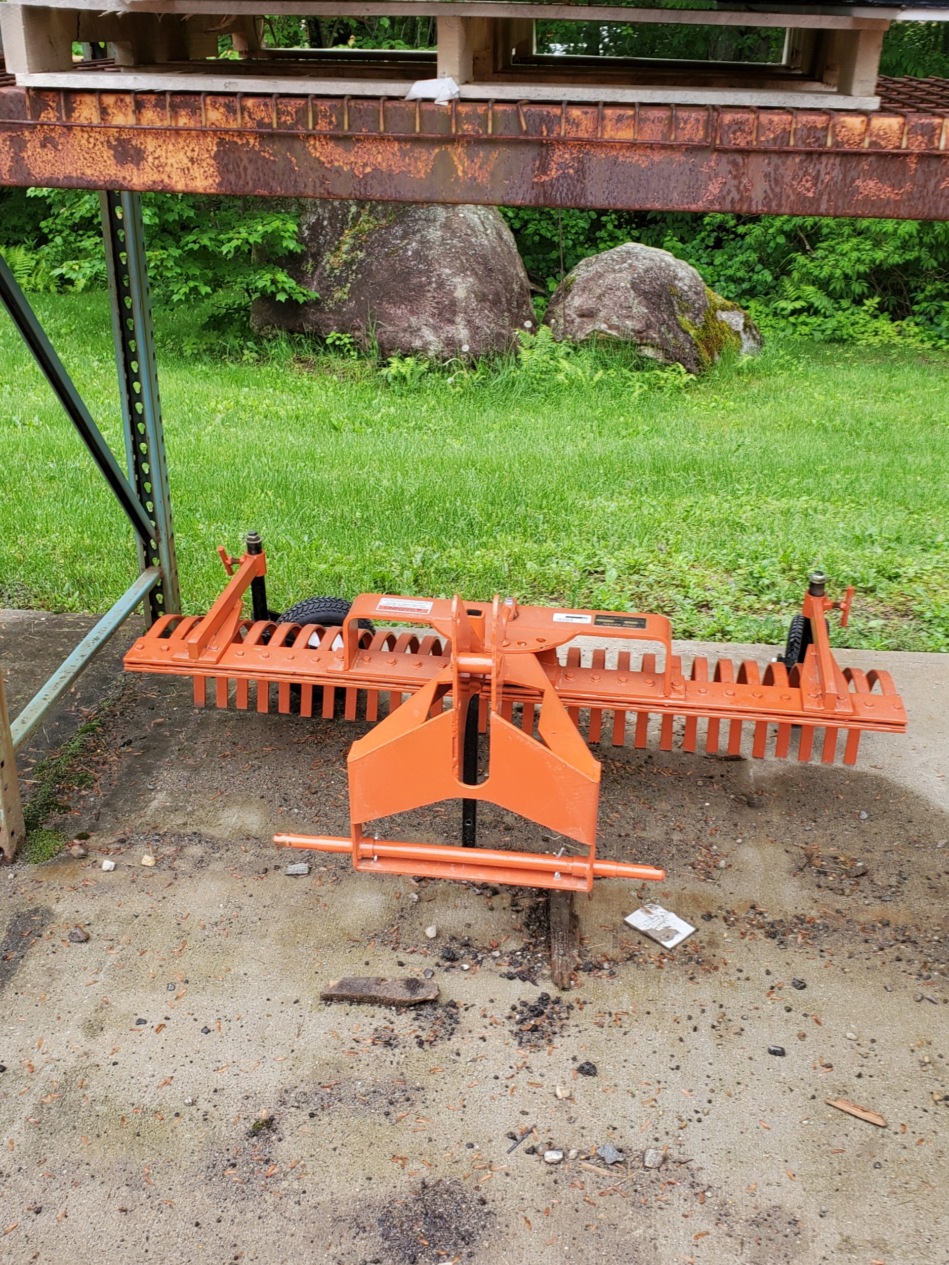

I have an Emax 20S HST and I’m looking for a York Rake that will work with my tractor. I got a price from a Mahindra Dealer (5' York rake model RS5 in stock for $1350. This seem high to me… any comments?

Titan attachments has a 5' for $650. Back ordered until end of July.
/ Emax 20S York Rake #3
Landscape Rakes are ground contact tools where weight per unit of width is the key metric, followed by rake tine strength and tine resilience. How much does quoted $1,350 rake weigh? Will it come with gauge wheels?
Heavy rakes will accomplish most grading tasks in two passes.
Light rakes may require six passes.

COMPS: https://www.everythingattachments.com/Compact-Tractor-Landscape-Rake-p/eta-cmp-lr.htm
Item#Item NameOur PriceQtyAdd
ETA-CMP-LR-60Everything Attachments Compact Landscape Rake 60$1,348.83
ETA-CMP-LR-72Everything Attachments Compact Landscape Rake 72$1,424.26
ETA-CMP-LR-84Everything Attachments Compact Landscape Rake 84$1,490.58
60 inch weighs 245 lbs. 72 inch weighs 265 lbs. and 84 inch weighs 285 lbs.
/ Emax 20S York Rake #4
I see your tractor's ground clearance is only 8.3".
Most rakes are designed for tractors with 12" to 14" of ground clearance.
Caveat emptor.
