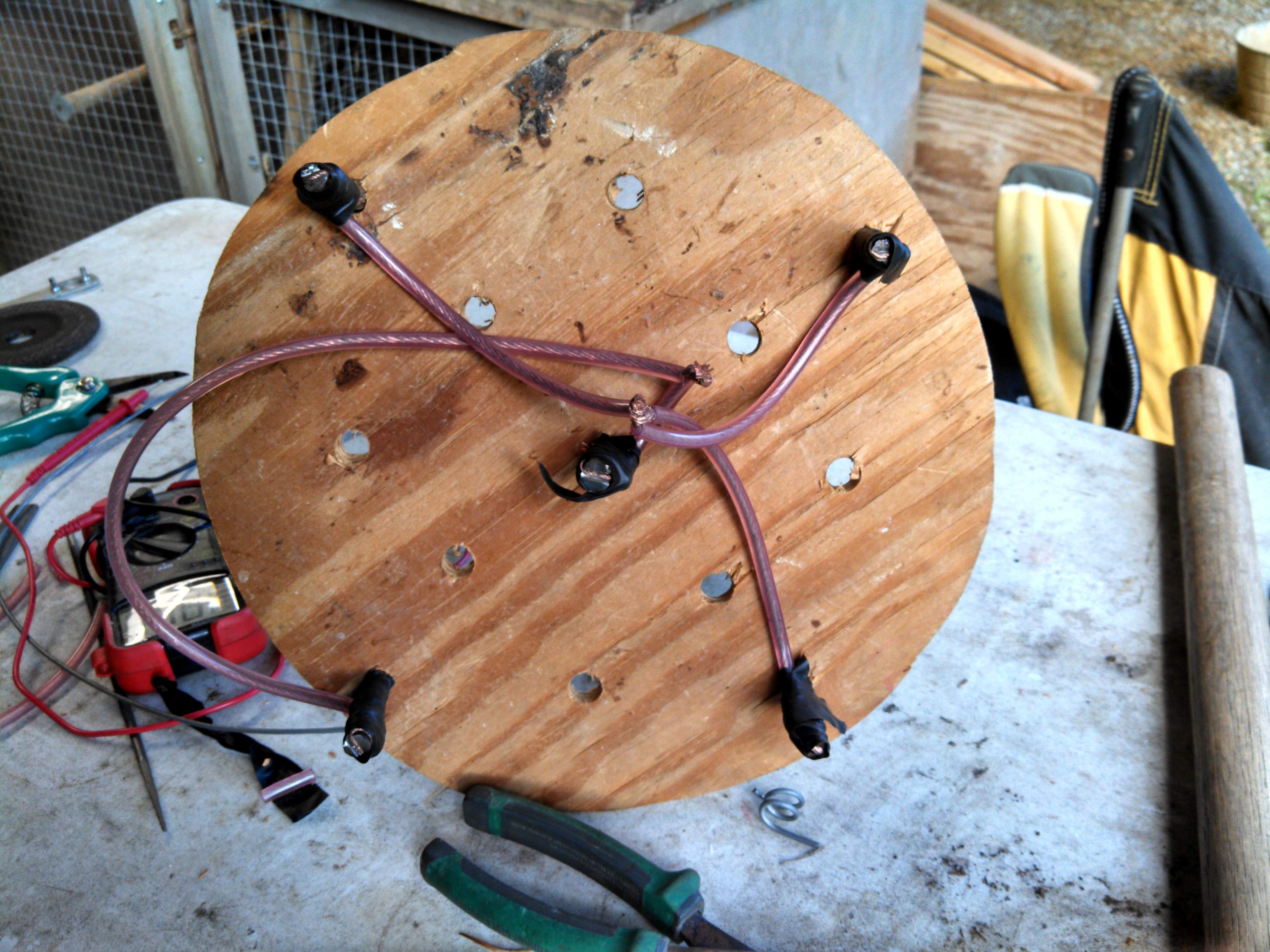

I decided to build a stick electrode caddy out of a piece of 4" pipe that's been sitting out behind my barn since I moved in here (and probably longer). One problem: how to clean the rust out of the inside of the pipe. A wiser person would have just bought a clean piece of pipe and gone from there, but I'm not one to do something efficiently if I can do it in some cobbled-together way that involves not leaving the house or spending any (more) money. I realized that electrolytic rust removal would be perfect for this job.
In case you're not familiar, electrolytic rust removal is basically the opposite of electro-plating, at least that's how I see it. Instead of plating the surface of the metal with another metal, you cause the rust to migrate off of the metal. You can read more about the process here: ELECTROLYTIC RUST REMOVAL (ELECTROLYSIS)

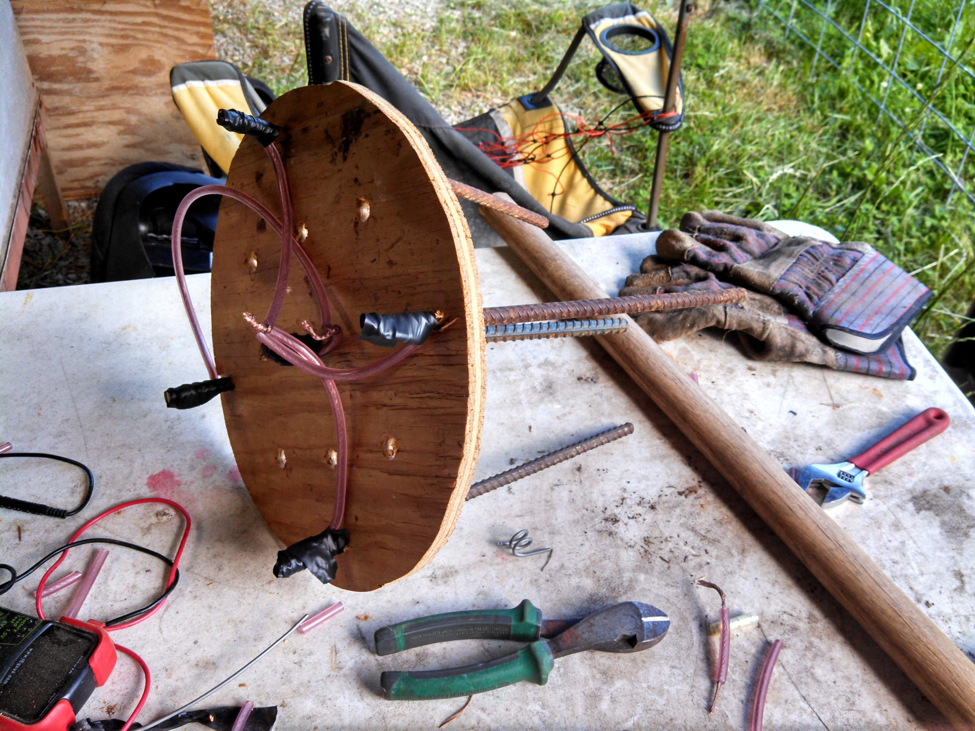

Lid of the bucket, holding the rebar in place. A rebar is in the center as well, to clean the inside of the tube.

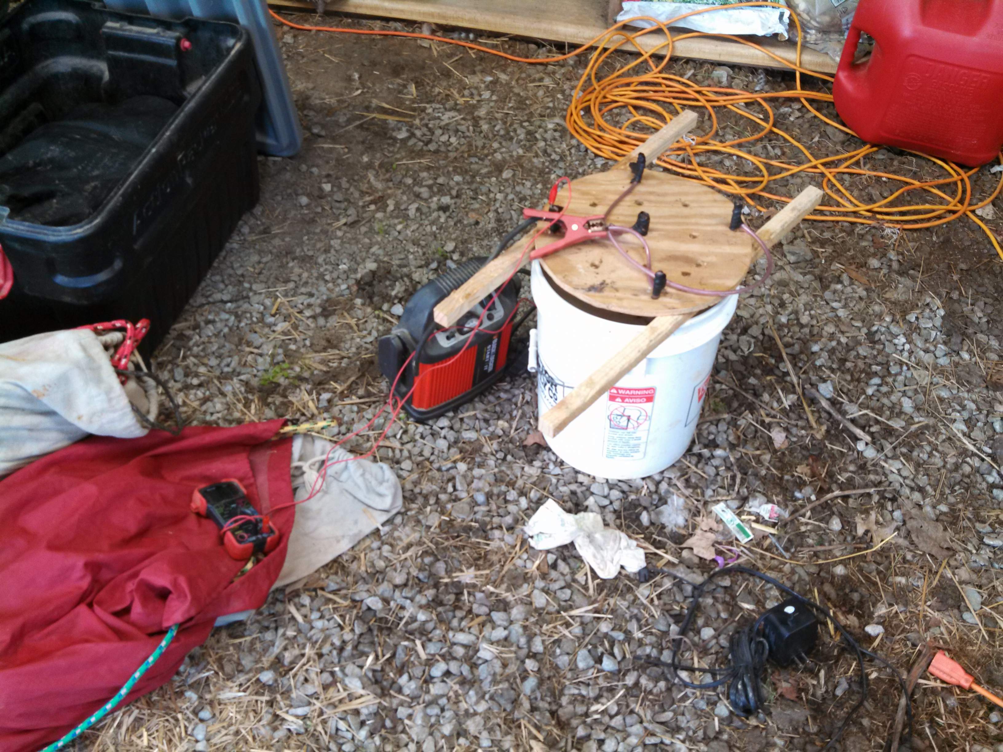

Wired up together using 12 ga speaker wire.

The whole process simmering away.

I couldn't get my battery charger to work, because it's smart and it won't charge if it doesn't detect a battery, so I hooked the whole thing up to a 12 volt battery instead. I measured the current at 2 amps, which seemed safe enough. There is no fuse, though, so if something should accidentally touch and short, the battery could be damaged, but I think that's about the worst I have to worry about.

... oh, PS, I read that I could put a 12 volt bulb in series with the circuit to keep current down and provide a fuse and safety against a short. If anybody was going to do this, that'd probably be a good idea.

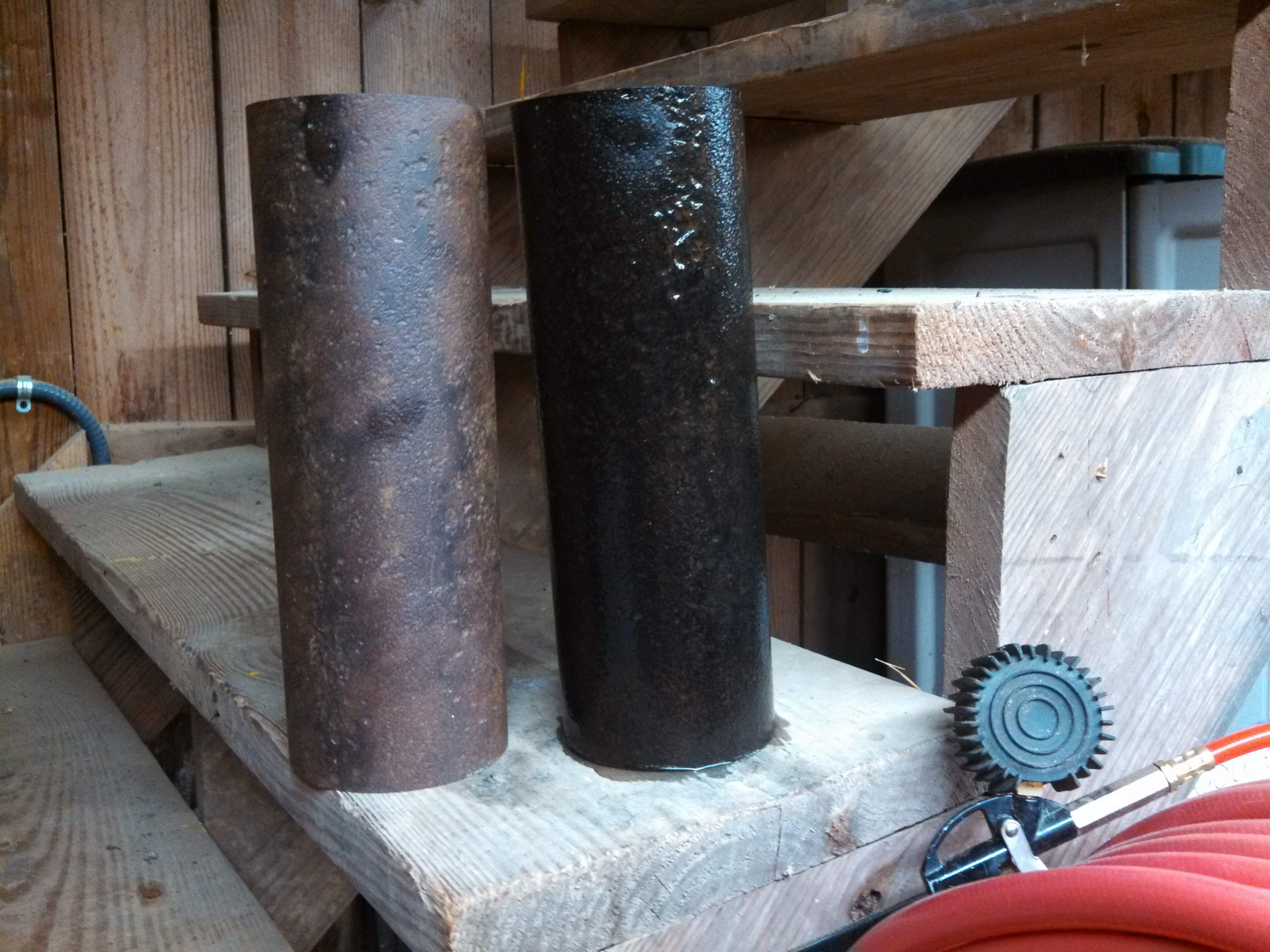

Okay, here's a "before" and "after". Both of them had been brushed with a wire wheel to remove the worst of the rust. I think the result is pretty dramatic!
I do confess that the difference is a bit exaggerated by the fact that the clean one is still wet, but literally within minutes of removing it from the bath, it had developed a patina of surface rust that made the difference between them harder to see. The real difference is on the inside, which hadn't been brushed at all. What used to be a thick coat of rust turned into a thin black sludge that easily wiped off with a rag. Is it spotless clean? No. But it's plenty clean enough to spray "rusty metal" primer on and slap a coat of paint on. This ain't automotive body-work, you know?

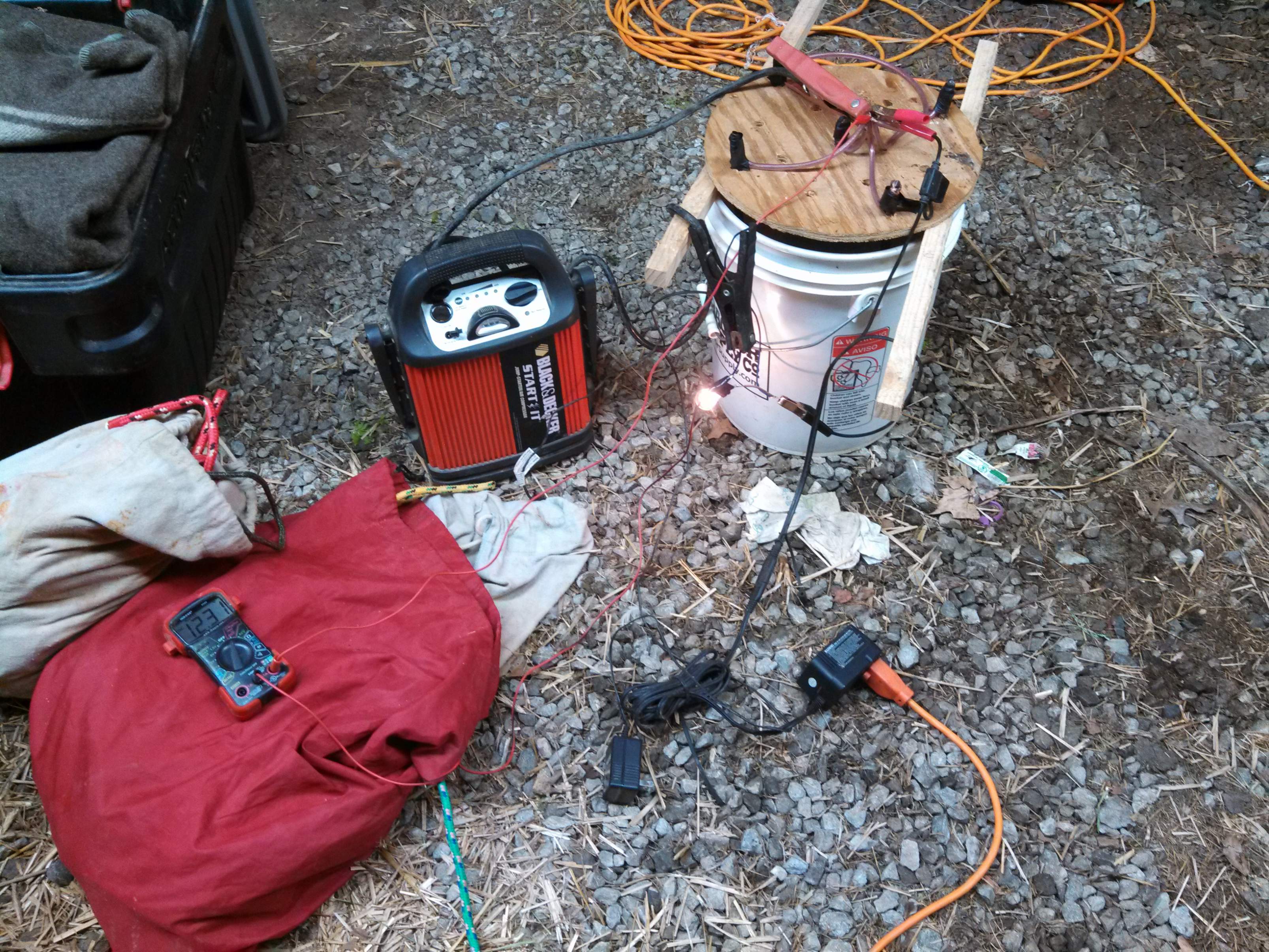

Mark 2.0. I have a 12-volt tail-light in series, to act as a resistor and rudimentary fuse. I also realized that I could just plug the battery charger in parallel, and it would detect the battery and help keep it topped off as it ran the circuit. The circuit is drawing about 1.5 amps, whereas the charger only puts out 0.75 amps, so it won't exactly keep up, but it should help.

Well, the job is done. I got tired of worrying about discharging the battery too much and then waiting for it to recharge, so I dug through my junk pile and found an old 12 volt transformer from some long-forgotten piece of electronics. It was only rated for 1 amp, but I figured it was worth it to sacrifice it to the cause, so after checking everything out with a multimeter, I hooked it up and let it run. A couple of hours later, the transformer was toast and the second piece was clean. If you're going to do something like this, a power source with adjustable voltage and current would be really nice.
