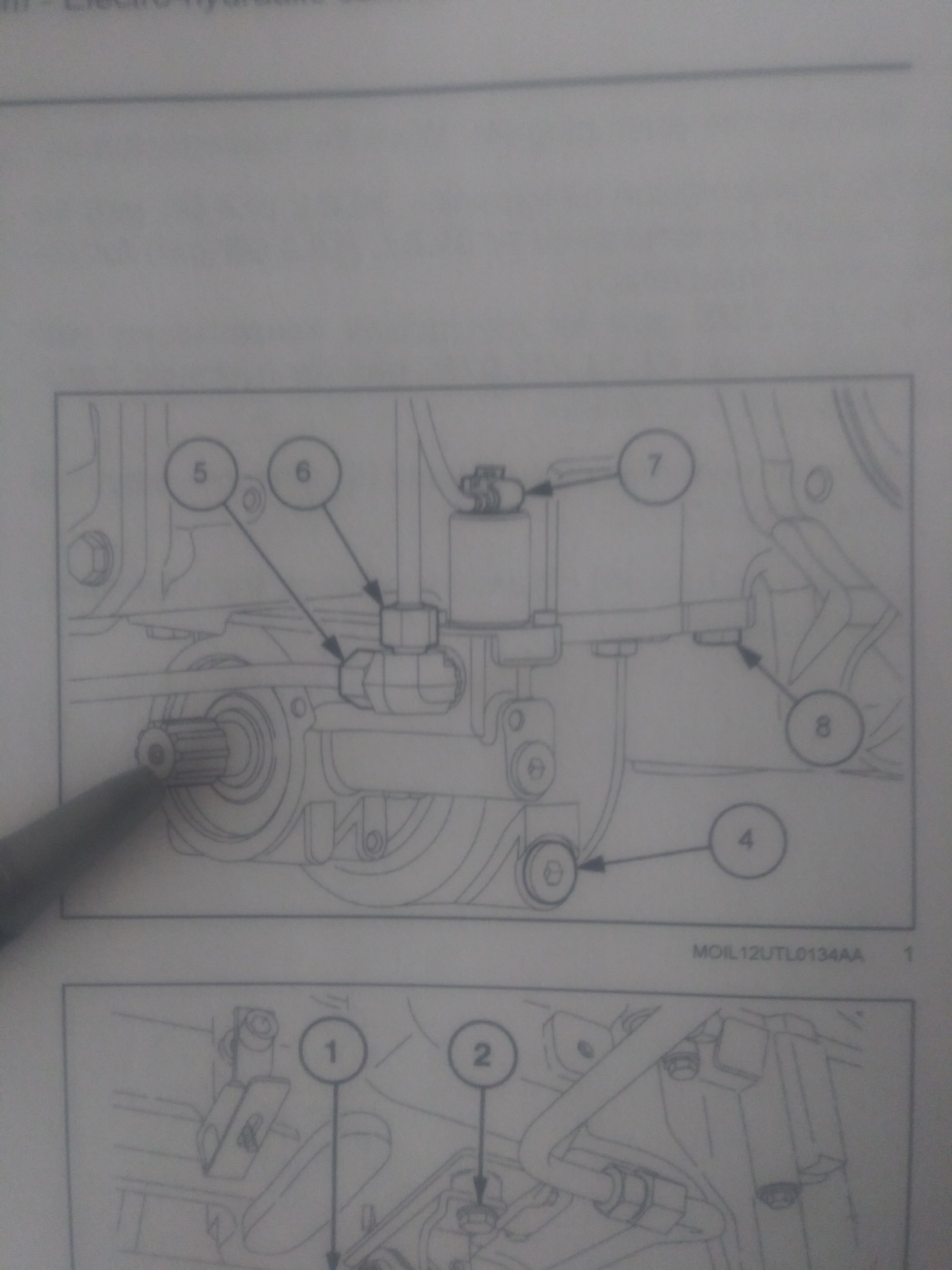

Would anyone be able to tell me if there should be slop at the point my finger is at. The problem i am having is when my brakes 5release 4x4 i will get a loud clunking back there this is a caseih 75c thanks

   / Electro hydraulic
Should see a pointer now

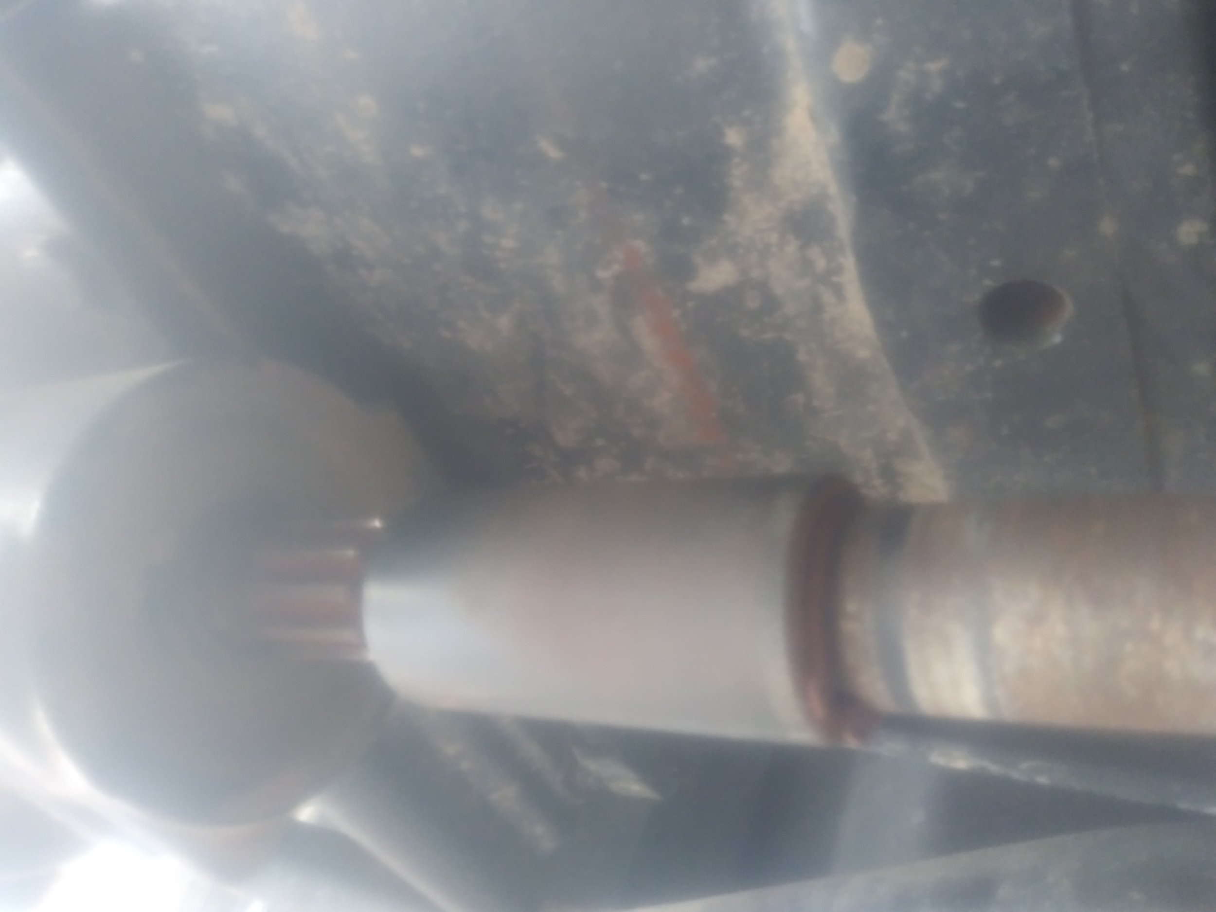

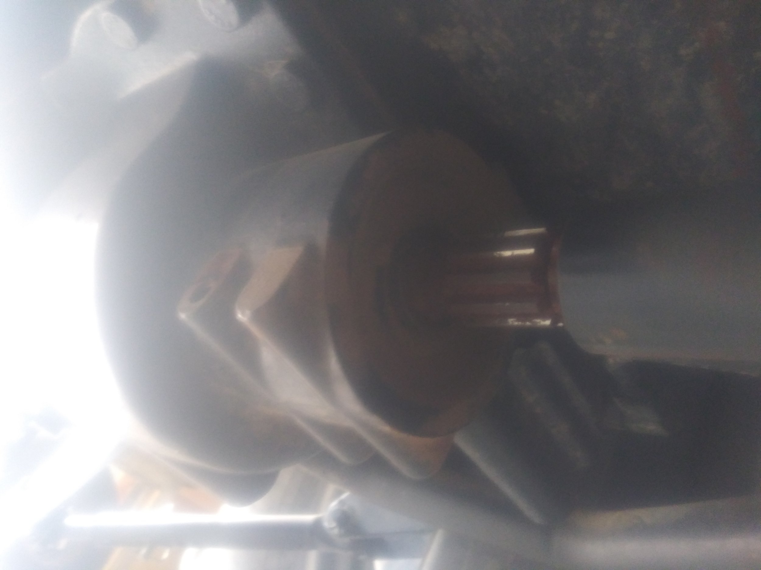

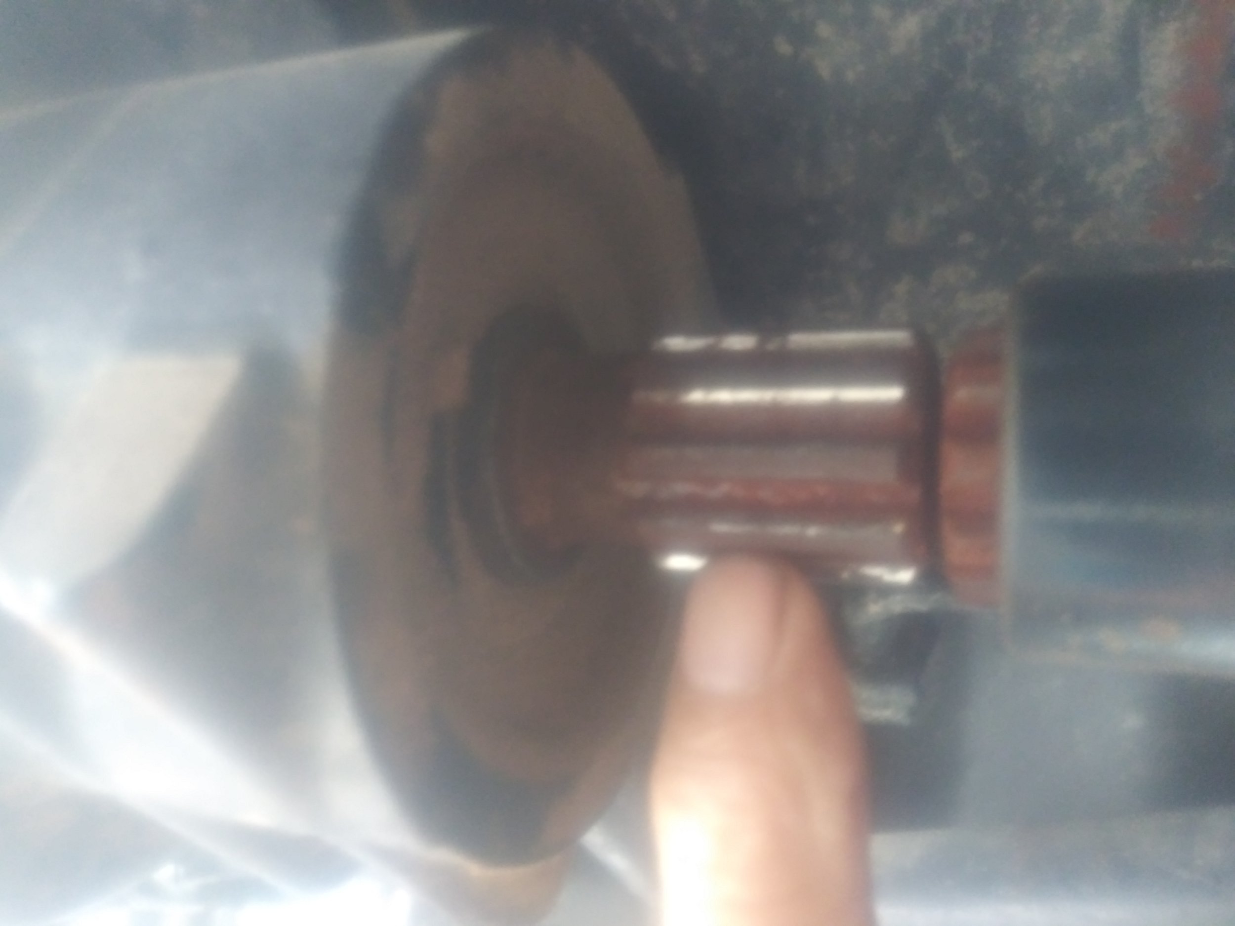

   / Electro hydraulic
Here are 3 pics of the shaft i am talking about it will turn about a guarter turn

   / Electro hydraulic #6
Is that the input shaft to the front axle?
Are you saying that when you release the brake pedals that you get a clunk in the front wheel drivetrain?
   / Electro hydraulic
No its at the other end at the control unit the one with the solinoid
   / Electro hydraulic
Do you have something similar
   / Electro hydraulic #9
Many 4wd tractors with electrically engaged 4wd will engage the front axle when the brakes are applied.
And yes i have a few tractors that do so.
